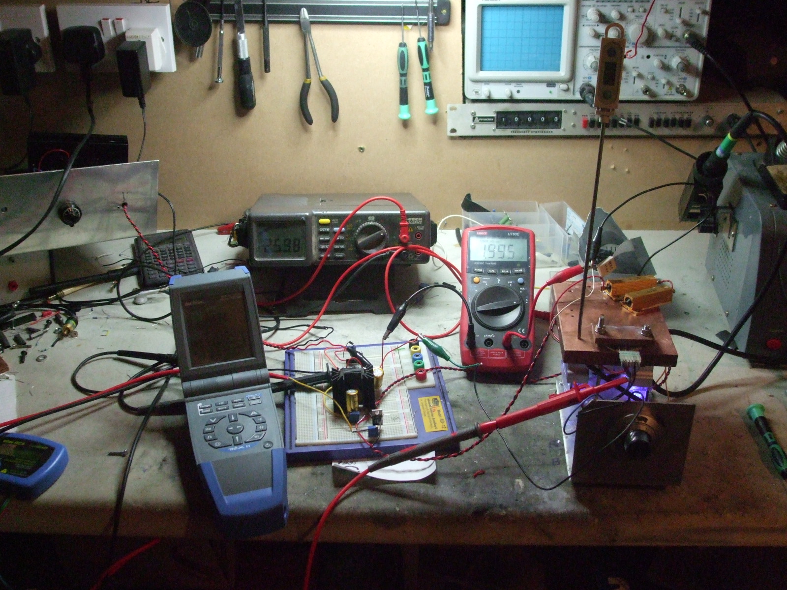

Not much progress with the build today
Every time I stop to play a couple of tracks I get carried away and end up pulling out quite a few albums.
The Mule has been playing now for a couple of weeks sound seems to have mellowed down a bit maybe just me getting use to it.

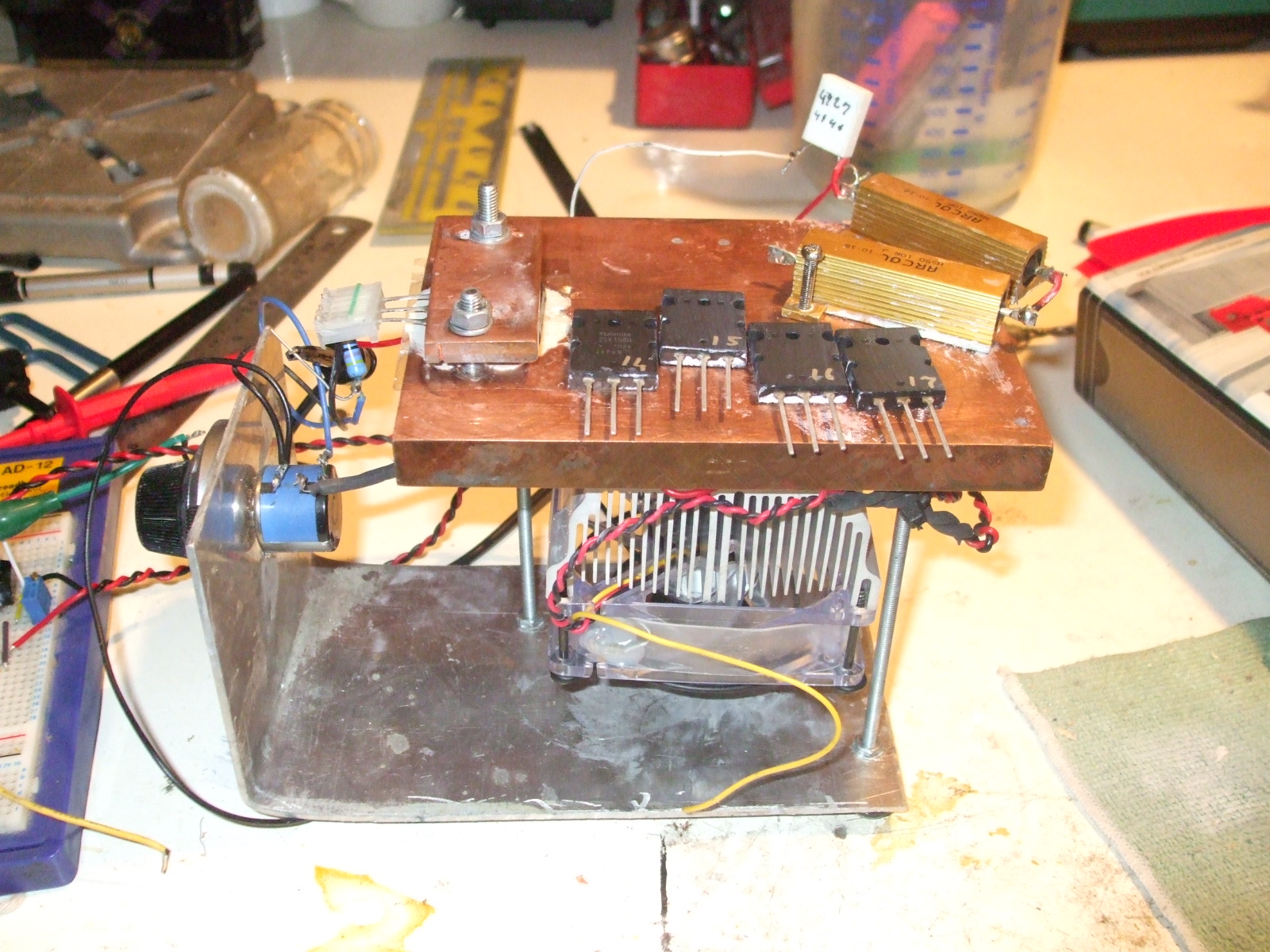

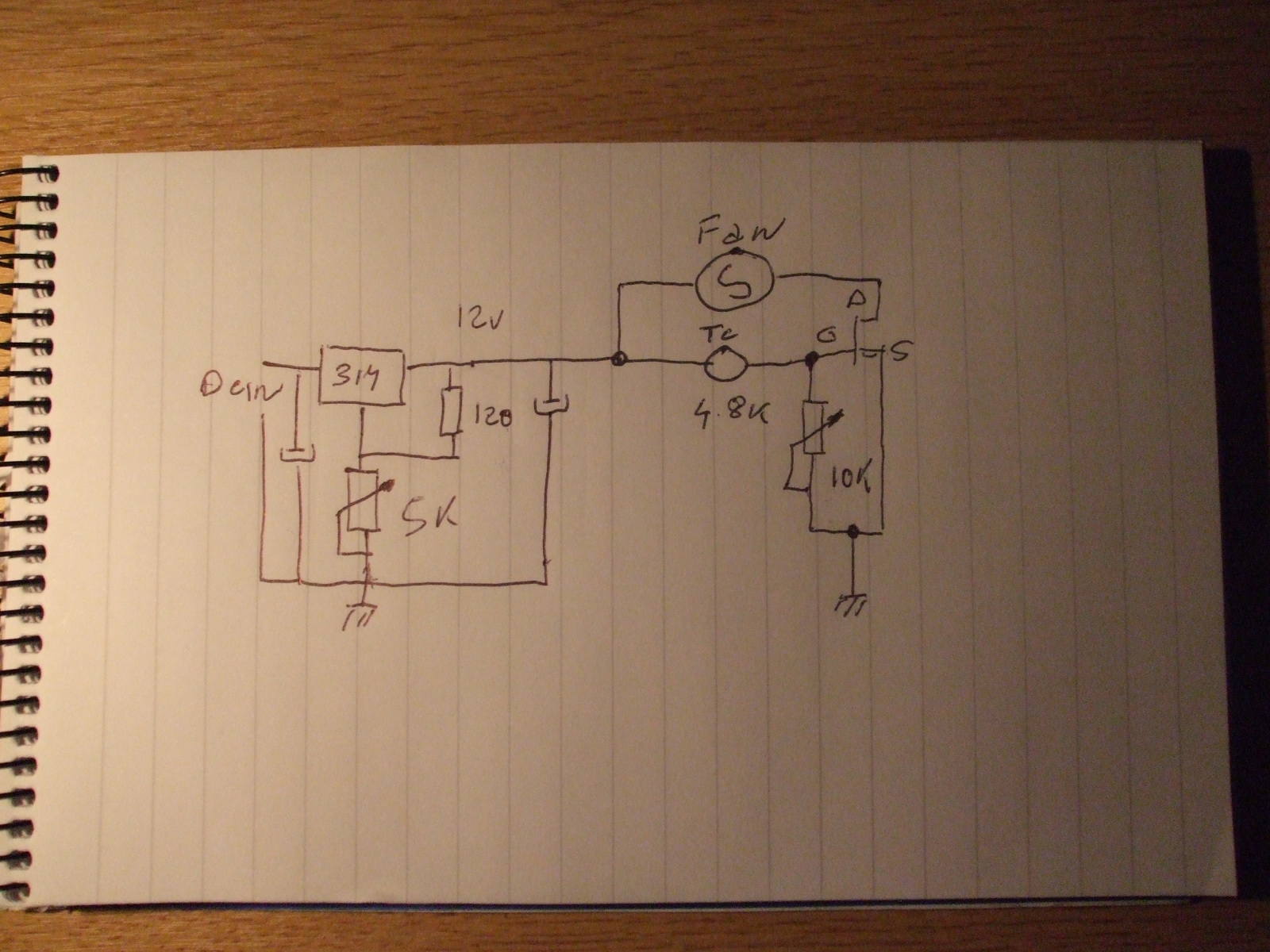

Time to start another round of mosfet testing
While I was doing this the firs time I have noticed that VGS changes quite a bit with the temperature.
I have made myself a little test rig and can get temperature stable with in + - 1 C
A simple 317 a spare mosfet and one of the 4K7 R thermistors + a few bits that may be in anybody bits stash.
May be handy as fan controller for same.

interesting, i may send you a message tomorrow. this lower vgs/higher gm at low temp is really quite interesting as an angle to gain better performance, interesting because you mainly see reference to devices needing to warm up to reach proper performance levels, where your results and mine indicate that a major factor in performance is actually considerably better at low temp. makes sense i guess what with super conductors performing at low temps, i wonder if its the same mechanism at work?
i think the fan+controller is very important, as otherwise the heat added by the dut will always impact on the temp of the sink, over and above the temp created by the heating element and without the fan to burn heat off in a controlled manner you will still be relying on environmental conditions, which are not so predictable.
Tanks QSP
Ditails of the test rig
A cpu heat sink and a piece of copper big pot in the front to set Gate voltagge
I got the thermistor in a small indent right under the Dut to get rid of a bit of time lag.
While I test one Dut the next ones are warming up on the plate noticed this saves time as well

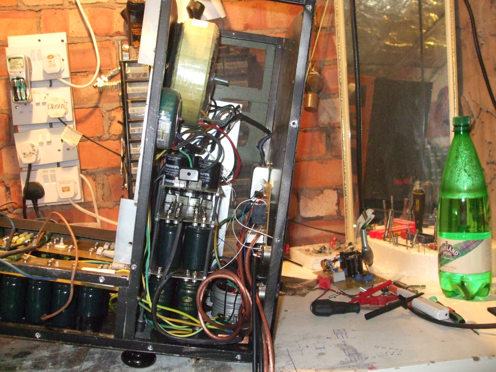

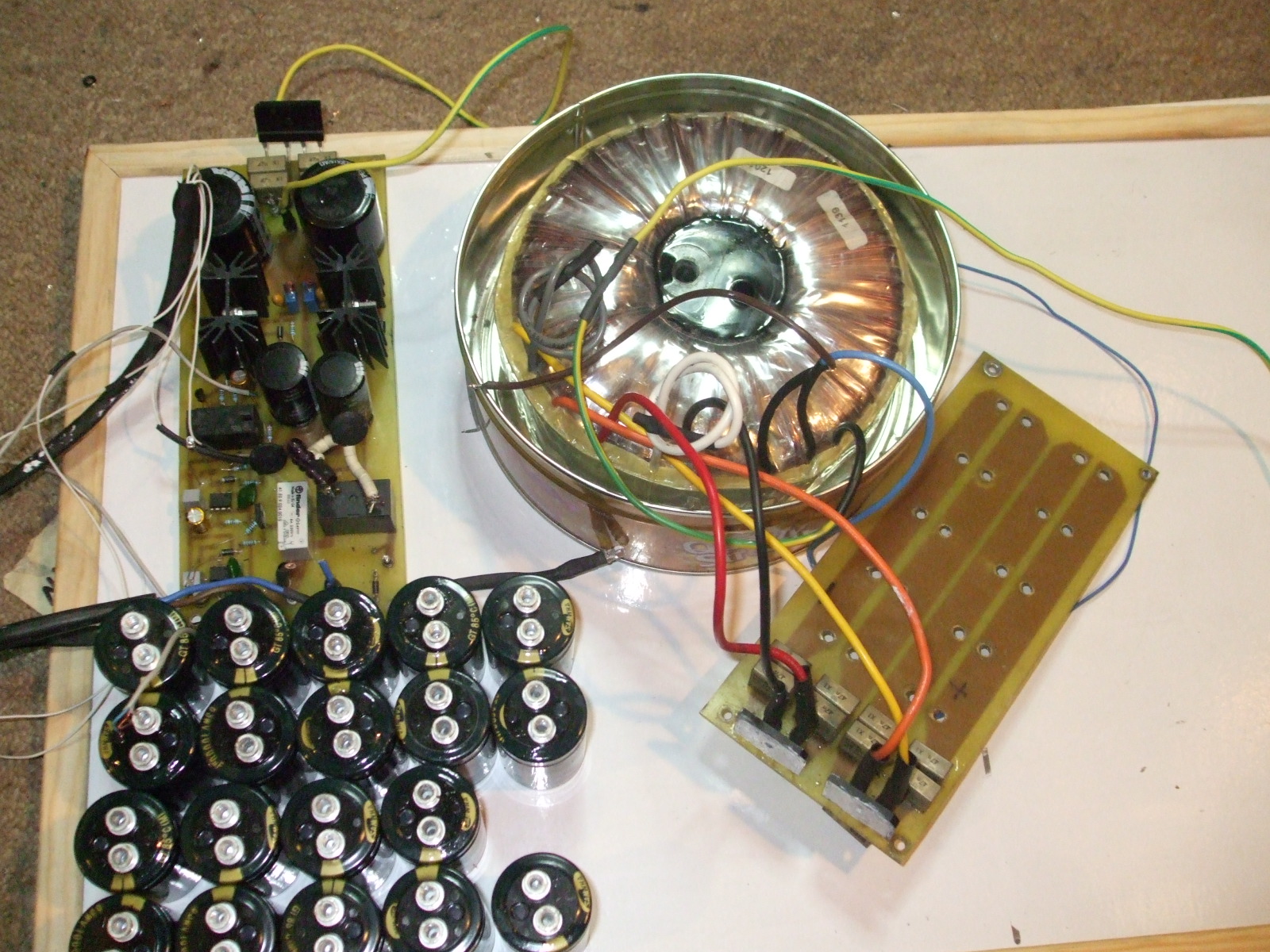

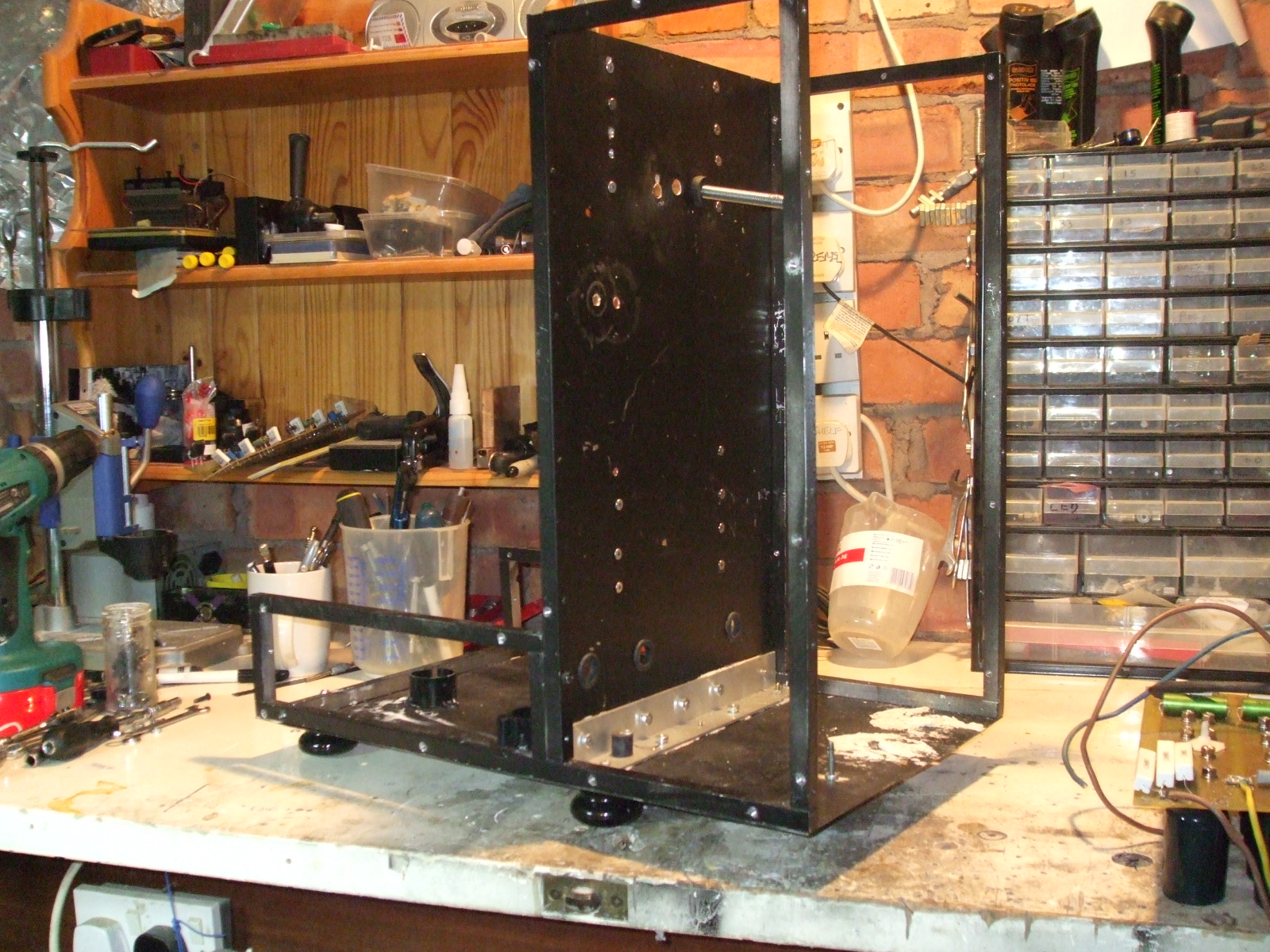

Ok long time since I have been here and time for update.
The Mule is no more I have been so impressed by the sound that it is time to invest same time and build something to make Papa proud.

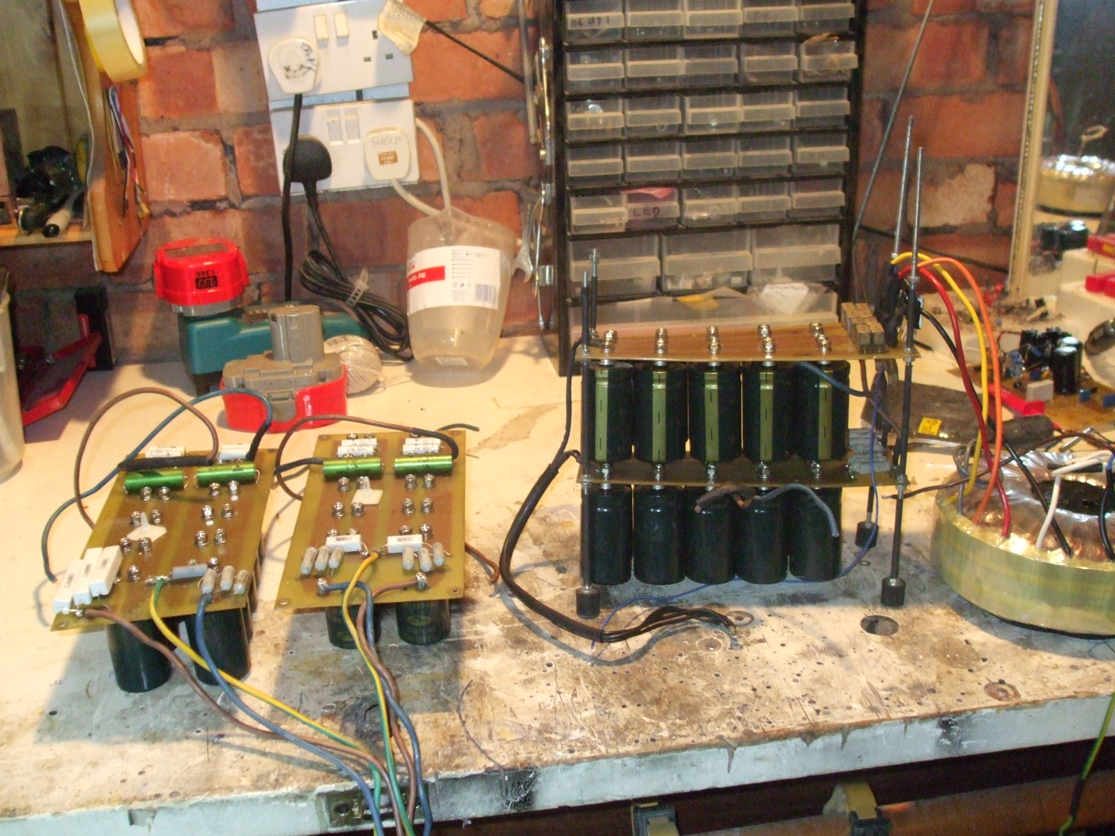

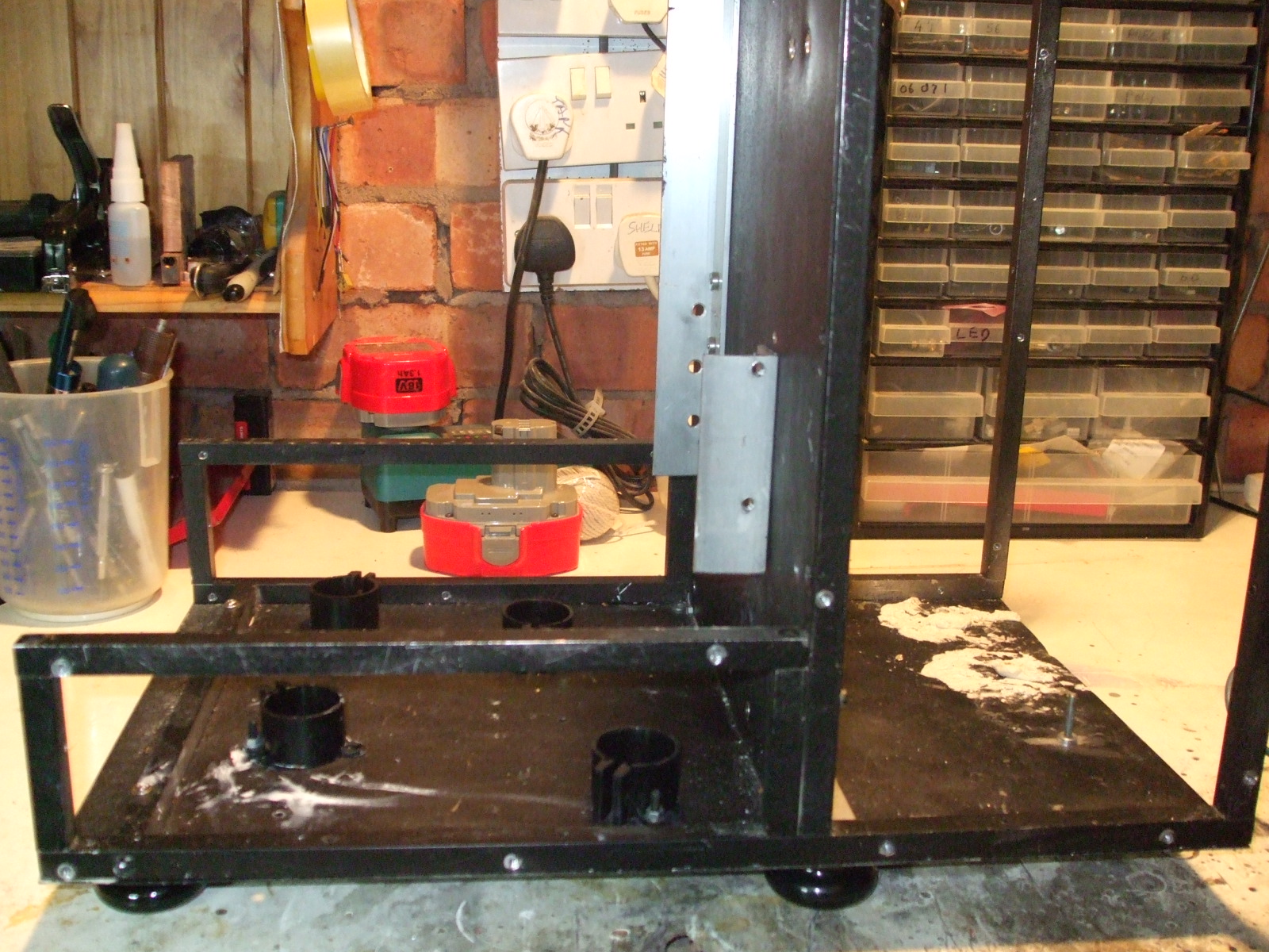

On the previous post a few pictures of the Mule.
I hope that there may be something useful there, as I would like this to be my little way to give something back.

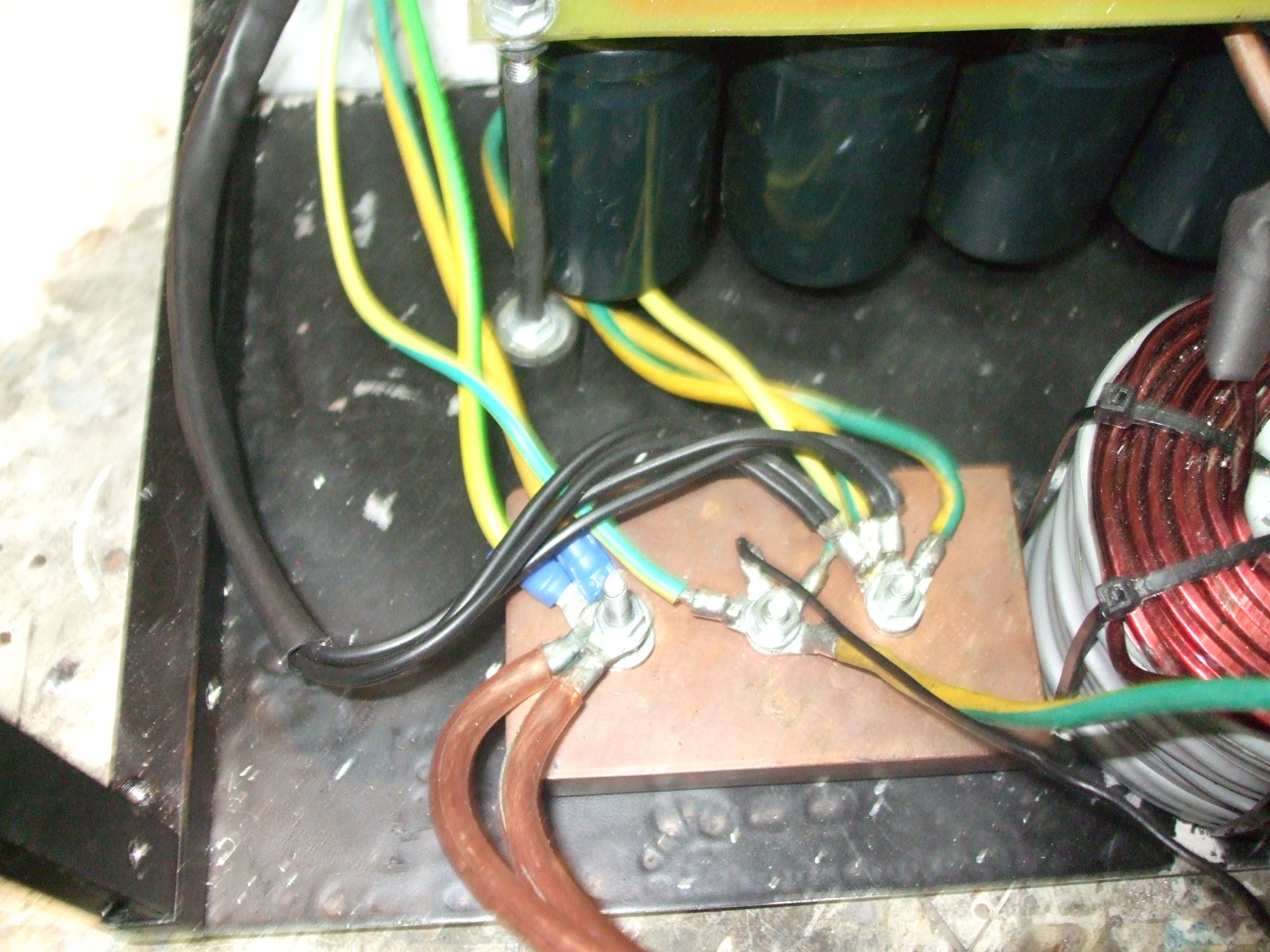

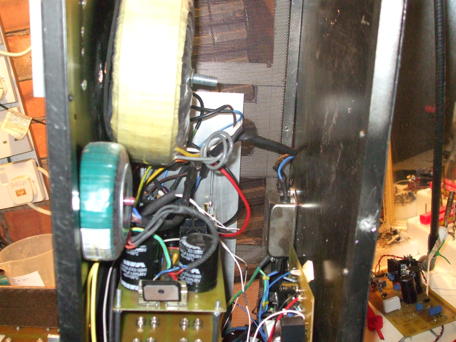

I have seen a few posts complaining about the Hum (mains noise on speakers).
I found this a bit strange, as I did not have any.
The main thing is using star or bus of star for the earth arrangement.
I did not connect the screen of the Input cable at any other place than the RCA Plugs on the Preamplifier and I was using over 15 Ft of cables from the pre.
The green Yellow cables (UK standard) are the ground
The 4 black ones the grounds of the first 2 capacitor banks.
Only one cable back to the mains and as the Pre has this connection as well that is more than enough to keep the input voltage from floating

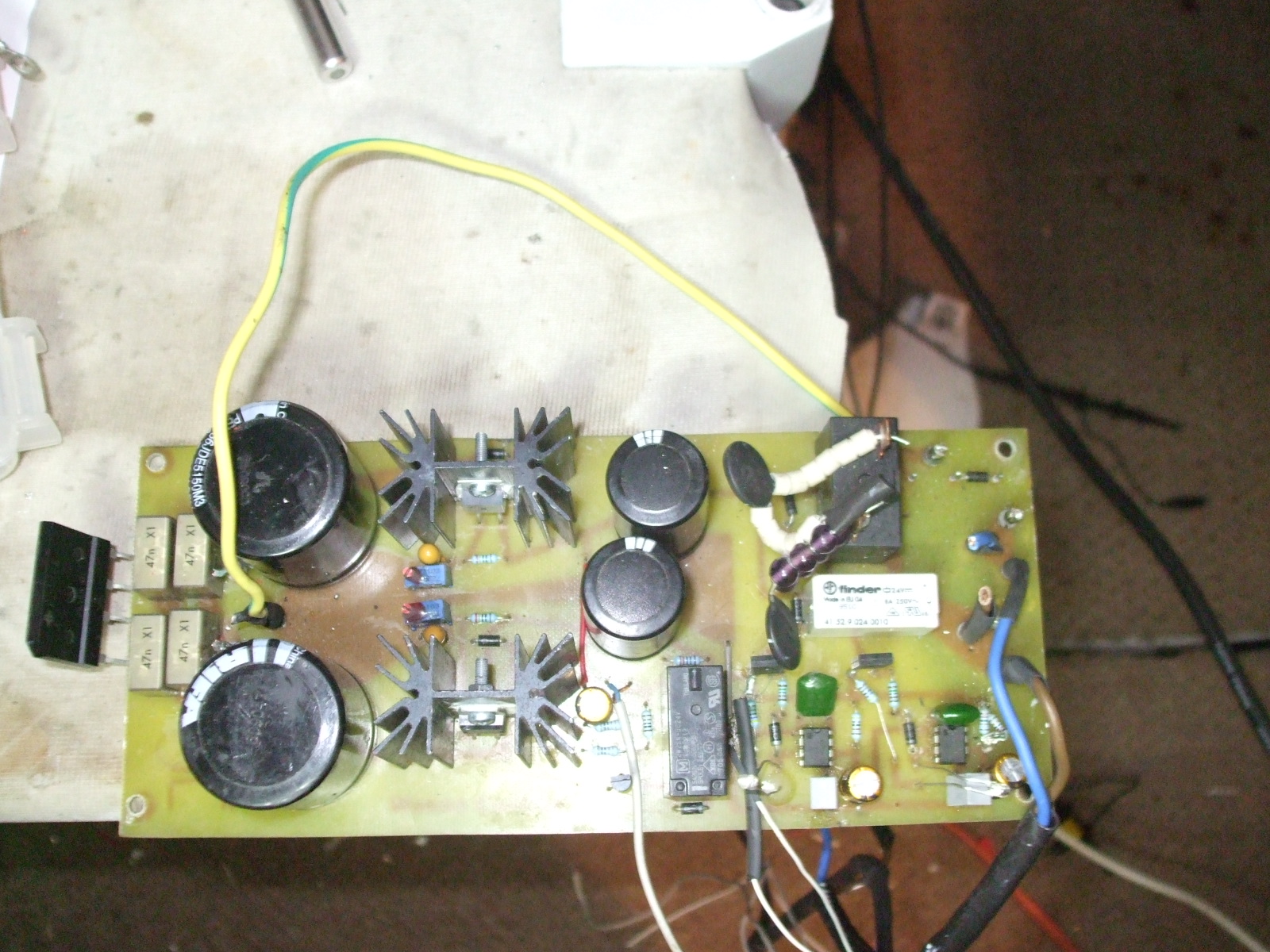

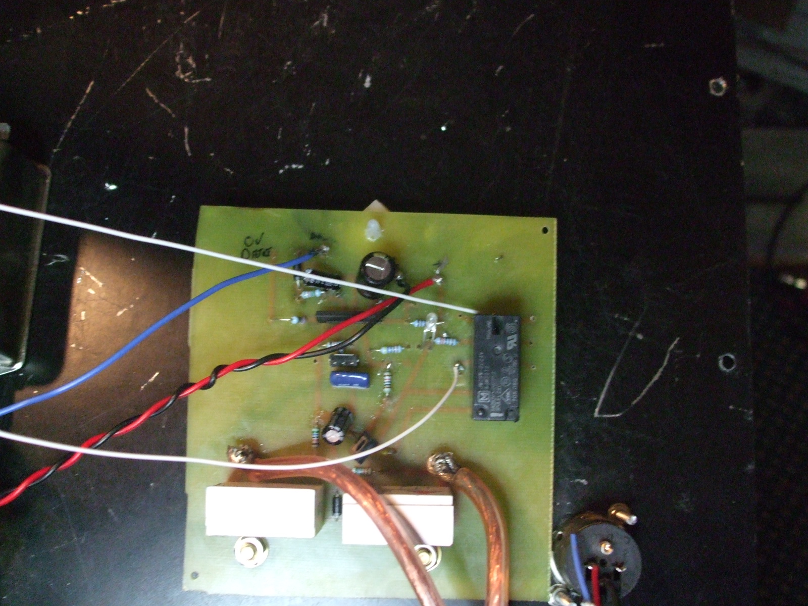

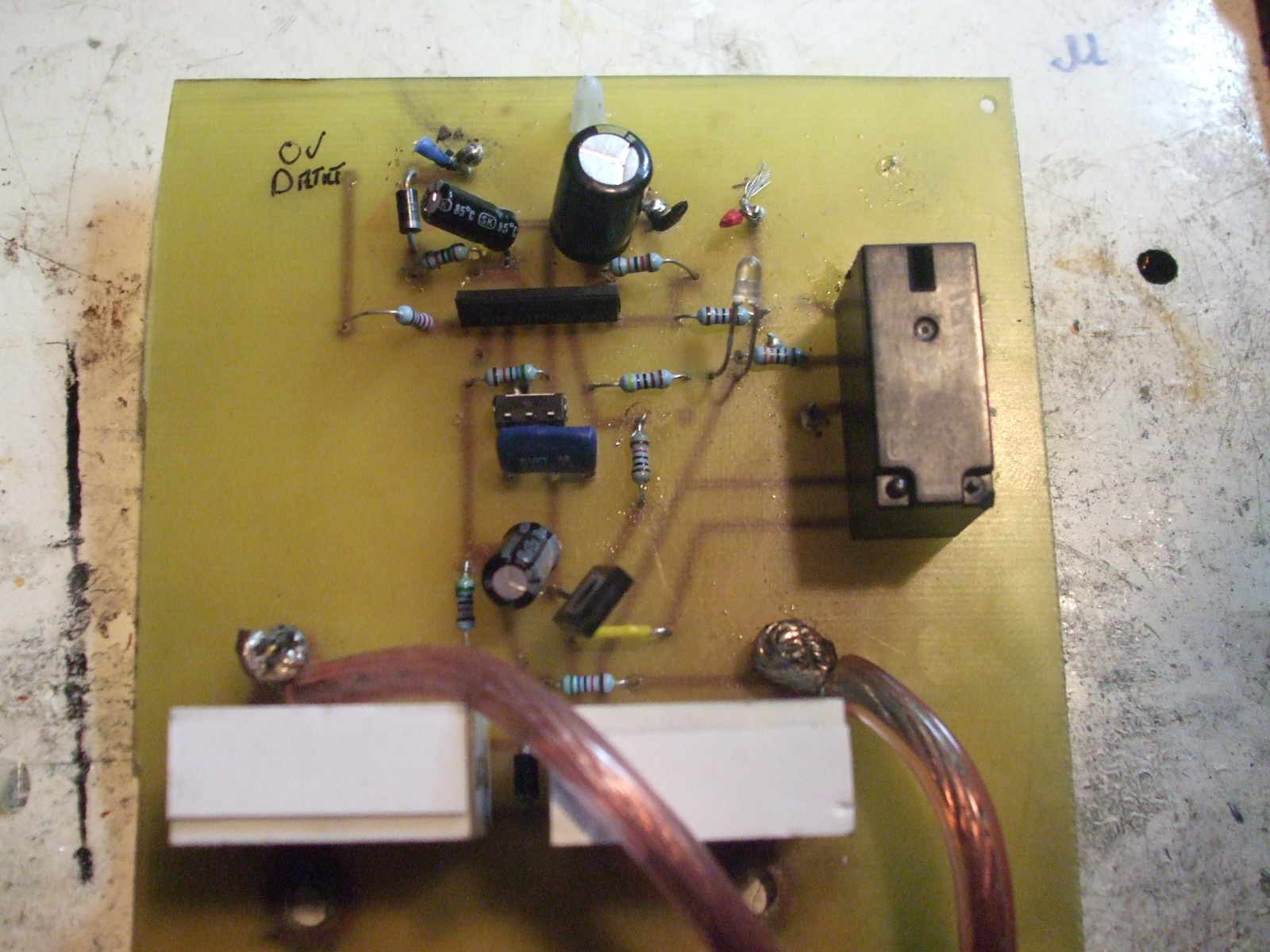

I did not use the current limiters as in Papa SCH and I am not planning to do so
But I had a speaker protection board that did work.
(While I was doing really silly things).
I am using the NTE7100 and Amplimo speaker protection Relays.
Those have 2 set of contacts and designed for this purpose
A tungsten contact closes first then a gold contact
On opening the Gold contact open first followed by the Tungsten
The Tungsten contact take care of the arching that inevitably effect DC contacts
The gold ones are there for beter sound.
I don't have any wish to sell those and if you know a similar or better relay for the job please let me know.
Normal relays are not good especially if they are AC rated, as DC is what you get on the protection circuit when it works
If you find commercial offerings with Ac relays you may have a problem.
I did not make a drawing of the circuit but went straight for the PCB as in the picture.
I will make a proper drawing and PCB lay out available to all as soon as I can.

As this was my first build of Papa amp I started up with same rather large transformers
1000 VA giving me the option to build something else eventually
Twin secondary at 0 20 24 V
Imo the mule did sound better with the hi voltage (24 AC) giving me rails at 32 V DC
I am using 40 X 10000 uF capacitors in CrCrC configurations with the last bank of capacitors split for the 2 channels.
The inrush current on the thermistors was pretty hi so I had 2 in series
Those are by passed by a relay after a few seconds from power up
Again pretty rough auxiliary supply and timing board
Proper drawing and PCB to follow.
I am using a simple 1 transistor circuit to power up and 555 as delay on timers for power on and soft start.
I would like a more elegant solution using just transistors which would alowd not to use 2 LM317 as 12 V is used just for the 555.
Could you give me any pointer?

For the Mule I have made myself the enclosure.
Really inexpensive and fit for the purpose
Nice piece of Granite for the front posh and mirror like shining and not IKEA (flat pack furniture that you can proudly say I screw it all together by myself)
I have used 1/2 x 1/2 Aluminium bar as skeleton and really cheap 1mm Aluminium sheet.
The 500X500 Aluminium sheet was about £5.50
The rest of the enclosure was made with play wood 3mm and aluminium mesh.
Super duper ventilation and still not hum
This will all be recycled on the next build.
I will go for a separate PSU case (Hi FI 2000) and 2 towers 150 X 300 X 500 WDH
The sinks are more than big enough to run at 32V 3A and temperature settles at 42 C
So maybe balanced at a bit less bias (I believe balanced gives an equivalent to 4 times the current of the normal equivalent)
Pictures of the old skeleton and probable new PSU lay out

Work is progressing in the mean time
PCB for new controll circuit getting a coat of tin at the moment then wil have to try out
the new thing just a couple of transistors to do the timing working fine on bread board.
And got my parcell from HI FI 2000 3U X 400 Pesante so the bridges keep cool and the boss told me that black anodised she likes better so once she get involved will be much easier to smugle the lot back in living room...
Please do not tell her that I got 2 of them as is next
As you mention the rattle.
And please help out here with suggestions
Still waiting for other traffo to came back as is gone for same extra varnish to make it quiter.
Apparently they tested the thing and said notting wrong with it and blamed my components.
So the lot got stripped down and I got totaly lost even forgot how to connect the transformer at one point.
No noise change whit wires wrong way around?????
Realy strange in it?
Any way it seems quiter whit slower bridges but one thing puzle me from looking at it and passing a magnet close by it sems that there is quite a bit of extra wire on one particuar spot and the flux is preaty strong there.
This is no good?
When I have asked for the traffos I did say I wanted the best they could make which probably it is (no naming them at moment to give them chance to put things right).
Also quick try to caps with 30 X 10mU was no fun and meter just get out of range
they all seems ok no shorths as all discharging about same rate.
One thing I could not test ESR (not that I am espetting much out of Samwa caps)
but I think I have seen somewhere that if ESR is poor it could cause trafos noise?
And tried DC stopper diode bridge and 2 X12mUback to back (total 4 caps) 6.8V
no change
so help please hum is purely meccanical no noise at all out of speakers till the needle drop on the groove
1)dogy components causing hum even at 3A current (this is 3A in each winding as otherwise F5 will not ofset to zero DC is this right?) trafo 1000 VA so should be good for 20A
2)poor trafo construction or trafo builder do not understand "I am making super duper class A amplifier and would like the best you can make" (drop suplier name somewhere so no more maney wasting from diy brothers)
3) I am to fussy and litle mech noise is just normal any traffo would do that.
1000VA humming at 3A do not think so.
Get same serious money to get reputable brand Traffo which may make same noise becose I am to fussy or spend a bit more and get reputable brand to make a R core?
So the more I think about it the more lost I get help please.

you could try these tx vibration washers
which doesnt stop the vibration, but they work reasonably well to damp it. probably you can get something else similar, or design your case with some form of damping washer on the mounting for the tx.
obviously its better if they just dont vibrate, i have found sumR toroids i have dont.
i do wonder what the tin is for though, its probably amplifying the noise due to resonance and it certainly wont be doing anything at all to shield the transformer
Tanks Qusp and Zen
1) Tin is useful for setting up things
2) And same function as enclosed tinned trafos for free.
3) And it looks pretty and excuse getting more Jummies.
Load of washer’s there thing is Zen hit the nail I think
As this was more an experiment (My first Papa Amp) Trafos where more Than half price than SumR + got 2 taps at 20 and 24 V to play with so SumR will be out.
They will be handy for next experiment and bench supply + got Wakoo idea to use same Thermally conductive potting silicone if the one due back if still noisy after moods.
Maybe and more difficult to judge is option 3 me being too fussy.
Still one learn by mistakes and once I have decided how hard I need to push the mosfets
(Got choice between 26 and 32 V dc at present) Proper traffo it will be F5 to good and quiet to spoil things for the sake of a few quids.
Questions
Any one in UK able to build a traffo to compete with SumR?
Race core will be beter but who’s make them?
