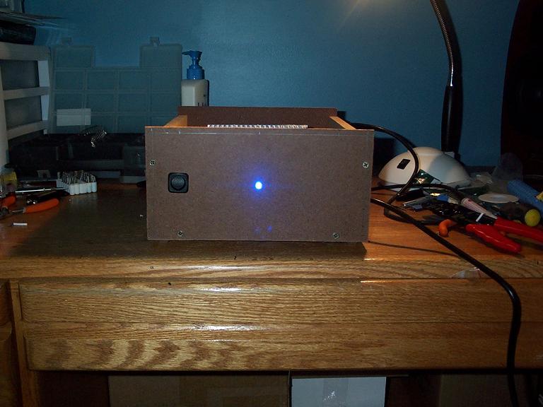

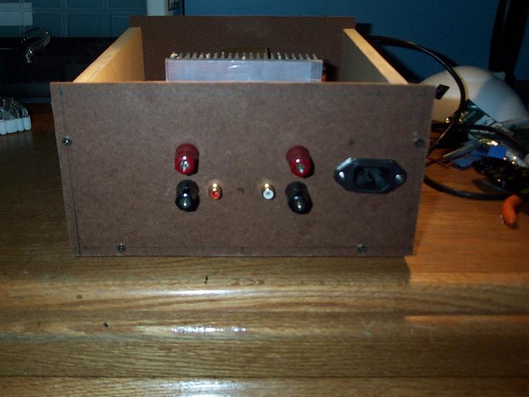

I have my first "official" ref amp built. :)
Here it is.. some pics first...
The case is temporary until my parmetal case gets here. But it is quite functional, just ugly, well to look at anyway. It sounds as good as I hoped. :)

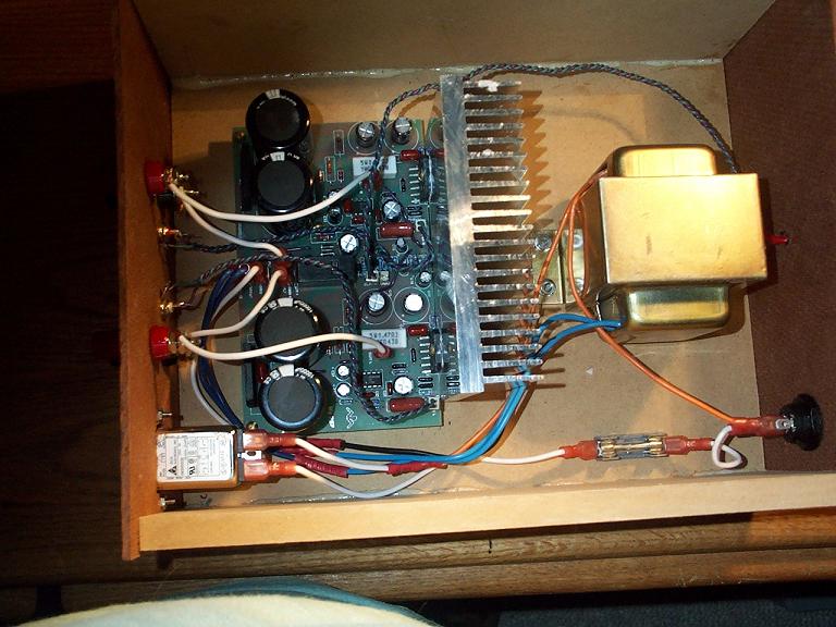

Excellent job! Congratulations!
Does it sound better than the first version?
Some questions on your assembly:
1) You seem to have soldered the LM318 directly on the pcb, with no sockets? No intention on trying different chips there?
2) What resistors did you use? They look like Holco.
3) How do you hold the pcb on the chip side? No stand-offs on that side?
Carlos

Hi Carlos,
This is a "Revision A" amp. I say it is my first official one because the other one I built did not use all the smae values as Mauro did, and It was built on my own PCB (which was not great quality). This one is much better in every regard including sound.
I will now answer your questions:
1) I did directly solder the op amp as I prefer this to adding the inductance of the socket legs (especially as it seems to adversely effect the byapass caps). If I want to change it I will simply desolder. :) Mauro has warned me against other opamps for this circuit as it is designed specifically to attributes which seem to be unique to the LM318. But DIY is all about risk taking right? ;) So who knows, maybe soon. :)
2) Resistors are KOA Spear, IRC, and Vishay-Dale, as well as Yageo.
3 The PCB is held by two standoffs in front, one towrad the center, and then it is fastened to the heatink. No other support. None other needed it is quite solid.
I am still forming my impressions of the amp, but I can tell you it has been a very pleasant evening so far. :):cool:

OK, one small oncern I have. The amp runs hotter than any of the chipamps I own(which are legion) but, I can't hear any sign of ocillation(ringing and such). I don't have acces to a scope for a couple of weeks. :( So I am left guessing if it is really oscillating or not.
It is not terriblly hot, but I wonder if may be oscillating anyway,as it does not cool down even when I leave it idle for 20 minutes or so. The heatsink stays a pretty constant temp (about 56C).
I wonder if adding a zoble on the output terminals might help...
It may be oscillatin. Mine is only getting mildly warm. Maybe you shoudl put some holes under your heatsink, or better yet, cut out a small rectangle under and over it to allow the air to flow.
Mine did run warmer when I first started listening to it then got cooler (only 1-2 hours of use). It was never hot though. My BrianGT 4780s get quiet warm, however, even with a Zobel. Fairly sure they are oscillation. I need to buy a scope.
Yep, already have vent slot over and under the sink. Maybe I should not call it "hot" just warmer than I am used to.
I have both parallel(Brians) and stereo(my own) 4780s and they run pretty cool, cooler than this.
Ok, I think I may be onto the problem(well I now I think I may not have one) I turned off the amp 15 minutes ago. And the heatsink is still pretty warm. I think the difference is the type of case I built.
I usually (on my previous chipamps) put the heatsink with the entire length of the fins exposed to the outside air. With this amp only convection makes the air move inside the case, so much less fresh air gets through the case.
I any case I have been listening for 8+ hours and its still singing "mighty pretty." So I don't think its a big deal. I hope :xfingers::xeye:
