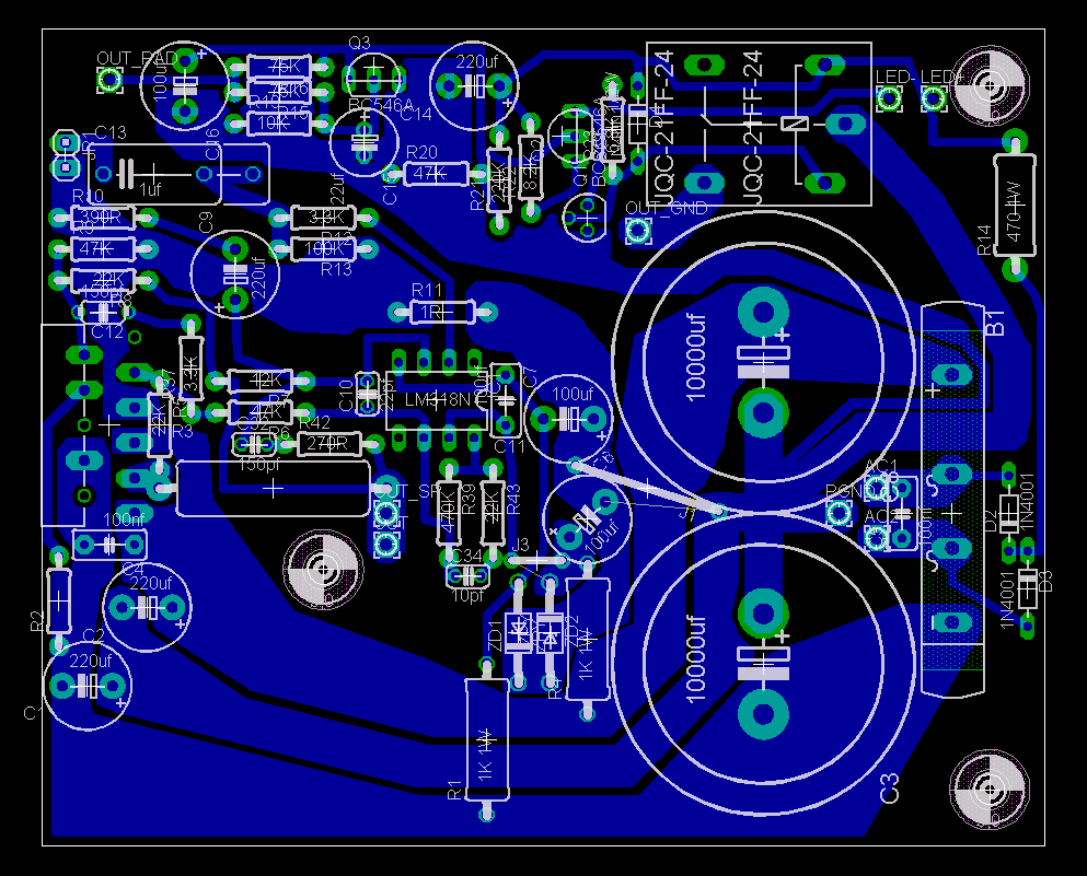

CONN3 = "output ready led " (Rdummy =R23) announce the normal conditions of operation.
CONN2= Power ON Led (external add Rdummy) or auxiliary (low load) fan.
The Voltage on CONN2 during the normal operation (relay ON) has to be among 16 to 24Vdc. If is to low means that the relay absorbs + current, and you be worthwhile decrease the R14 value in proportional way...

Thanks for the conn 2 & 3. It seems you thought of everything. I will make plans for "status" lights.
I see in another forum: http://www.diyaudio.com/forums/showthread.php?s=&threadid=60546
Graham and DestroyerX speak at length about twisted vs. non-twisted wire pairs. Can you tell us how sensitive this amp may be to this? I note your depiction shows the wires untwisted.

Hi bg40403 , I have lost the thread of the conversation among Graham and Carlos. It seems me that they have spoken of "twist" in connection with the connection of BJT, and is not a problem that concerns this circuit. I suggestion to put the transformer on the side of the diodes and "twisted" the wires that go from the trafo to the card, and however reduce to the maximum this connection, because in those thread there are very strong interferences on account of the impulsive current of the diodes. Other connections are able behaviour as has done Russ...
Ciao
mauro
Ahh.. let me see if I understand you Mauro.
You say the trafo could be one the rectifier side and not the heatsink side?
I can easily modify it to be that way, but then the signal wires get longer, and they run closer to the trafo, which I though was bad...

Hi Russ,
You are starting to understand the meaning of "virtual ground " and " good PCB layout ".
you are able weave the wire of the trafo and hold them far from the card. Or you turns the card with the headsink toward the connectors and passes with the cables over of it ( if you have space ).
When they connect an oscilloscope are able see if there are signals of trouble and when change if moves the trafo wires...
If its S/N satisfies you are able leave all as it is. ( remembered the Brian suggestion, you do some hole under and over the box for the heat...)

Re: Re: Re: Re: I have my first "official" ref amp built.
I have only been making my own PCBs for a little more than a month. The PCB I used for my first prototype was one of the first I ever etched, so there was some pitting and such. Plus at the time I only had 1oz copper laminate which is really insufficient for the task.
The board worked fine, the biggest problem was that I did not have the exact resistor values for the output resistor(I used .3R instead or .47R) which effected everything in the feedback loop...
The board was etched using Mauro's layout, not my own.
I will be etching some of my own monobloc "REV C" boards as soon as I feel confident the layout is good enough.
Any input in that regard is appreciated as I am itching to get that going.

Just to check we are talking of the same version: this is Mauro's Revision C, right?
About the pcb's copper: what was the problem with the laminate? What are you using now?
Only now did I check that the output resistor was a 7w type, and that you used a 5W wirewound type.
One suggestion I would have is trying to put two 3-watt 1-ohm metal oxide types there. They are non-inductive and usually better sounding.
But I think (please, Mauro, correct me if I am wrong) that that .33 resistor was not such a big problem for the feedback.
Good thinking for the center stand-off. I had not seen it on the previous layout. As the stereo board holds two middle-screws, it should be quite solid. But extra stand-offs on the "heatsink corners" might be good.

The problem with the 1oz laminate was simply that it was too thin(the copper).
Yes we are talking about Mauro's "Revision C" schematic. It is what I have designed this layout to implement.
Mauro has indicated(indeed it it is what is in my working amp) that 5W output resistor is adequate.
I am open to trying the 2 x 1R 3W metal oxide approach.
I would be inclined to say that the .33R resistors did indeed make an audible difference. My initial prototype (which is scrapped now) sounded overly bright and harsh. I am not absolutely sure if the output resistor was the only reason however.

Hi all,
The res. 5W "cement" wire have a low L, and bear peaks of current with about tens of Amp. The metal oxide res. are good quality but am not strong as the wire. I suggestion The 5W-7W "cement" wire.
The res. 0.33 creates a Zout of the current pump bridge of -20% in comparison with 0.47. Then it moves of 20% even the gain margin, the damping factor etc.... I prefer recommend the values that have given me good resulted on my bench...
