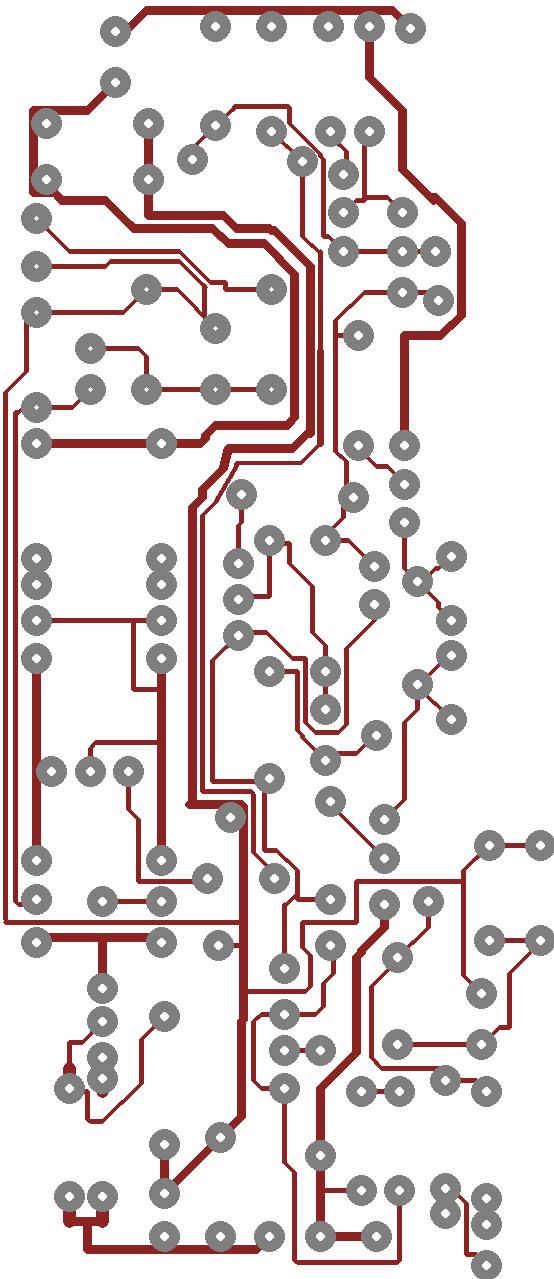

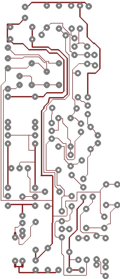

I am not using KiCad although that would have been better than what I achieved. I used a humble Linux program, pcb-gtk, to directly draw the tracks and connection disks. I used vias for the latter, although I may be wrong. PCB making these days, seem to be very biased towards SMD making, and I, being over fifty years now, shudder to only think about SMD devices so small, that even with good reading glasses, one cannot make what a component is, let alone handle.It sounds like you are having fun I'm afraid I've never used KiCad but I look forward to seeing how it all takes shape and turns out.
I am posting an image of the PCB although it needs checking. It is very easy to make mistakes, I am too human, not to make them.
The current flowing in these tracks will be at most a few milliamps, at most 20mA for power tracks. The power stage and power supply are not shown: those are already done with heavy duty tracksOne thing I would say would be to make the traces much (very very much) thicker.
I know from experience just how small and thin the tracks can end up and that makes them fragile and prone to issues. I always try and put as much copper down as is reasonable and leave the fine print to where it is an essential such as passing between pads.

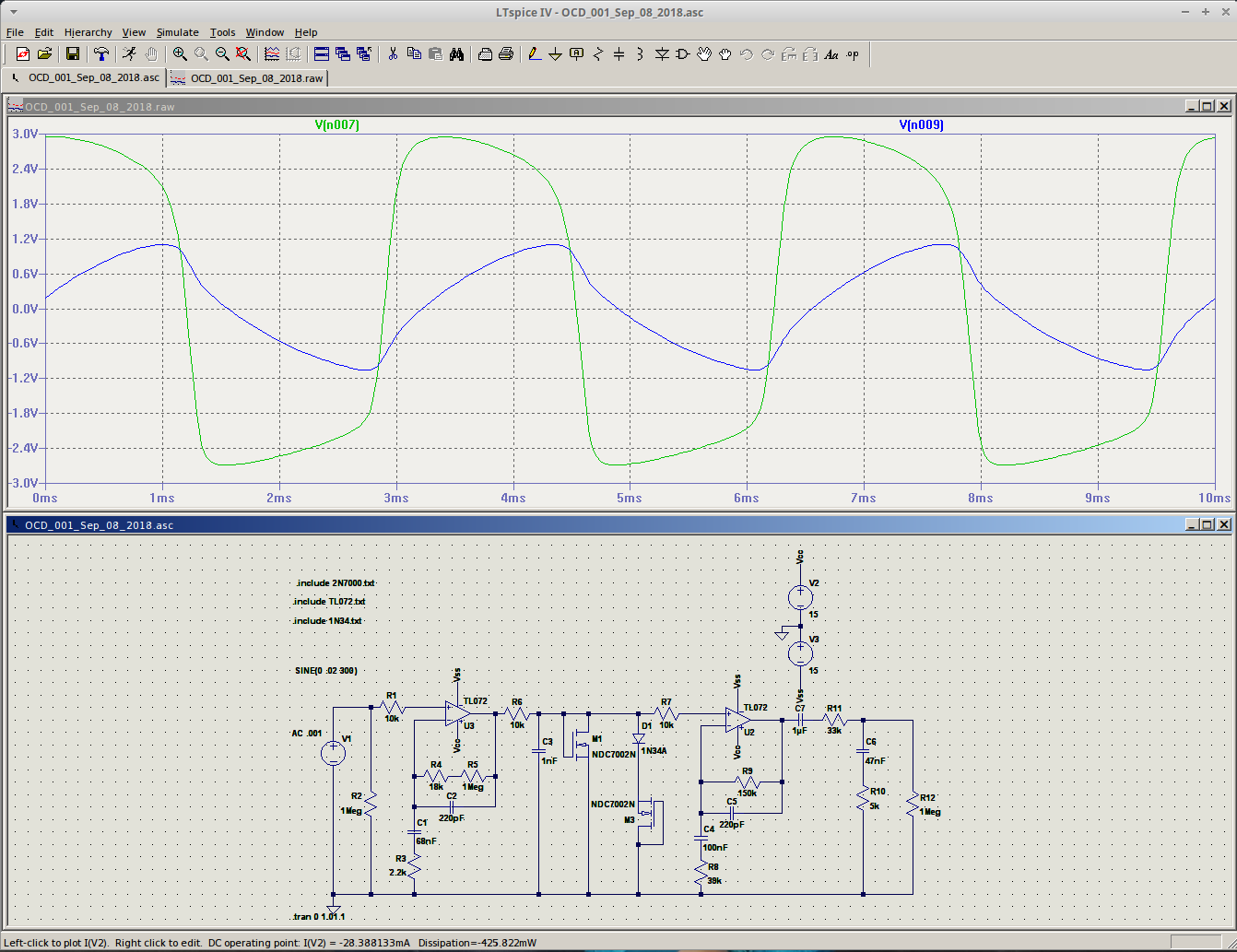

Devuan is based off Debian with an older init system. I've run LTSpice on Wine in several different Debian-based Linux flavors for the last several years, with pretty much zero fuss and drama. Unless the Devuan developers really screwed things up, I doubt you will have any problems to deal with.I am on Linux, Devuan ASCII. Installing more software means more time dedicated to setup software that I have never used in my life.
For the last few years I've been using Xubuntu (also Debian based.) sudo apt-get install wine, download the LTSpice Windows .exe file from Linear, right click the .exe file in your file manager of choice and open with Wine, follow the prompts, and you are done.
It does take time to learn LTSpice, but it will save you from so many circuit design dead-ends and mistakes that it will soon be more than worth it.
Here's a screenshot of LTSpice running happily on Xubuntu 16.04.3. No bonus points if you recognize the circuit.
-Gnobuddy
Clearly, you did not read the thread as this issue regarding LTSpice has been settled several weeks ago. Using sarcasm as a means of control or persuation is a well known manipulation technique: I refuse to be manipulated.Devuan is based off Debian with an older init system. I've run LTSpice on Wine in several different Debian-based Linux flavors for the last several years, with pretty much zero fuss and drama. Unless the Devuan developers really screwed things up, I doubt you will have any problems to deal with.
