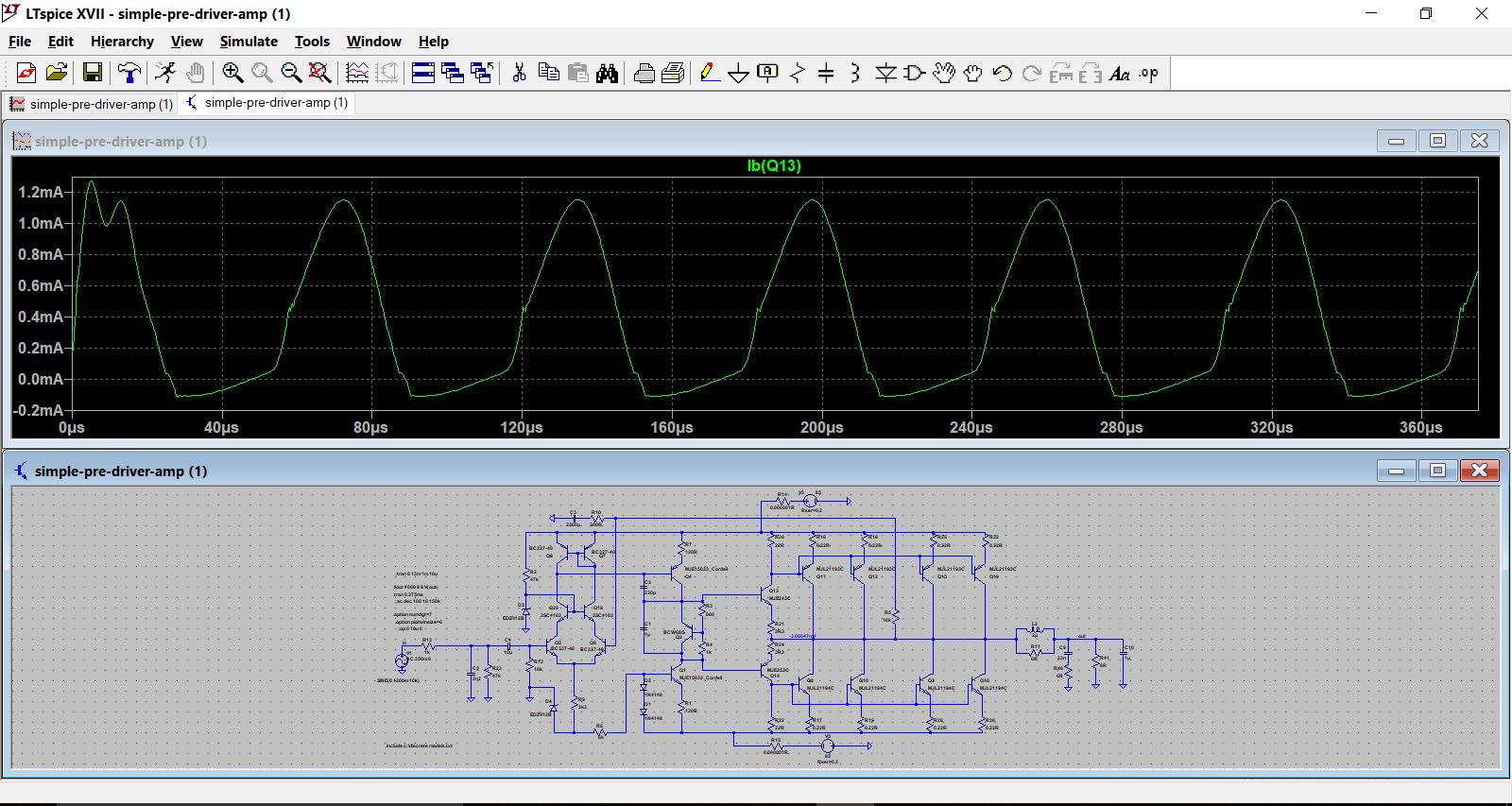

Although, I have designed several variants of the same amplifier with good distortion figures, this particular circuit seems to offer what other similar circuits did not offer: it has a distortion below 0.06% and a very low DC offset voltage at the output. This uses a high voltage cascoded input stage to allow the use of low voltage input transistors and provide high voltage isolation from the input. A cascode also provides other advantages from an electronics point of view with a higher input inpedance and a drastic reduction of the Miller effect since Vce is esssentially constant on the input transistors.
Hi all, back on topic, please.
The output waveform looks good but a deeper investigation shows underlying problems that must first be addressed. Ib(Q13), LTSpice notation, has a strong ringing component at both ends of crossover. Zooming on the ringing shows typical damped sine oscillations at a supersonic frequency. Physics state that is is simple harmonic motion which requires a specific mechanism to occur. In mechanics such a mechanism, is a force that is proportional to displacement from a fixed point but always pointing to that fixed point. In electronics, one must have two mechanisms that mutually exchange energy. A series LCR circuit is such a circuit. But where is such a ghost circuit in the VAS stage of this amplifier? Yes, there is Cbc, the base-collector NON-LINEAR capacitance, that can store energy, but what is the invisible 'spirit' that mutually exchanges energy with Cbc?
Unless, I understand the underlying mechanism, I am afraid, groping in pitch dark with LTSpice is of very little use. I am tempted to attribute this ghost mechanism to other less known parasitics which may behave like an inductance. I am also assuming LTSpice has no knowledge to calculate parasitic inductances as these depend on the circuit assembly.

I found that increasing the VAS's standing current, quiescent current?', greatly attenuates the ringing, but a VAS with several tens of milliamperes is more unnecessary stress on the VAS's transistors.
Post Scriptum:

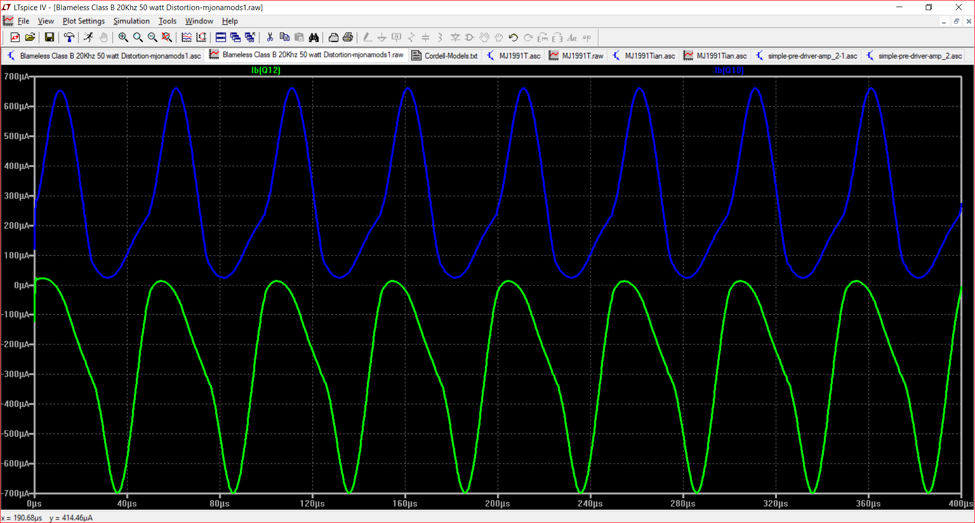

so I tried this on Doug Selfs blameless class B and that to behaves the same as yours. I'm wondering if this is an effect that can be partly blamed on the models used. Substituting your drivers for MJE243 and MJE253 and also changing the outputs to MJL21194 and MJL21193 seems to resolve the issue. Bias at 30ma per pair.
It seems I need to boost my understanding more with more reading. This journey is a learning adventure of someone who is well past his schooling years. Douglas Self says that these ghost oscillations are not yet fully understood and that they are the result of the VAS stage being seen as inductive by the driver stage.
The solution seems to be using a higher, 47mA, bias current for the output. This, unfortunately, is per output transistor, which means, a total of 160mA will be wasted continuously. I think, I have to be contented with reality, as this power stage is a large one, and one cannot feed giants on bread crumbs! If I remember correctly, Class AB use higher bias currents to force both NPN and PNP transistor to turn off a short while after crossover is reached. This unattractive energy waste should give better performance benefits: we will see.

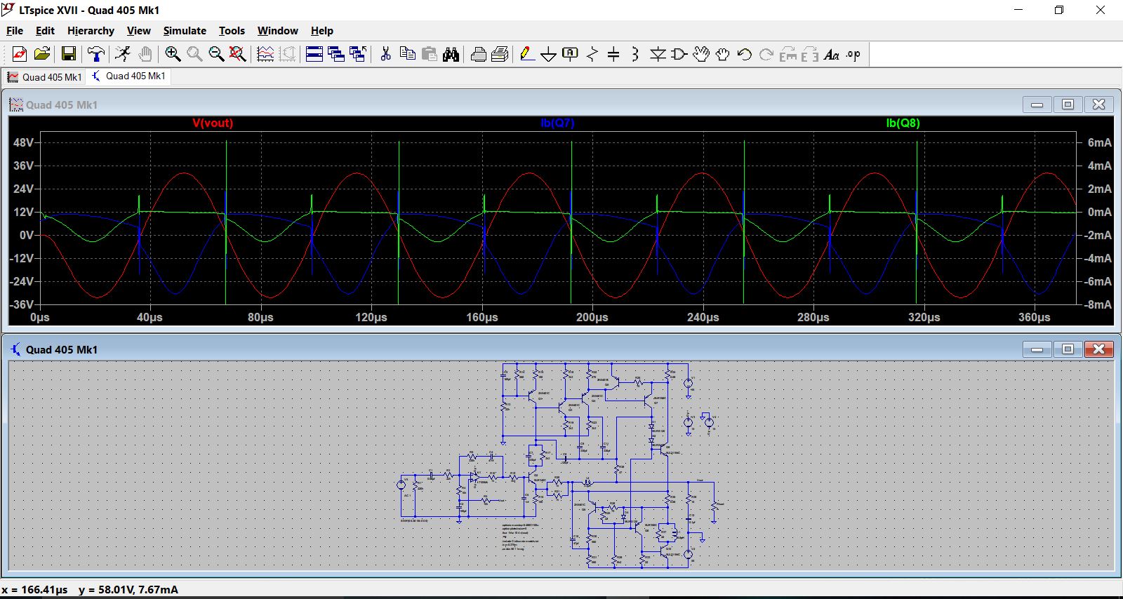

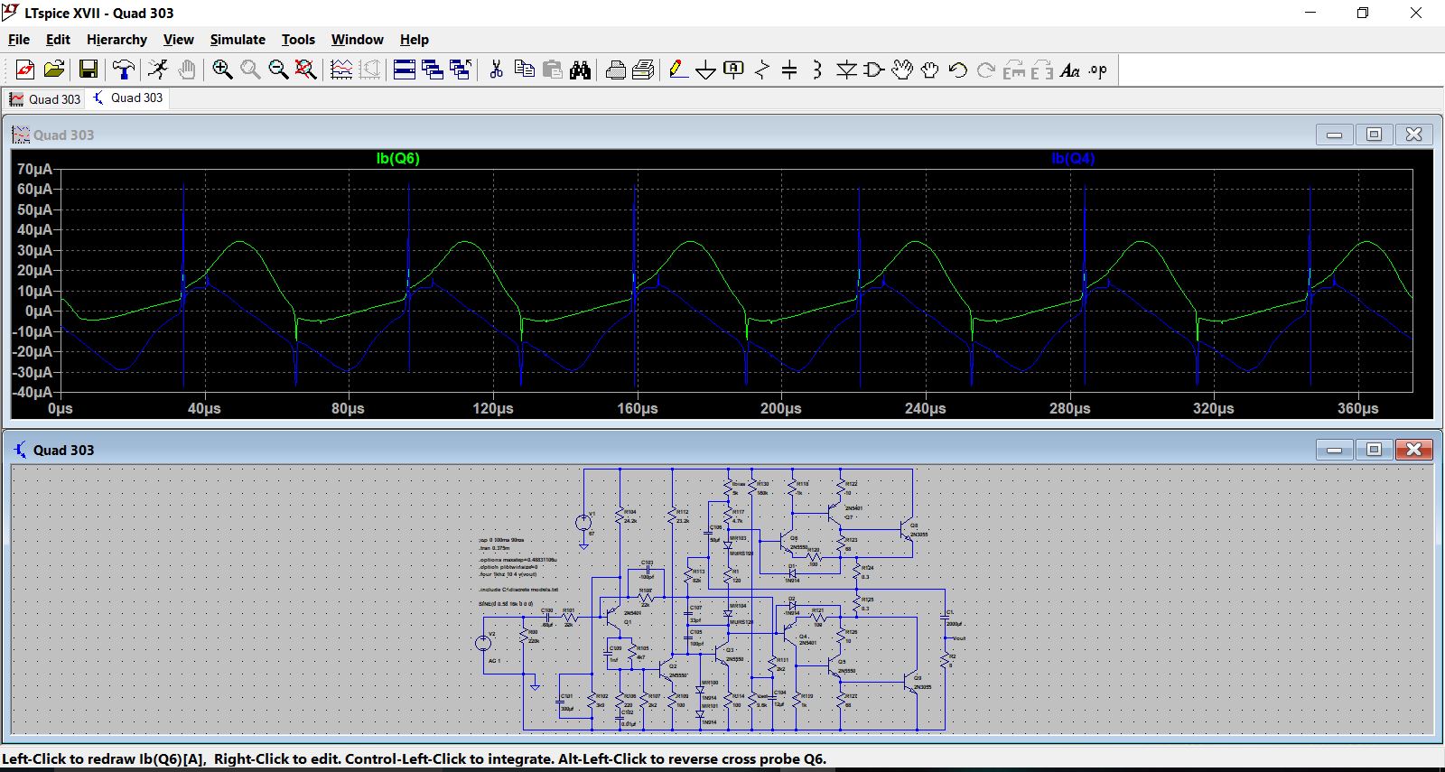

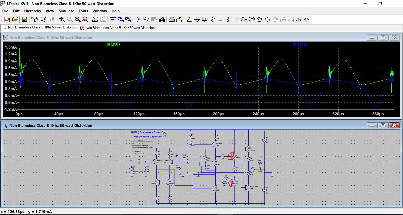

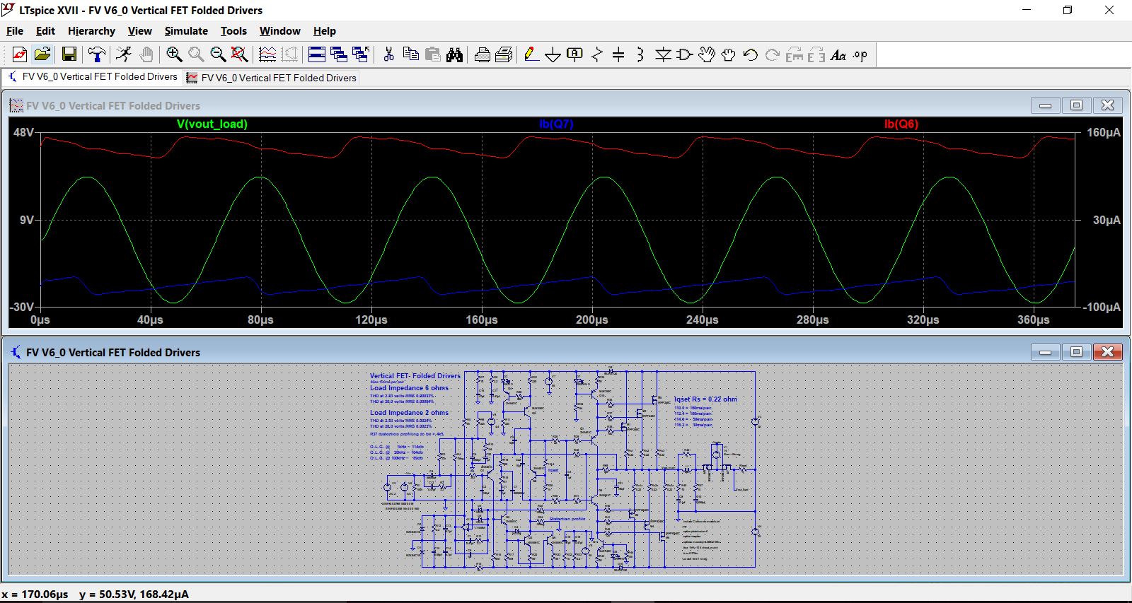

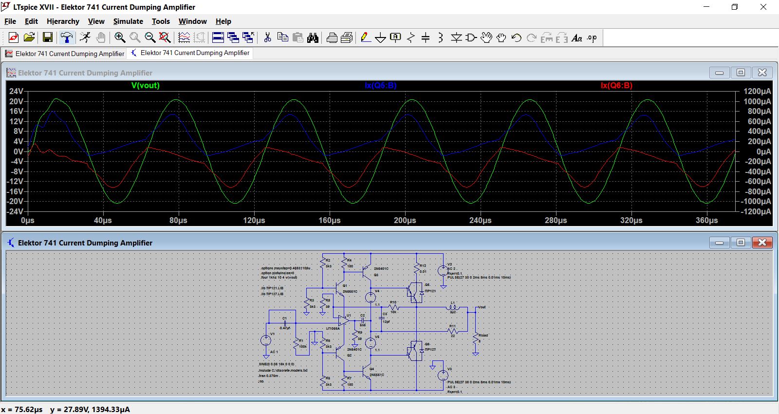

Try these. It's surprising just how distorted and 'ringy' driver currents can be.

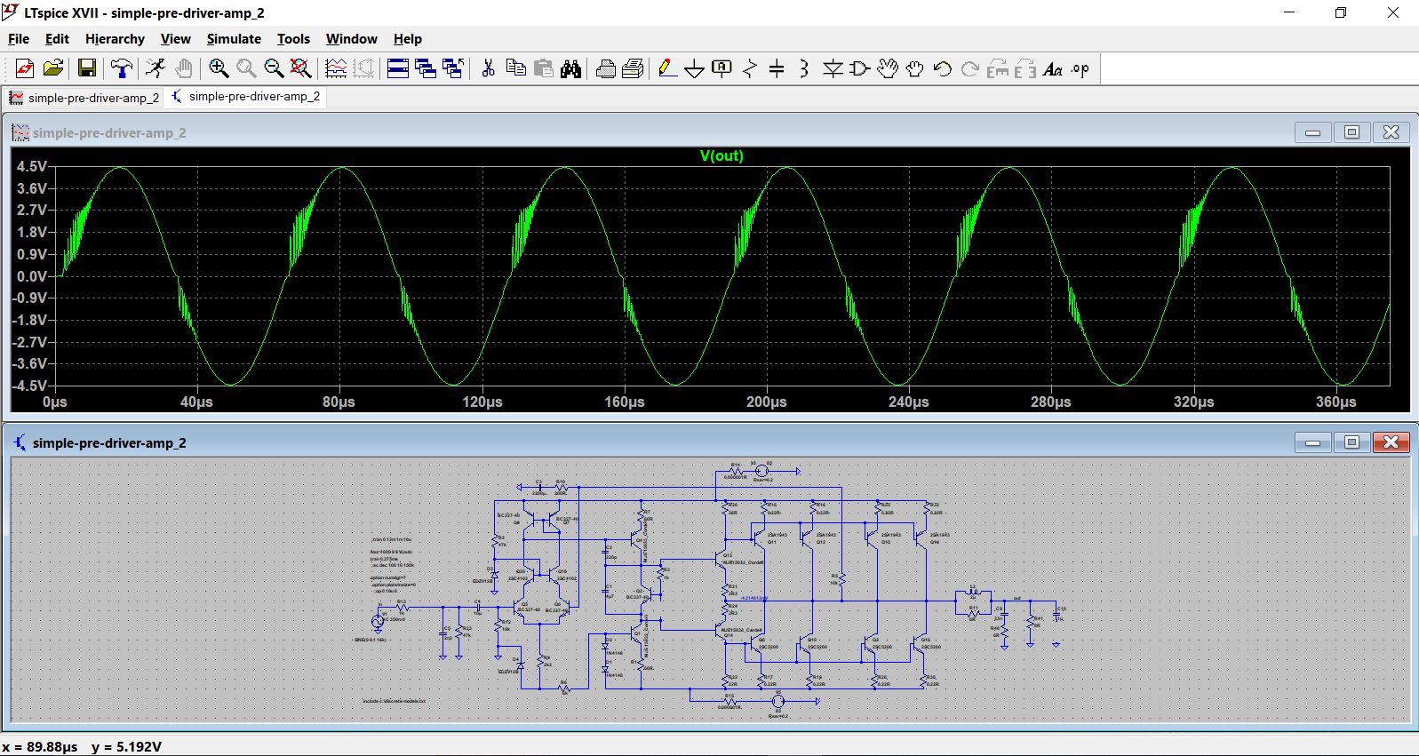

Thanks for those circuits. All of them have considerably less ringing than my circuit which means I am still not ready for the real thing. I am posting my latest update of the amplifier circuit which seems to have an improved distortion figure and considerably less ringing than the previous circuit. At 16kHz, the distortion: 0.023648%(0.023715%) At 1kHz, the distortion: 0.021927%(0.029916%) [There is absolutely no ringing at Ib(Q13)]
I looked at the Blameless attachment you included with post 177 and ran the simulation. Somehow the type of transistor used for Q9 is absent.
I associate ringing as having to do with reactance which will be present in a speaker load.
With that worry in mind I made some alterations to your simulation to see if it might be possible to resolve that issue.
The evidence in the attachment shows the shapes are still distorted but there is no ringing. An improvement in THD to 0.007% (0.01 % normalised) was noted. This is getting a little off topic but I can post my .asc file if there is any interest.
As far as the project amplifier is concerned I would hesitate to build something as big as this without running a Tian test for stability on the final version of the circuit.
