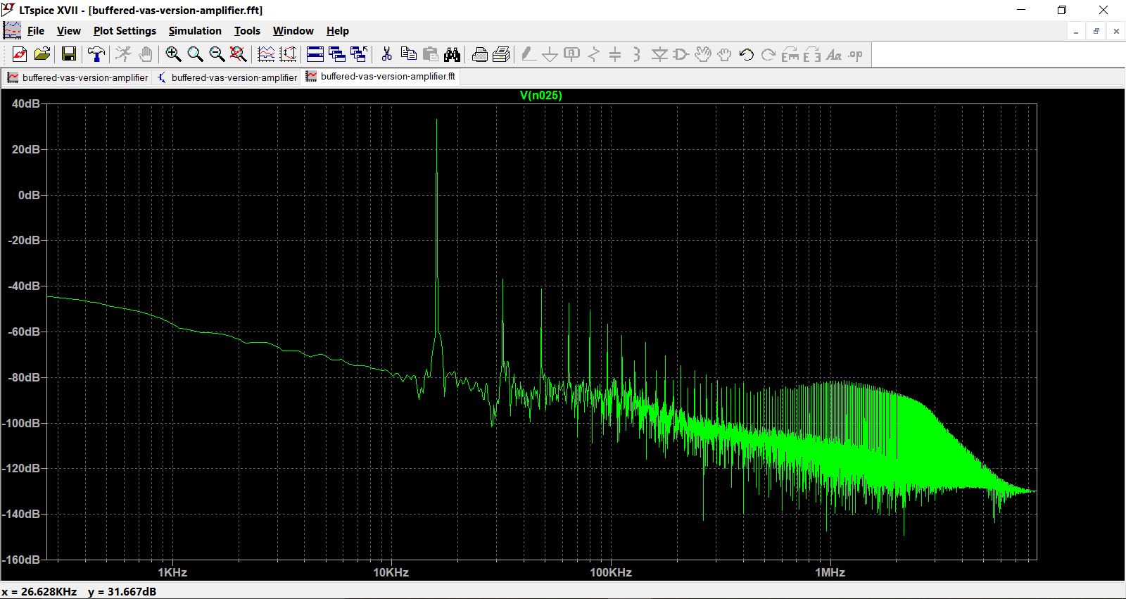

The preceding circuit failed the square wave test with heavy ringing. The frequency response chart, Vout VS Frequecy, has a weird shape. At about 100KHz it rises to a maximum above the low frequency plateau, then it steadily drops almost to zero at about 200kHz.
Administrator
Joined 2007
Hard to say really. The distortion is perhaps a little high but the FFT looks fairly standard for this type of amplifier.

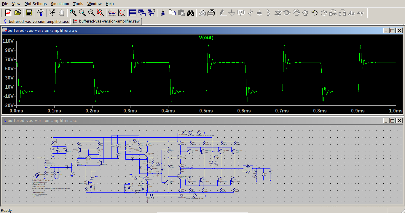

The attachment shows a square wave test with my latest version of the circuit. There is ringing at both edges of the square wave. I am posting, and I beg pardon if I am being a nuisance, as I do not know whether this amount of ringing is normal.
Administrator
Joined 2007

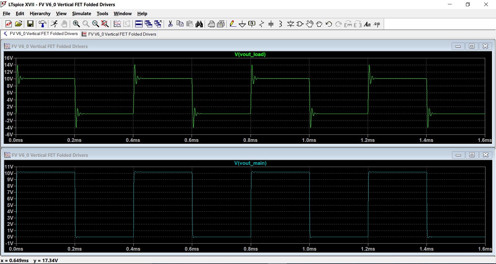

Its perfectly normal because it is the inductance and load capacitance alone that is causing the ringing. I think you will find the voltage at the input to the inductor looks much cleaner.
This shows a design of mine with the output voltage shown before and after the inductor.
Also try this. You will see the source voltage is always a perfect squarewave but the load voltage rings... how much depends on the values of the components and load.
  • Ringing.asc
