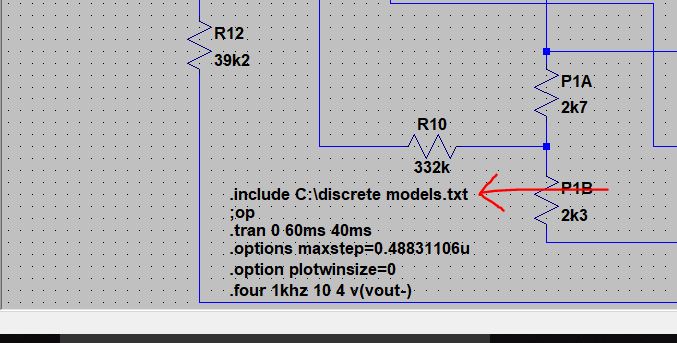

At the moment I am trying to add support to more transistor types to LTSpice. I found a list of around 1000 transistor types but adding the list to standard.bjt did not result in the new transistor listed. Any help in this regard is most welcome.

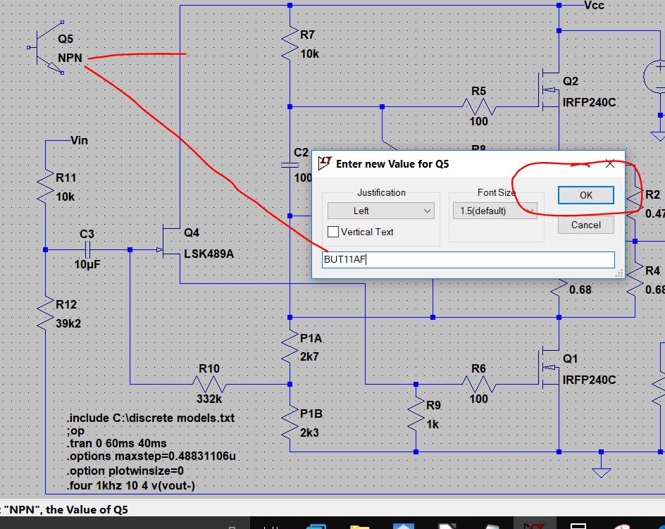

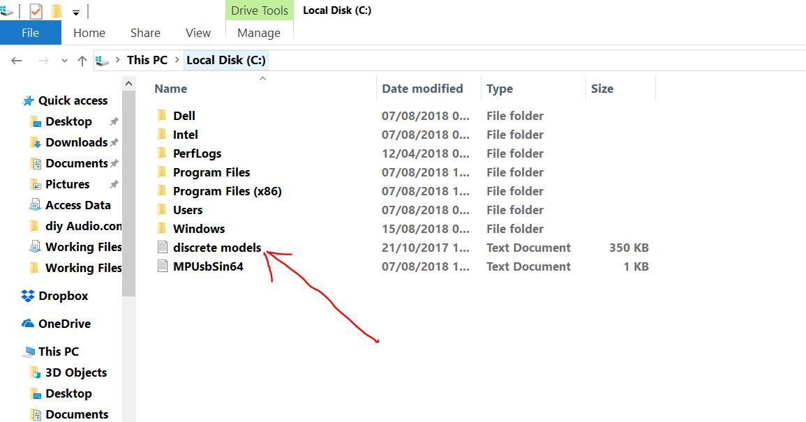

The way I add models is to paste the notepad file containing ALL your additional models directly into the root directory of the C drive having first given it some recognisable easy to use name. I then simply add a .op command to each simulation file saying .include C:\discrete models.txt
To use any device on the list you simply right click the component (right click the NPN text) and enter a model from your list.
I added the .include directive to the schematic without success. To which file should I add the .include directive? And, from where did you get the transistors list? I have a feeling mine is not in the right format. Is there a way of configuring LTspice to always load added component lists? I tried to add the new transistors to standard.bjt but the new transistors were not recognised and when they were, the parameters were incorrectly read.
You add it to the schematic itself, as follows:
- click on the .op tool on right hand end of toolbar
- type in: .include modlefilename.typ
don't forget the dot at beginning
- click OK
- the .include command is now floating on your mouse
pointer, place it on the schematic where you want it and click
That's it.
Its pretty much as EssB says. You add the directive to your simulation workspace as a .op command. Make sure the filepath points to the location of your file.
I've attached the model file I use (which needs pruning because there are duplicates of some devices). At the very top of the page is the filepath I use. That is what I paste (as a .op command) onto each simulation.
You can also paste models into the standard LT library files but that is a method I've never used as it ties the models to that particular installation of LTspice. Its a zipped file because the notepad file is to large to attach directly to the forum.
Thanks for this info. I was copying the model text file in the same folder as that of sim file and this was resulting in lot of duplication of files for every sim.

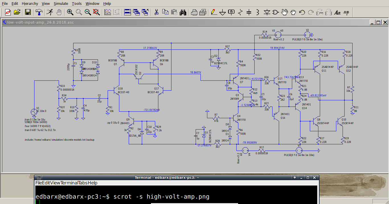

With a common base transistor stage inserted between the differential pair just below the current mirror, results show that a low voltage input stage driving a high voltage output stage can be implemented. The output offset voltage is however too high at around 90mV. I also found that the amplifier is very sensitive to the VAS's primary stage bias resistors. I am attaching a screenshot of the circuit as shown in LTSpice under Linux.
How can the offset voltage be tamed down to a few millivolts?

I would like to beg rispondents to this thread pardon for always posting images instead of the real .asc LTSpice files. Yes, it is a stupid omission, as posting the real file, instead of a picture, not only uses less server resources, but is more useful for anyone wanting to respond.
I used the option:
.option numdgt=7
.option setwinsize=0
but I did not get those mouth-watering low distortion figures. What I am getting is around 0.02% which is good even for commercial amplifiers. This amplifier uses a common base stage to interface a low voltage input stage with a high voltage VAS. Surprisingly, the solution was to use a simple common base stage embedded between the two heads of the differential pair input stage. Since, the current mirror enforces equality of currents reaching the low +V rail, any difference in currents, must be directed through the common base stage.
I found that instability problems, were greatly reduced with this setup. Yes, as expected, there are more instability issues compared with an amplifier using the same rail voltages throughout all three stages, but these problems are far less pronounced compare to using additional interfacing amplifier stages.
I tried the 20kHz square wave test but didn't get it right. It seems the slew rate is low, but the AC analysis shows that the amplifier cuts off at around 100kHz. I extended the analysis up to around 1 or 2 Giga Hertz, but something tells me this is like cases of extreme extrapolation.
