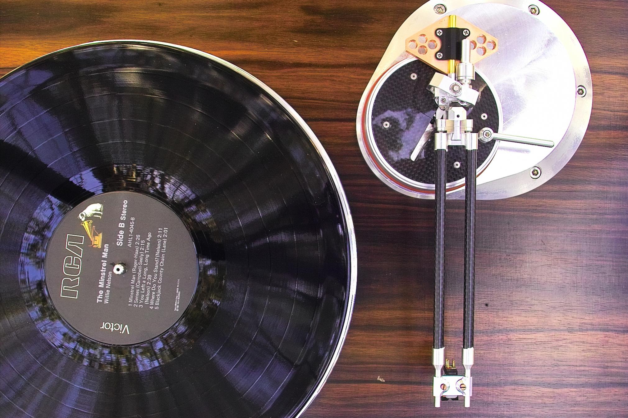

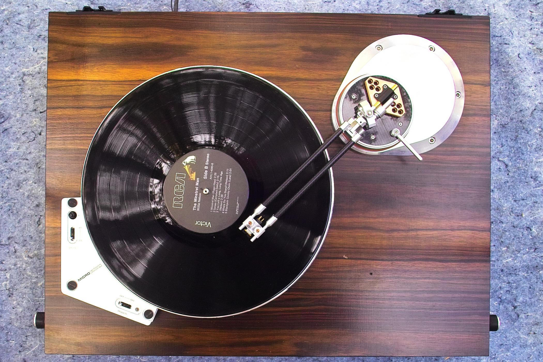

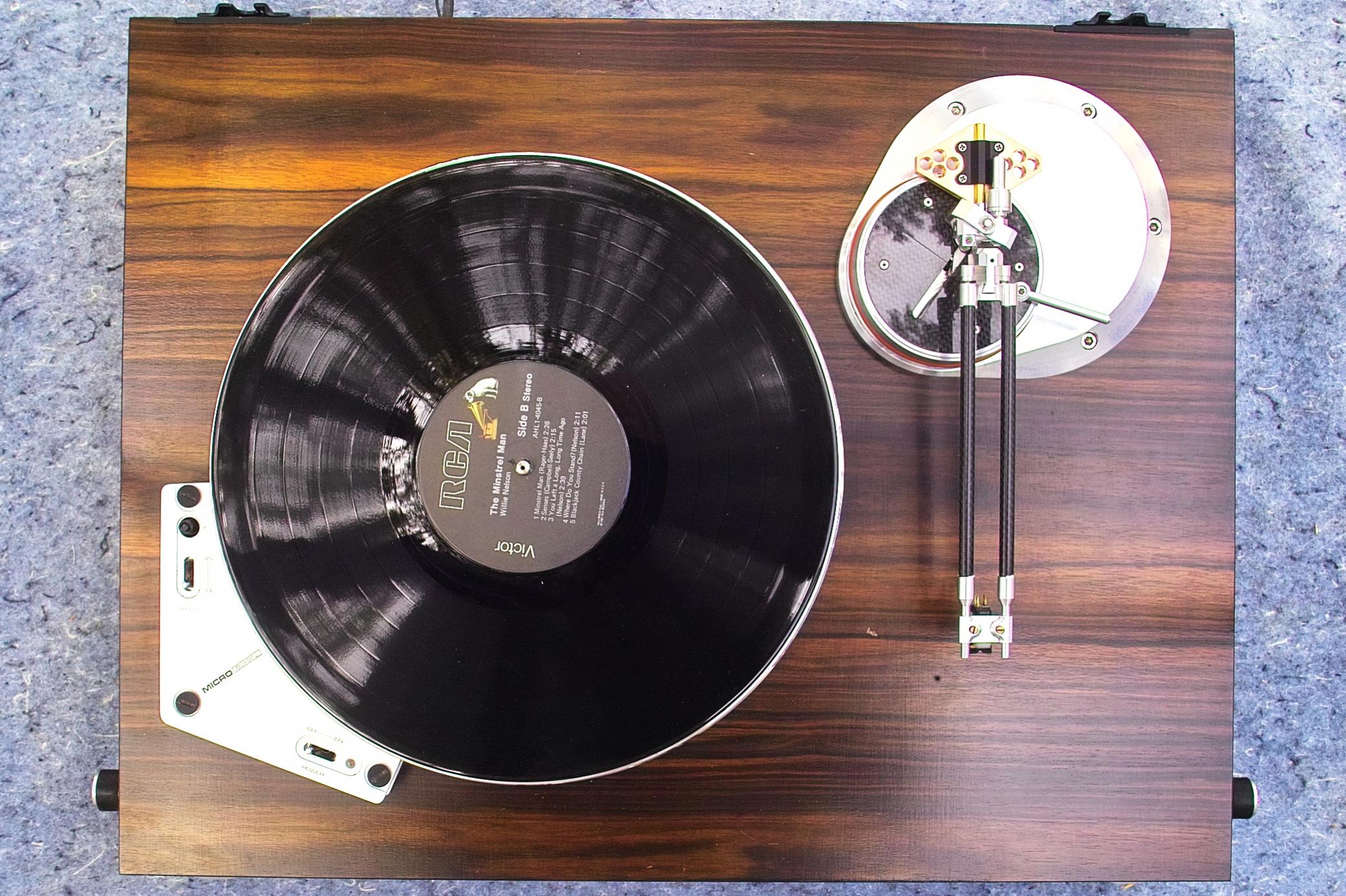

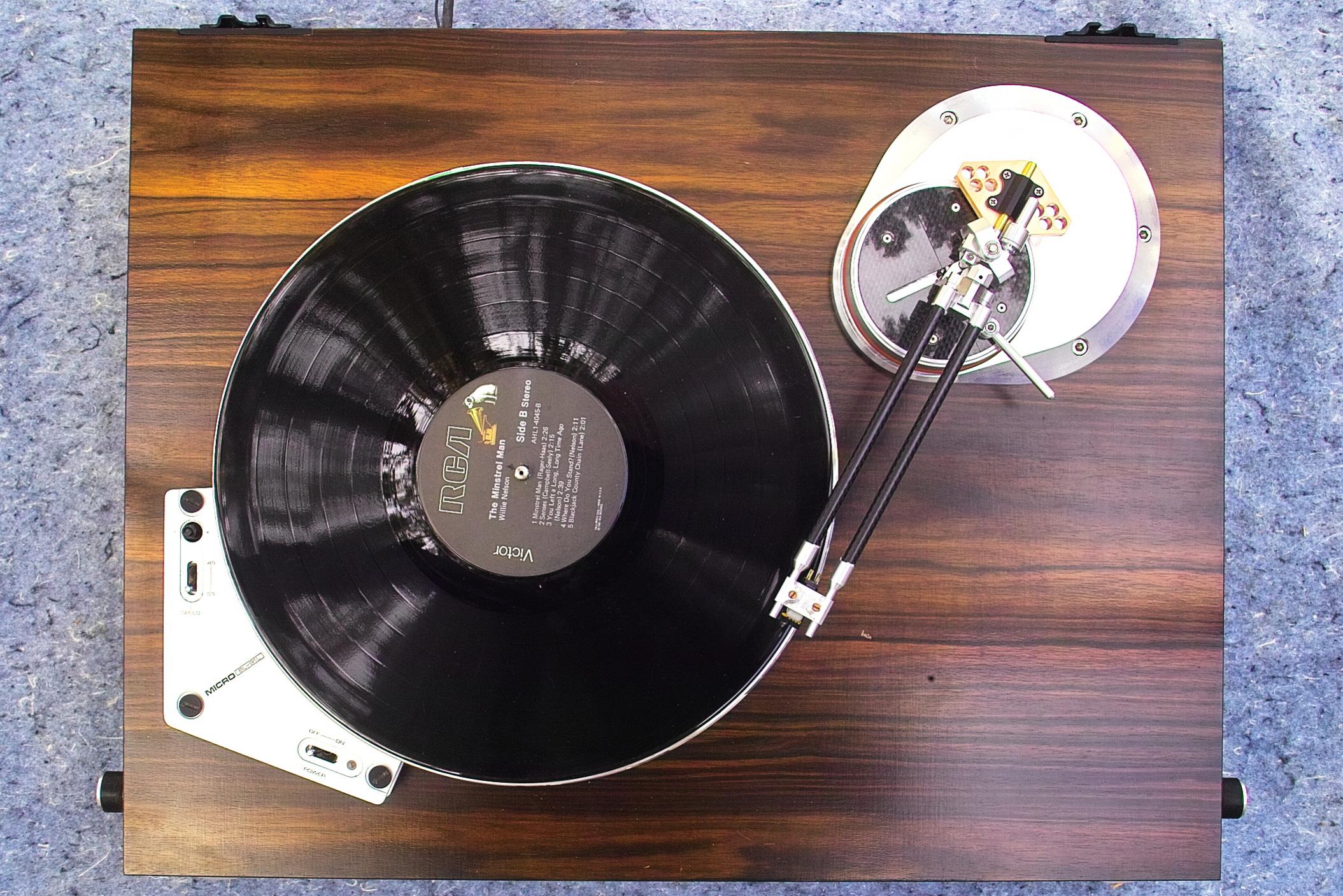

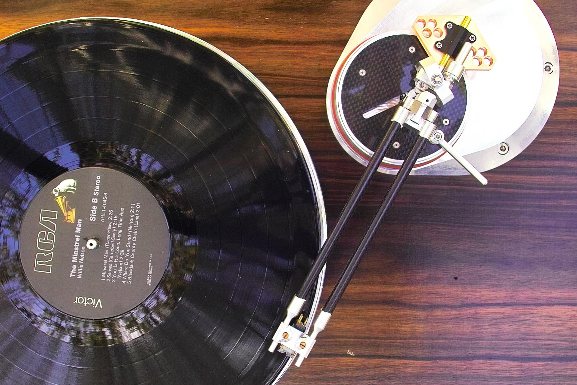

To all patient waiters,
well, I finally have some photos ready for you. I spent all of Thursday and took thirtyfive pictures, twentysix of which I'll post.
I've assemled the tone arm temporarily without the internal wiring just to take the pictures. The parts are as machined with no finish yet. when the parts are truly finished, I'll have them clear anodized.
The first three photos show the arm in the Rest, Start and End position on a Micro-Seiki BL-91 L turntable which I purchased in the early eighties. Note the position of the carriage on the cylindrical base.

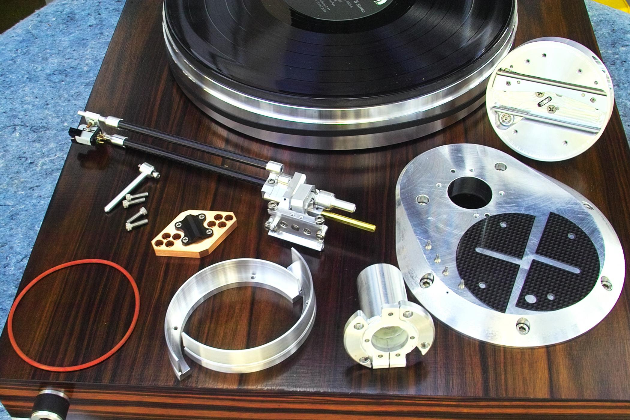

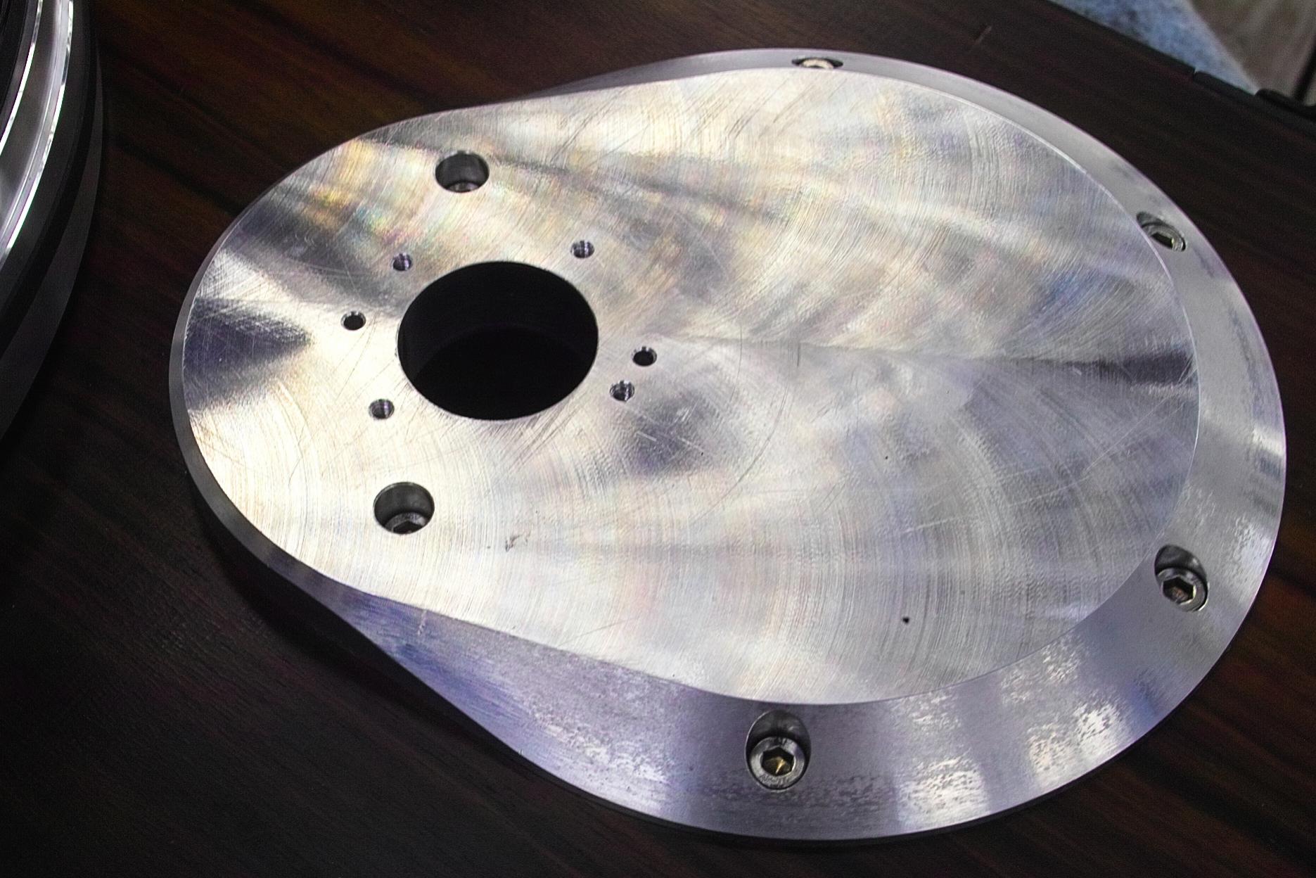

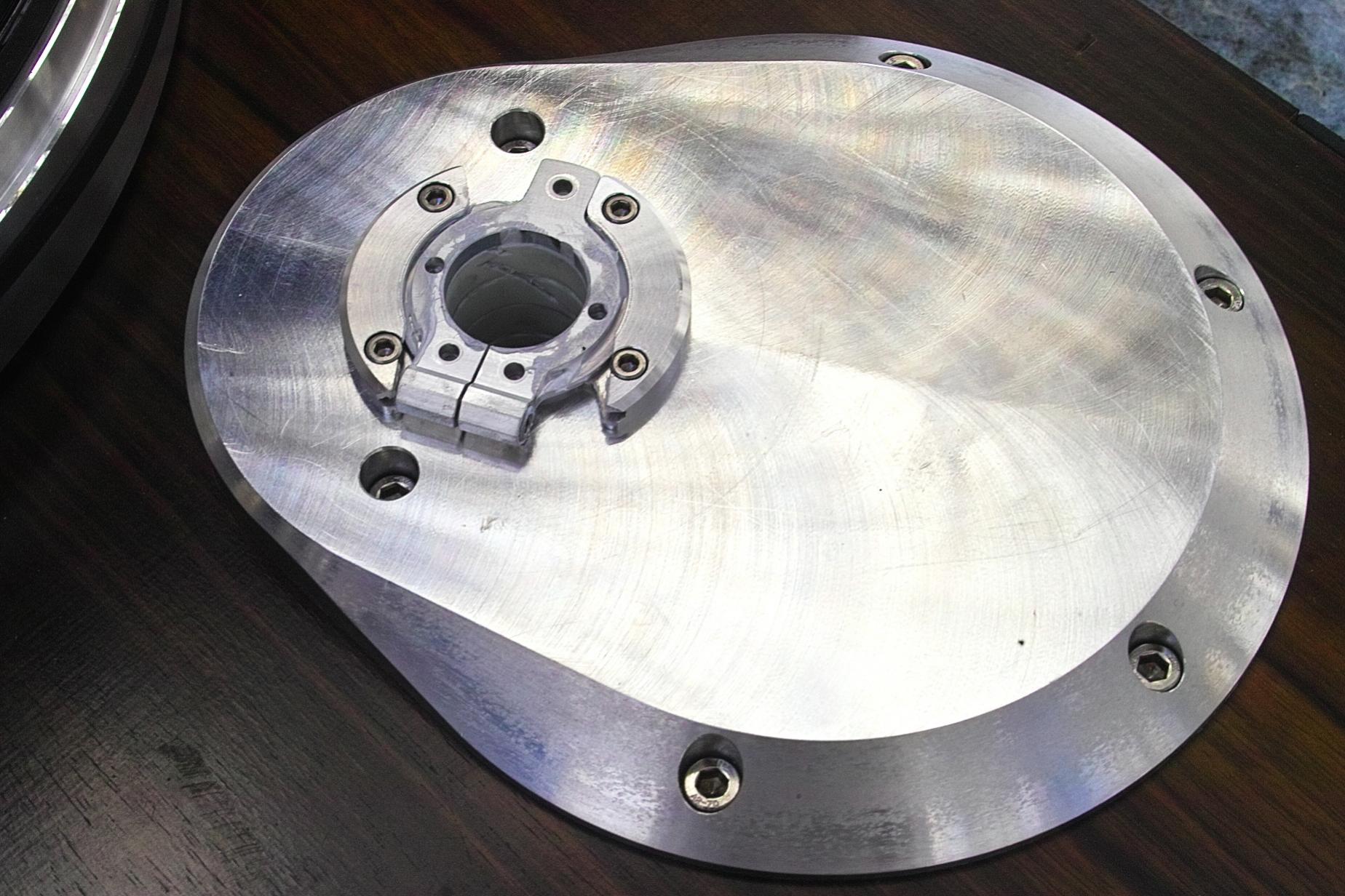

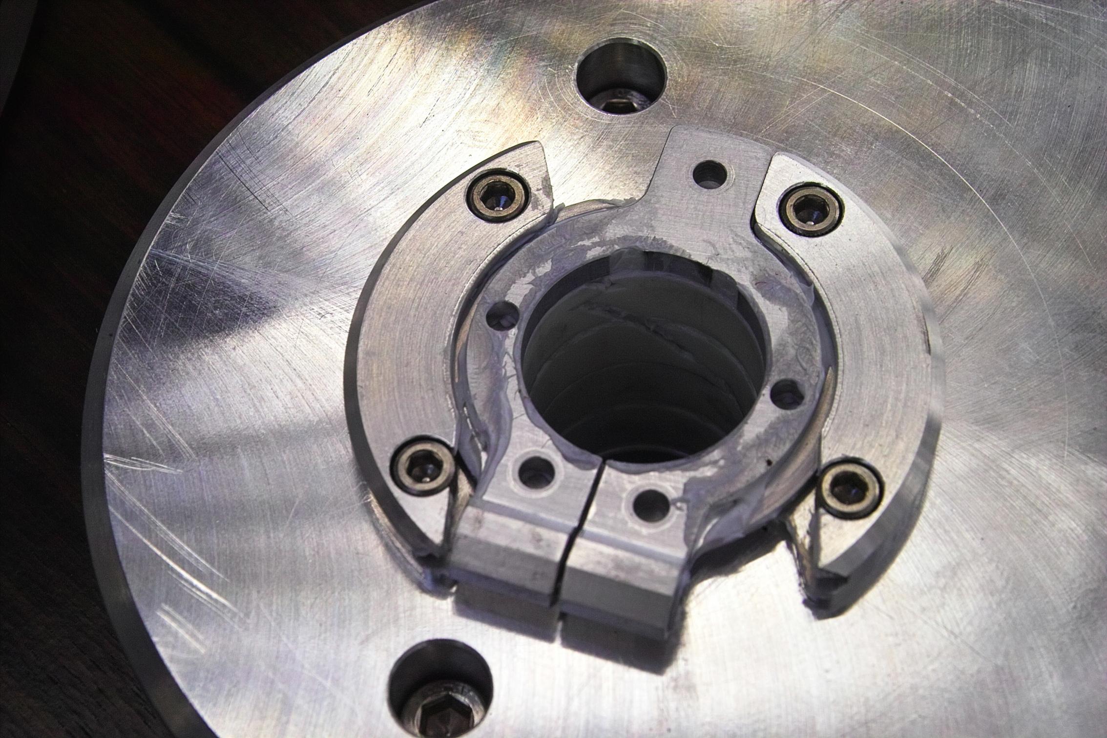

the first of the next four photos shows the Mounting Base for the tone arm assembly.
The second photo shows all the components ready to be assembled.
The third photo shows the Bearing Housing installed and the fourth photo shows a close-up the third photo.

- Analogue Source
- My 1980's Tangential Tone Arm and my 2010 improvement
