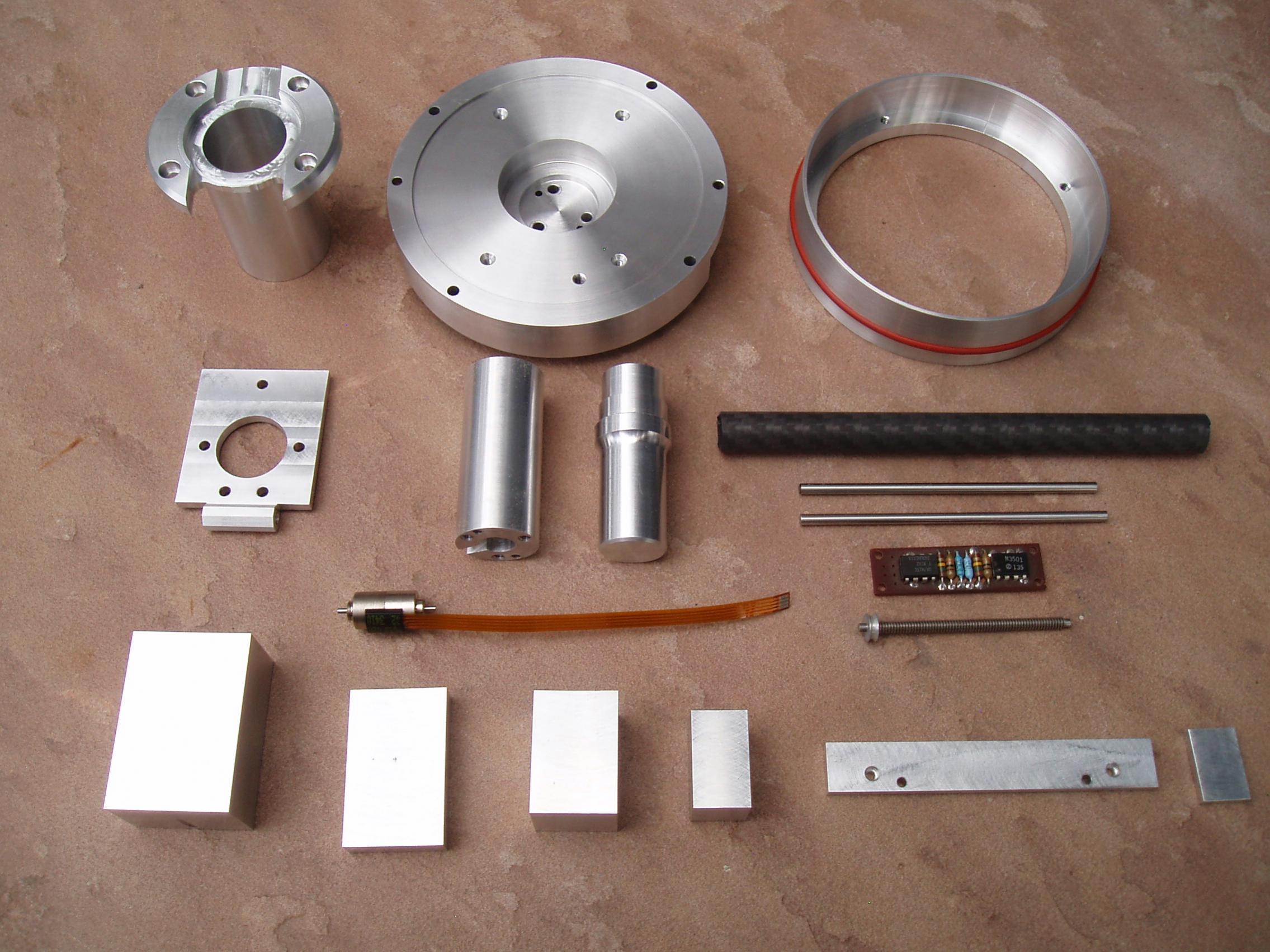

In this post I'll attach an isometric view of the 2010 version of my Tone Arm.
Also attached is a picture of some of the new parts I've made. The single carbon fiber arm tube shown, has been replaced with dual carbon fiber arm tubes. I've always liked the "Orsonic" head shell and so it seemed natural to switch to dual arm tubes, to take advantage of that design.

Thank you Kevinkr.
The principle upon which my tone arm is based is very simple, but turning that idea into an easily manufacturable product is difficult. But I am going to try.
Sincerely,
Ralf
Are the arm bearings in the same plane as the LP surface?
Yes they are.
In the 2010 version of my tone arm, VTA / VRA will be adjustable without moving the bearings for vertical motion of the tone arm up or down. The National Association of Broadcasters ( NAB ) allows a maximum of 1/16" warp in an LP. So, if I had a turntable without vacuum, weights or rings to hold the LP flat, I would set the bearings 1/32" above the plane of the LP's surface to the average height of the maximum warp.

Hello gninnam, kevinkr, lowpoke and Jim Leach
News, you ask? Actually I've been working on the parts almost every day.
I should have some photos next week or certainly the week after that.
My goal is to dynamically balance the arm. I went from brass to copper for the counterweight but couldn't get the center of gravity low enough without interfering with the base of the tone arm. I finally remembered machinable tungsten alloy which has a specific gravity of 18.5 grams per cubic centimeter. It took some time to find a supplier who would sell me a small quantity.
I do the necessary calculations in my CAD program so that I don't actually have to make experimental counterweights.
I did discover something though that everyone else probably already knows:
You can have a counterweight of a given mass 3" behind the tone arm pivot or you can have a counterweight of a greater mass 2" behind the tone arm pivot. the question is: how do you optimize that relationship?
Jim Leach, you're the first one to have discovered my use of "Free Flex Pivots" or weird rotary spring things as you call them.
I'm going to use them in my new Arm also. for both the horizontal and vertical bearings, four in all.

Hello popeetheus
Thanks for the kind words.
Hopefully you'll keep us informed as to your progress.
My original Arm was servo controlled. Both my original Arm and my new Arm run on polished 17-4 PH stainless steel rods.
I'm going to try operating my new Arm by the pulling friction between the stylus and the vinyl LP. I know that that will work. The question is: how accurately?
I allowed enough space in the base of my new tone arm to include the components of a servo in case the friction drive is not accurate.
