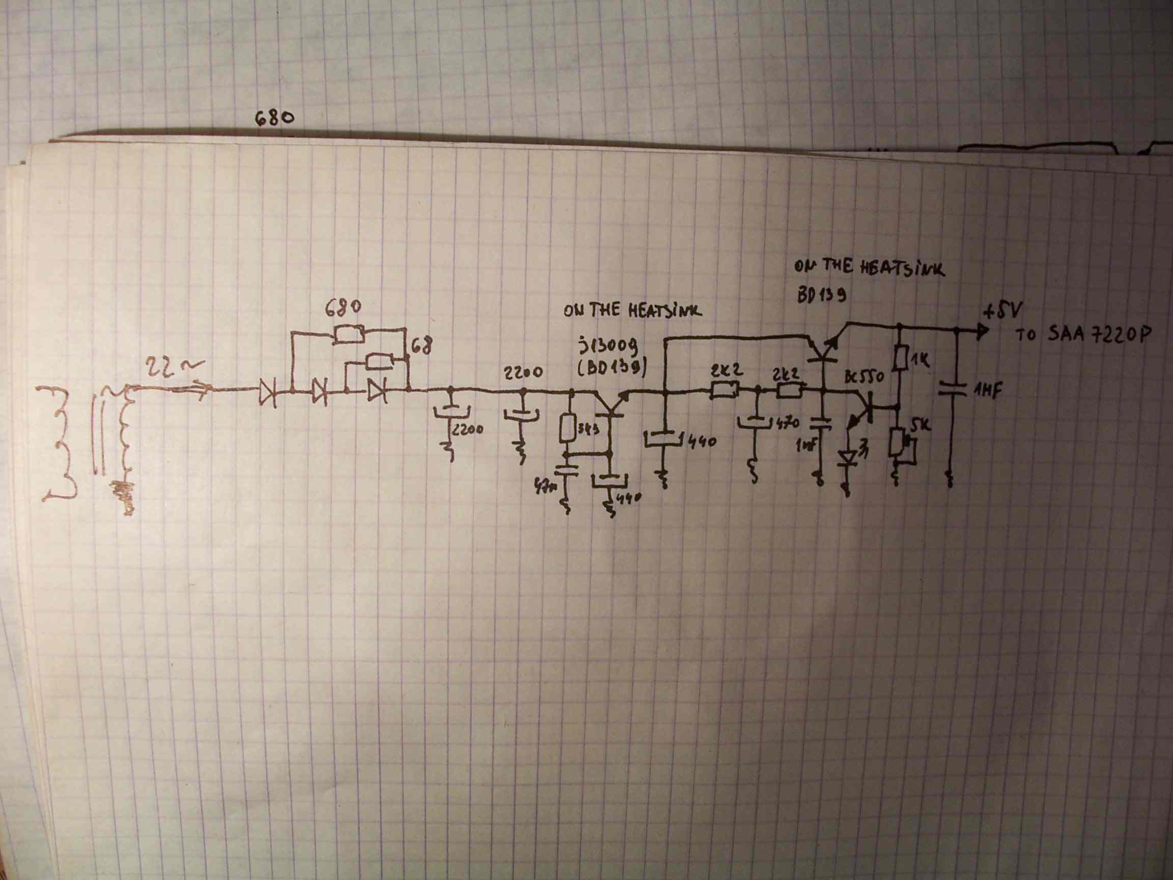

Hello Bardos,
Durring night i have designed the PS PCB for SAA7220, the same circuit as for +5V of the led PS. It will have separated trafo and different transitors, in this case i will use J13009 mounted on the small heatsinks. For filtering caps I will use 10.000uF/25V, 2200uF/35Vx2, 220uF/63V Vishay x 2, and Silmics II 100uF/35V. The trafo will be mounted on the PCB also, the voltage on the secundar is 11V.
This morning Im going to solder the components and I hope ill have time to try if it works.
Ill send you photos when it will be done.
Best regards
Goran

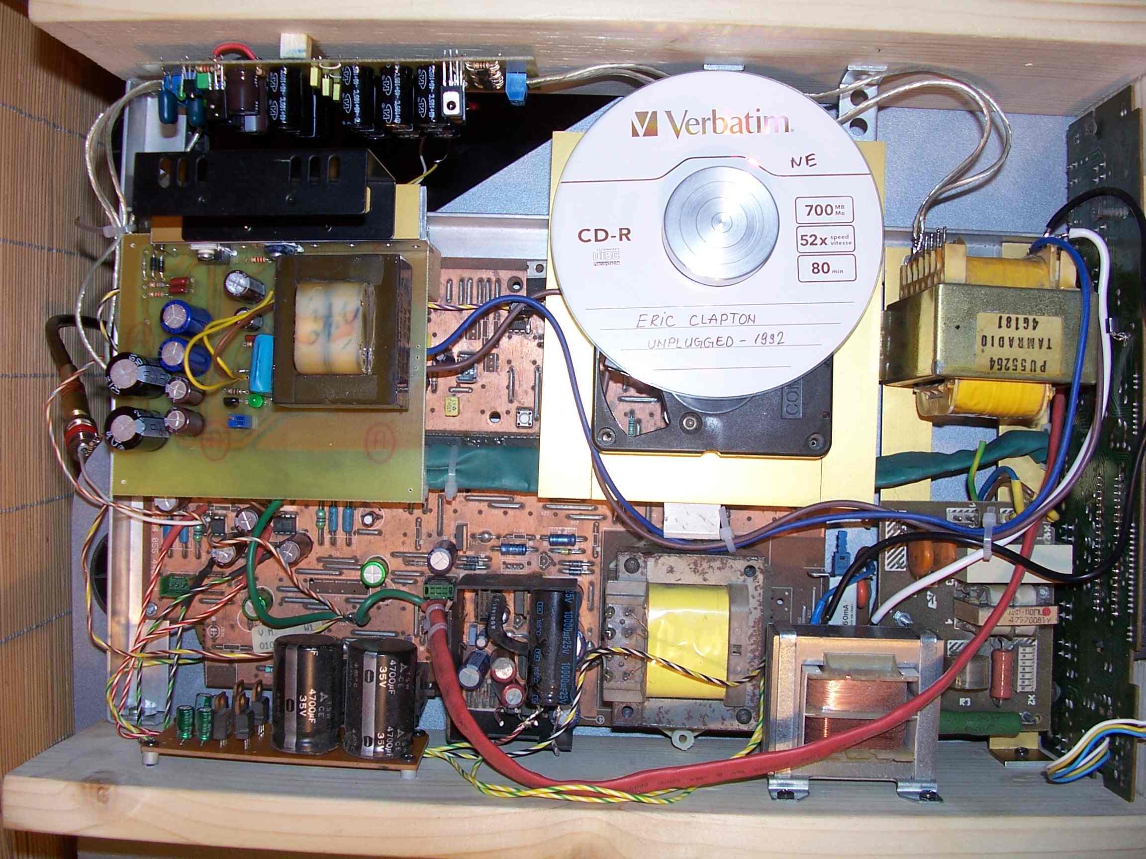

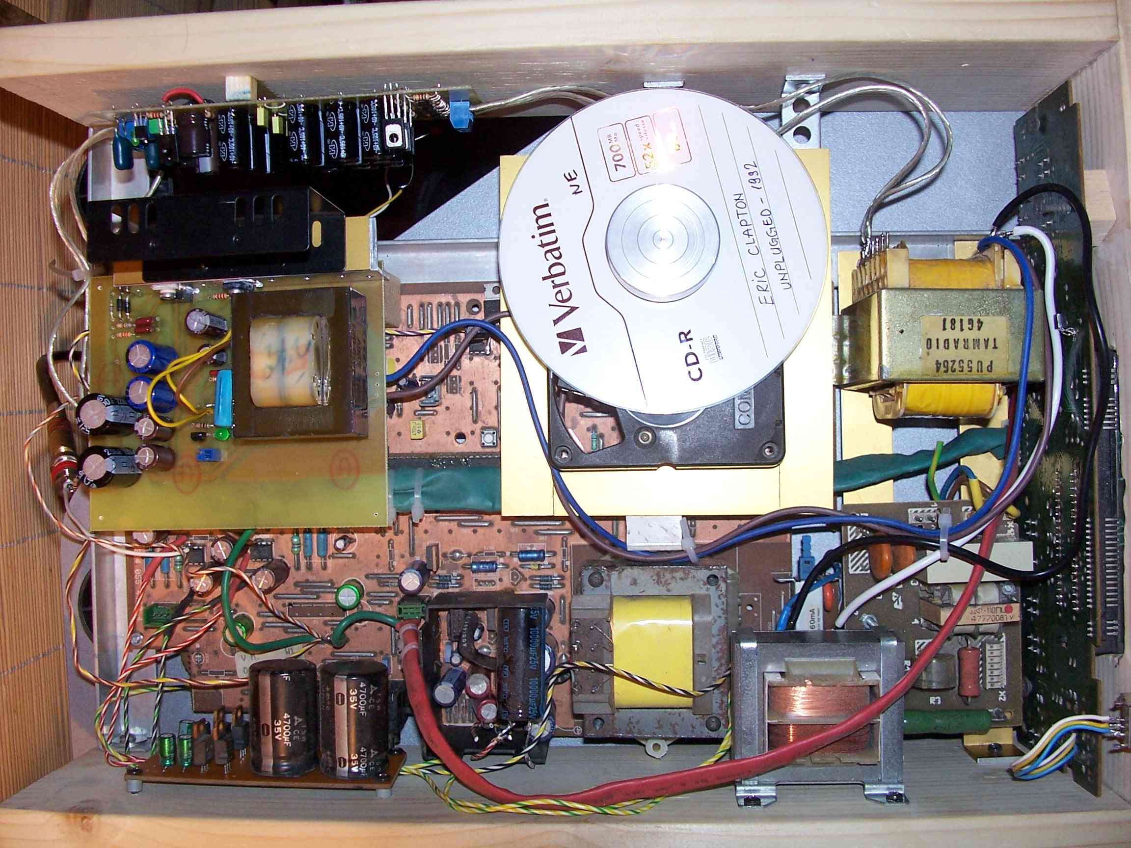

Bardos, things get complicated a little, i already have 4 trafo's inside CD player, the best would be to build separated box for the trafo's. I should find or build some nice metal box for that purpose, but for now im just testing so ill stay with the box i have. also i will need to make better transport, the problem with that is that flat cable is too short, im not sure if its a good idea to make it longer and install the transport on the top of the enclosure.
Maybe you have some experience about that, i mean if the longer flat cable could produce some problems?
Regards
Goran
Hello Bardos,
Sounds PERFECT :)
I highly recomend You to build it. I made some small modifications.
Im still testing it, especialy the heathing of the transistors. The heatsinks are necessary here.
Very good sound, I think I wont sleep this night also :)
Cant stop to listen .

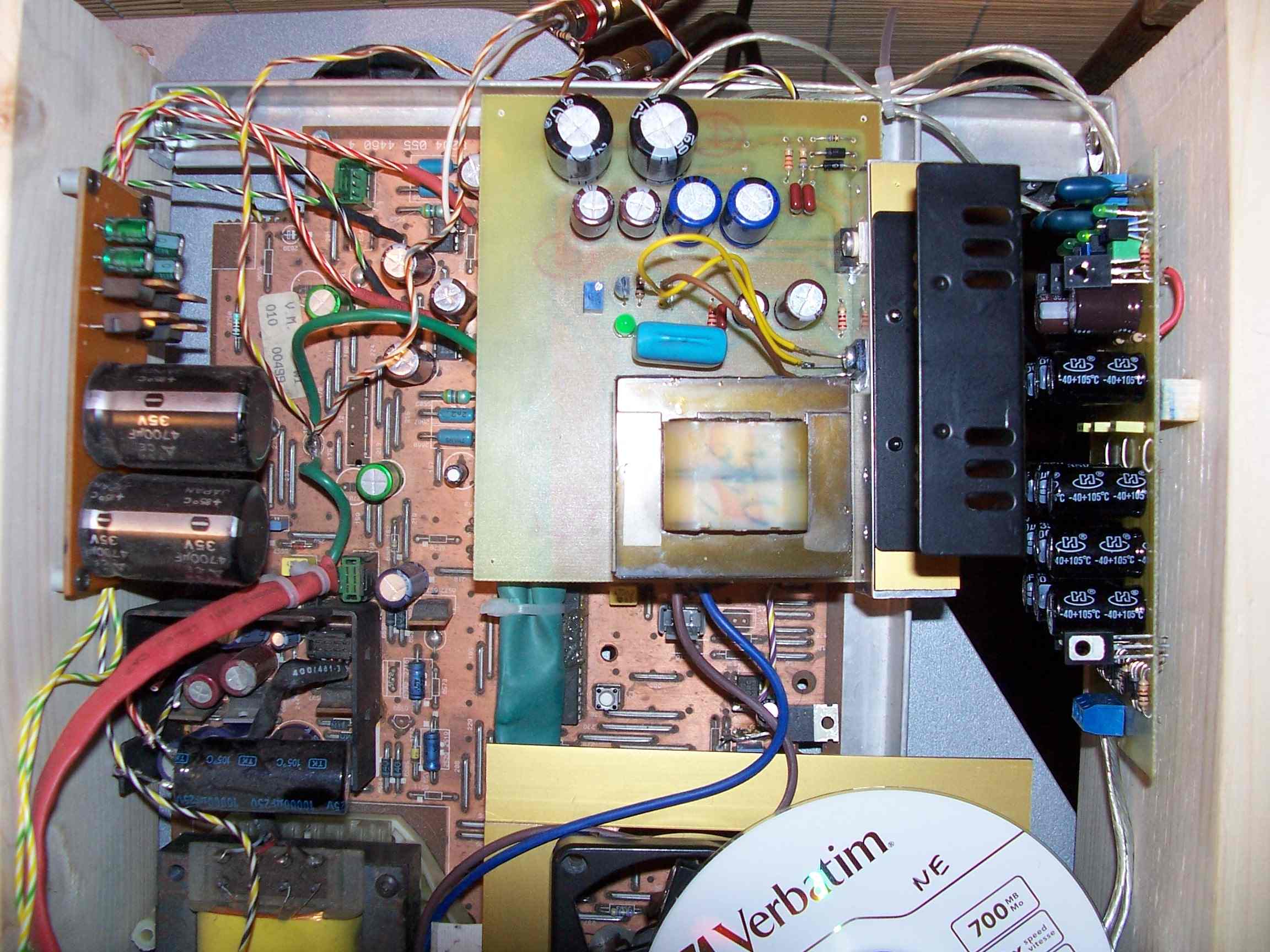

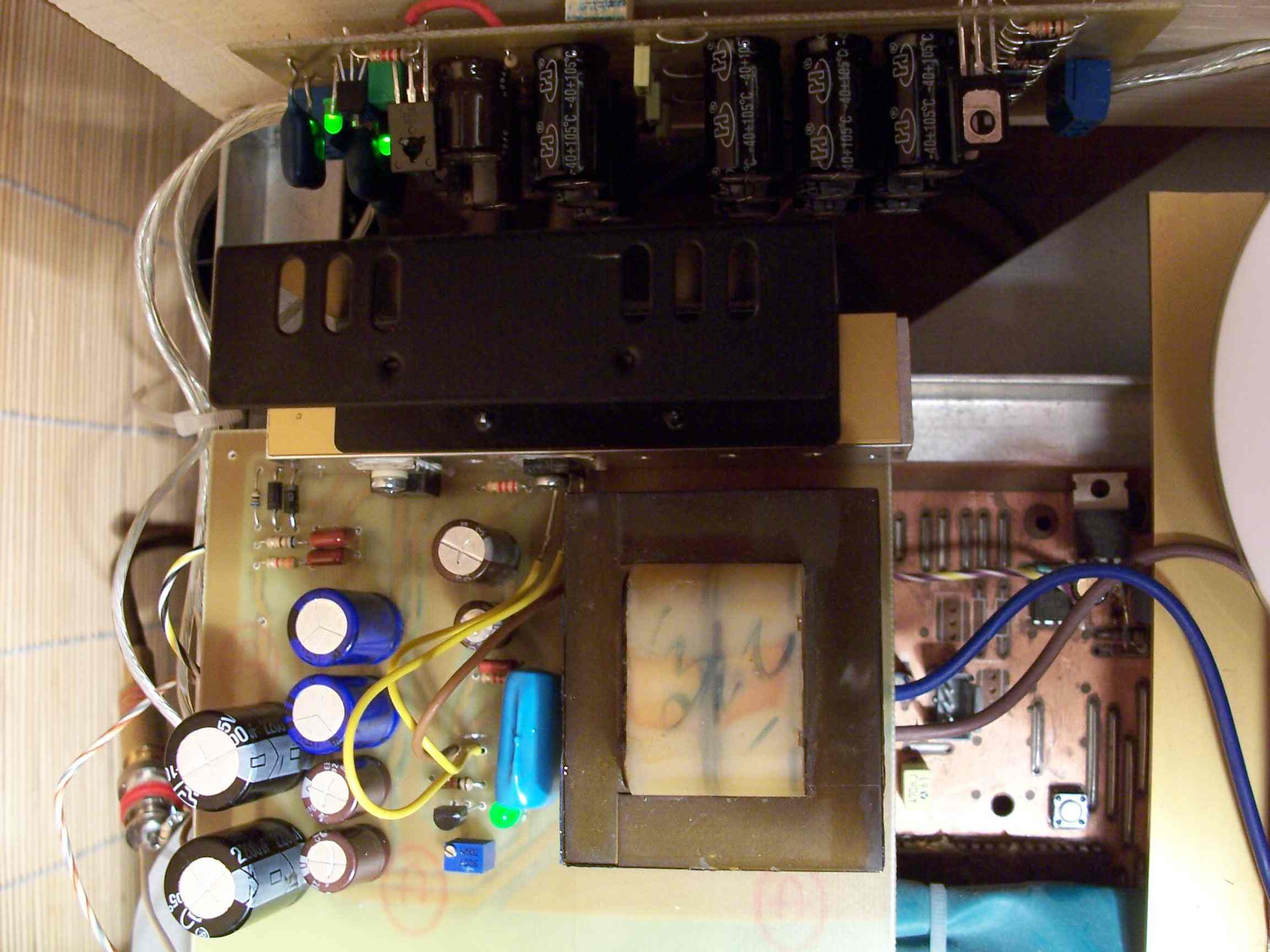

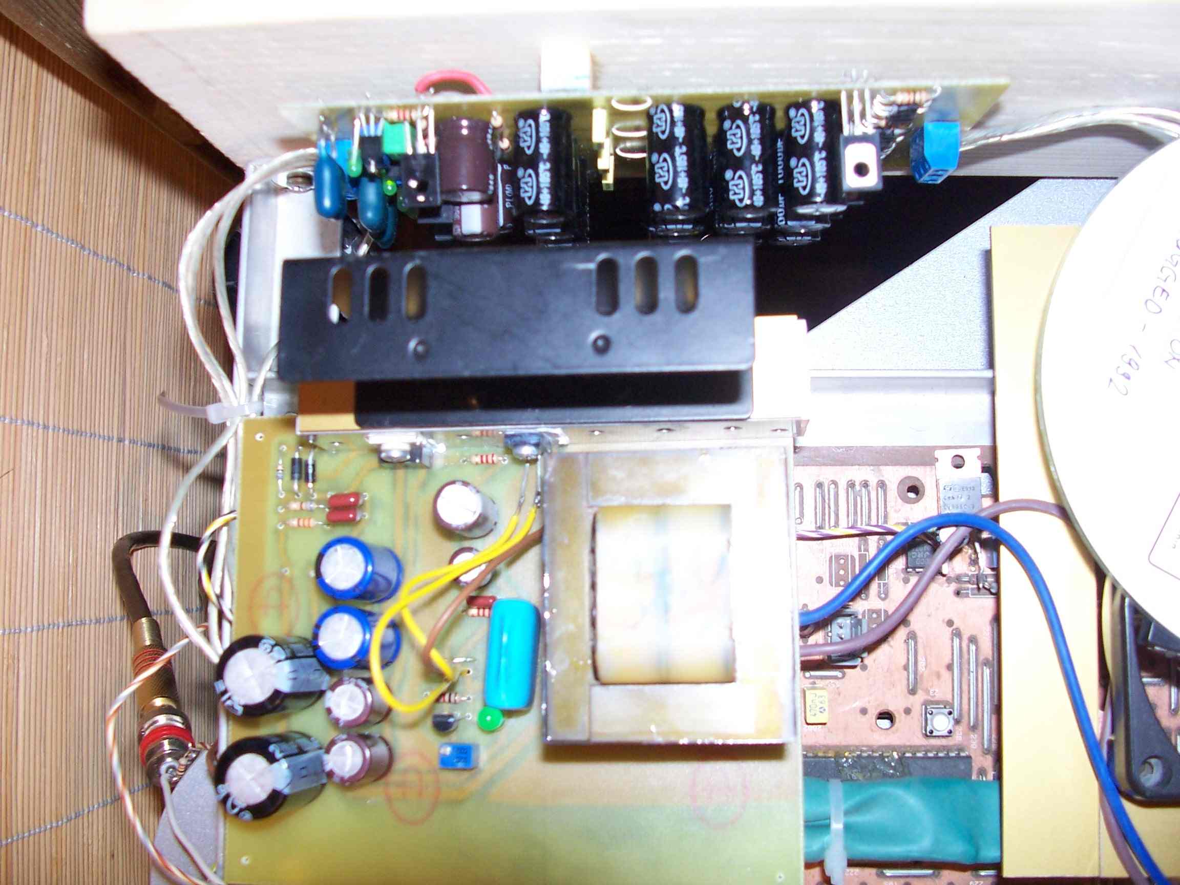

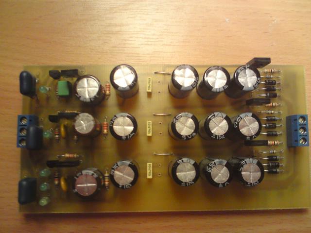

Hi Bardos,
As I promissed im posting photos of the PS boards.
Hi
I too have a phillips based cd player with separate 7805's dedicated to SAA7220, 7310 and Ram Chips. I have been looking for ways to improve this simple arrangement.
Would you make additional boards and maybe sell them to other members like me ?
Your boards are an excellent solution but would understand if it's not practical do to this
I am also learning quite a bit from this valuable thread and can already implement some changes from your advice so far - keep going !! :)

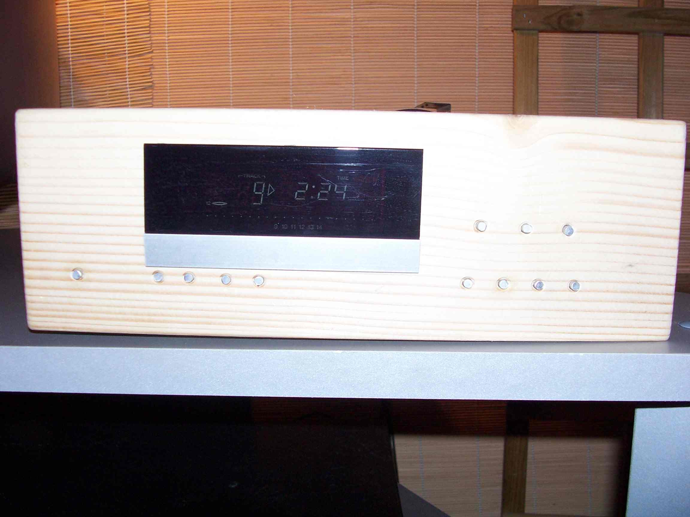

Hi Goran Nice job on the PSU and the box look very cool. Thanks for the 7220 ps. So the BD139 seems to work right. I will try out as soon as I fixed the Nad 3020.
Thanks Bardos, We both know its not so cool ;), but just wait when ill finish all mods and tests :) I already have plans for new really cool box. Yes the BD139 works great. Its turned on for 24 hours and it works perfect. Really great improvement. Just as I suggest you will need a heatsinks for both transistors. You can also use BD139 instead of J13009, or some really fast transistors. Regards Goran
