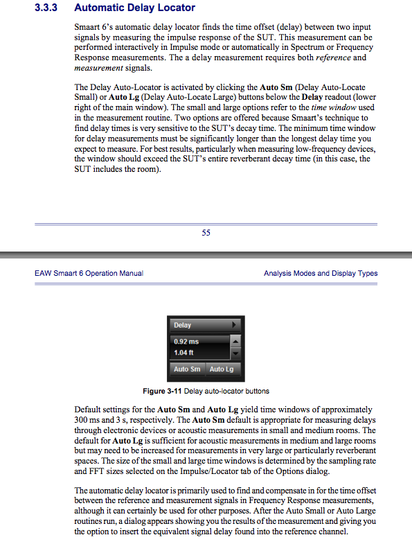

So how exactly do you do that "LF alignment"?
As I explained in #1661, the exact specifics of an alignment depend on a number of variables, but I use Smaart as the tool to measure those.
It has a delay finder, which is quite useful for "getting in to the ballpark" when doing alignments.

How does that "delay finder" in Smaart work? What are the variables you're measuring/taking into consideration?

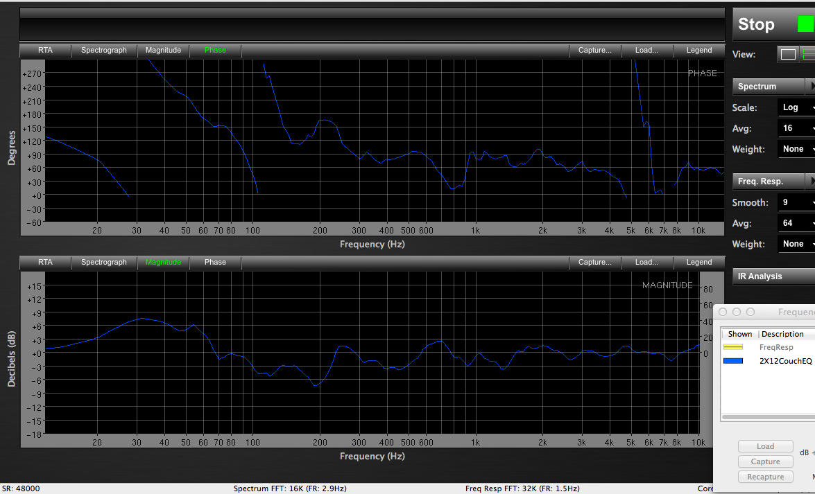

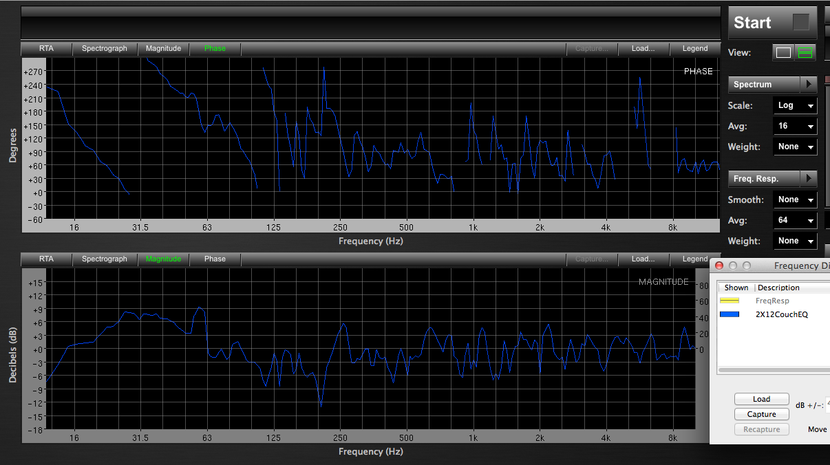

Works pretty darn good . The details are attached.Not trying to be funny but asking a specific question. By the way, Earl asked exactly the same question.

Smaart, and other dual FFT measurement tools can provide useful information (arrival time, phase, and amplitude response) which can be used to set delay times, crossover slopes, frequencies and equalization to phase and time align loudspeaker systems through their various crossover points.
Sorry if my explanations are lacking the information you are looking for.
Are you looking for an explanation of some specific alignment?
