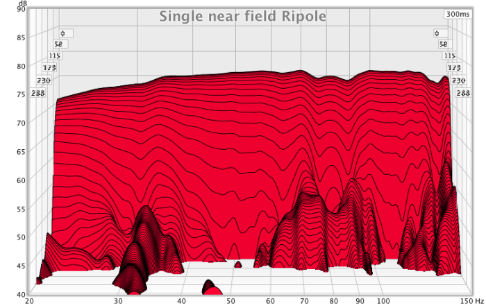

Well, I don't have any customers but I feel that the bass I have right now is the best I've ever heard
Here's a measurement taken just yesterday. The final version has a bass boost, so the response is flat to 20Hz:
Not that I know proof positive that using filters wouldn't "sound better", but I do know positively that it does not result in a smoother response and it is harder to get right.
Of course it's harder to do it yourself instead of having Doc Earl doing it. But this is DIY and I'm still in exploration mode.
I'm currently running sub(s) in the near field and found it critical not to run them too high.
That is quite a bit different than what I do and I have no doubt that what you say is true in that situation. Near field subs would be quite sensitive to HFs and phase issues. I've never tried it so I can't really comment. I can't do that in my room since I have two rows of seats and the door is just behind the second row. I think that most people would want their subs located at some distance - out of the way.
Impressive results though.
