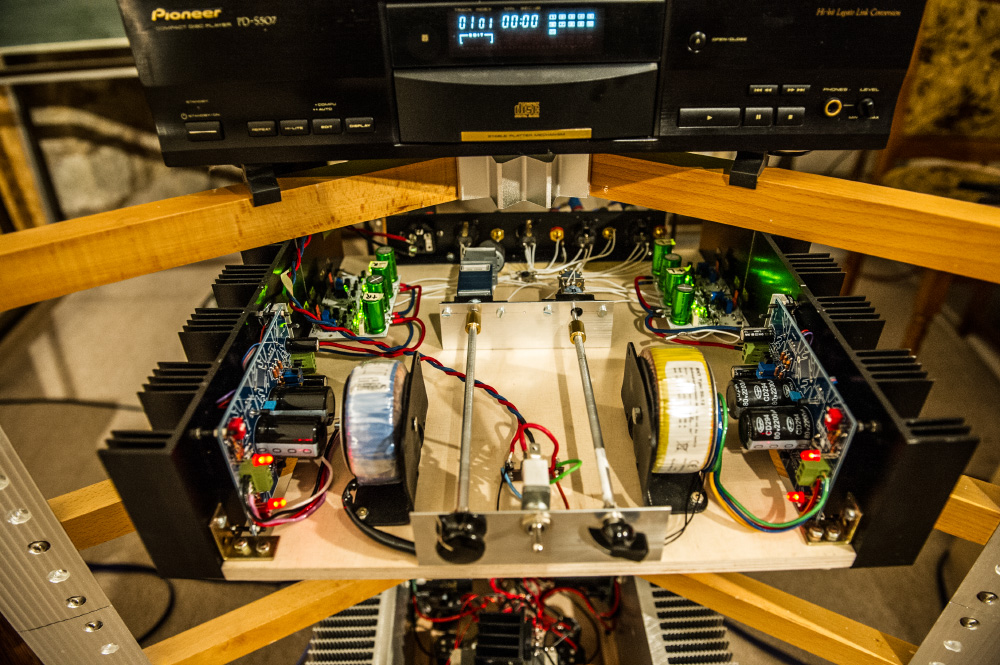

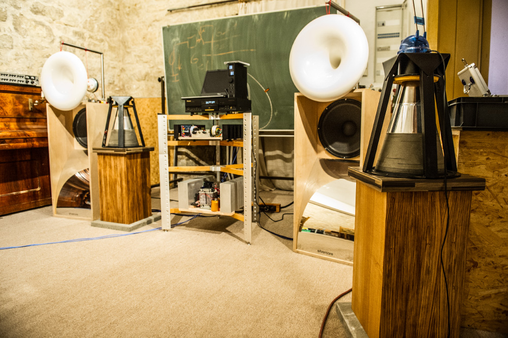

I succeeded to make a lineamp out of circuit post 10013 with the help of AS and Frans.
Offset is trimable and stable plus-minus 1mV.
This without any matching or thermal coupling, good.
In this case lowest offset also brings lowest distortion.
I learned from Scott Wurzer that this is a good thing.
More information soon.
