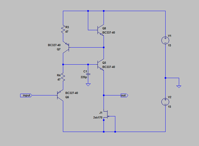

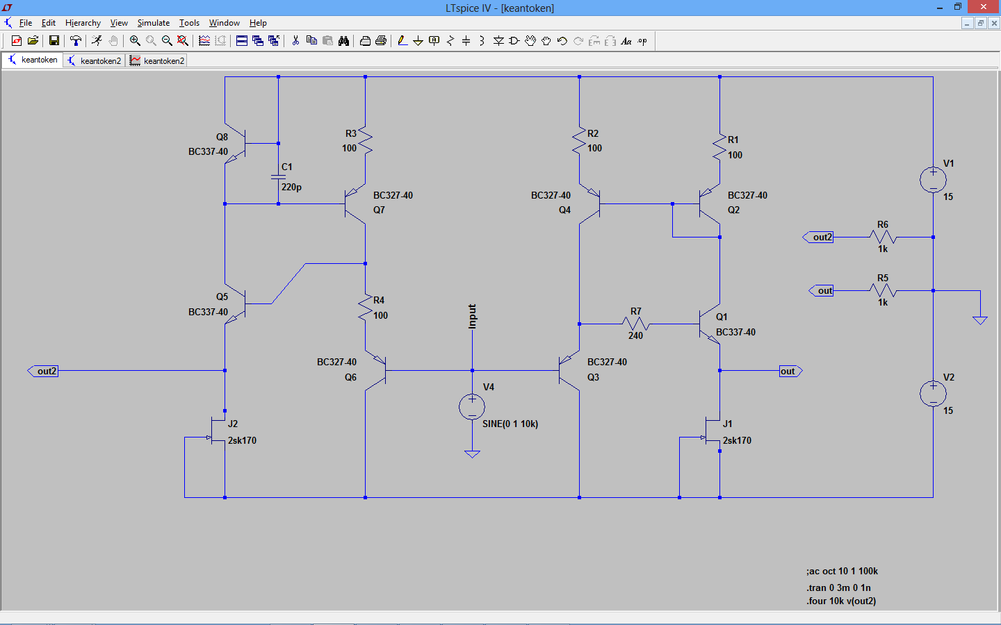

Today I have built and tested this two buffer, and they work very well both of them.
But the asymmetric keantoken buffer was the best, the distortion is very low with 2vrms and 1k load, the distortion was only 0.0008 mainly 2º .
shunt Q8 with a 1000uF capacitor to desactivate the error correction loop the distortion is 0.038% , so the error correction works very well ,
Adding a capacitor like I have suggested in previous post in parallel with r4 thoes not work, and makes the circuit oscilate, is better to use c1. The circuit is stable without the cap anyway , so is your choice , to use it or not.
The other buffer needs a base resistor r7 to be stable.
I like the buffer asymmetric, but to have less distortion possible ,One must adjust R3 and this causes the voltage at the output to desviate from 0 volts , in the prototype the output voltage was 140mV, need to find a soluction for this.
but the keantoken circuit is a winner.
One thing that happens a lot, is simulating a circuit in ltspice and the circuit is stable but in reality is oscillating and some time in simulation is oscillating but in reality is stable.
beginning to suspect that is something wrong with my reality :)

was trying to use R3 and R4 with 47R and the circuit begin to oscillate at 30Mhz .
To stop the oscillation 3 solutions worked.
a capacitor of 47pf between base and collector of Q5.
a 100ohms resistor in serie with the base of Q5.
or a 220pf capacitor between Q5 base and ground as picture.
EDIT:adding a snubber with 510R and 47pf at the input, as Keantoken suggested, also worked.
I prefer the input snubber as compensation because it does not affect the error correction.

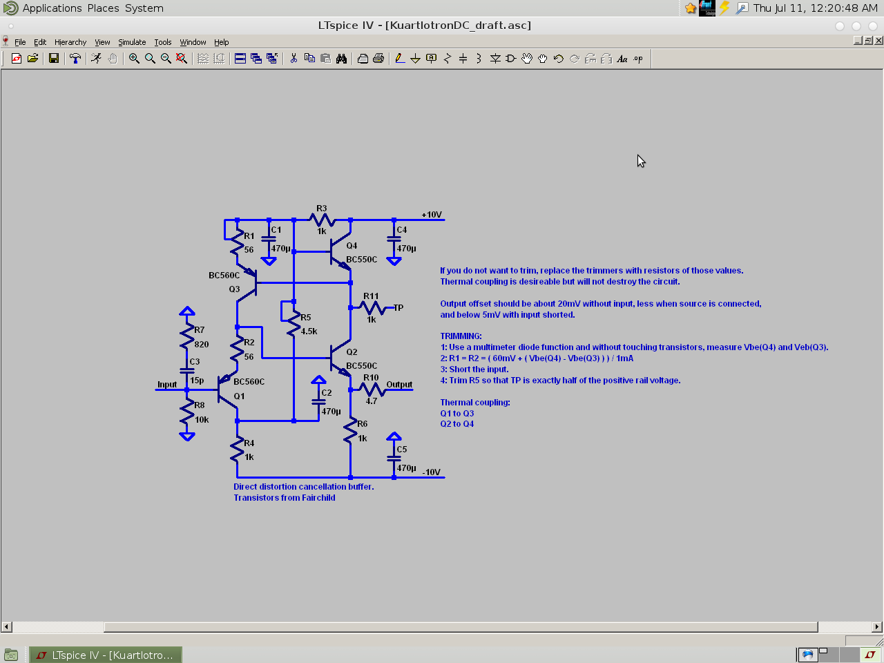

Joachim, how about this? This version should have the best performance.
Decoupling is not critical as long as it is there. If it affects the sound then I would encourage you to use what you prefer. I avoid the use of film decoupling <470nF along with low-ESR lytics because the rail resonance may provoke oscillation.
I would like to know THD numbers before an after trimming, if possible, so I could put it on the schematic. Dan has told me sternly the circuit sounds excellent at most trimmer settings. I think trimming adds some nuance but it's not very much.
Using BC337-40 as the outputs I think sounds better mostly, but if/when you do that you will need to do step 2 of the trimming procedure because the Vbe will be different.
