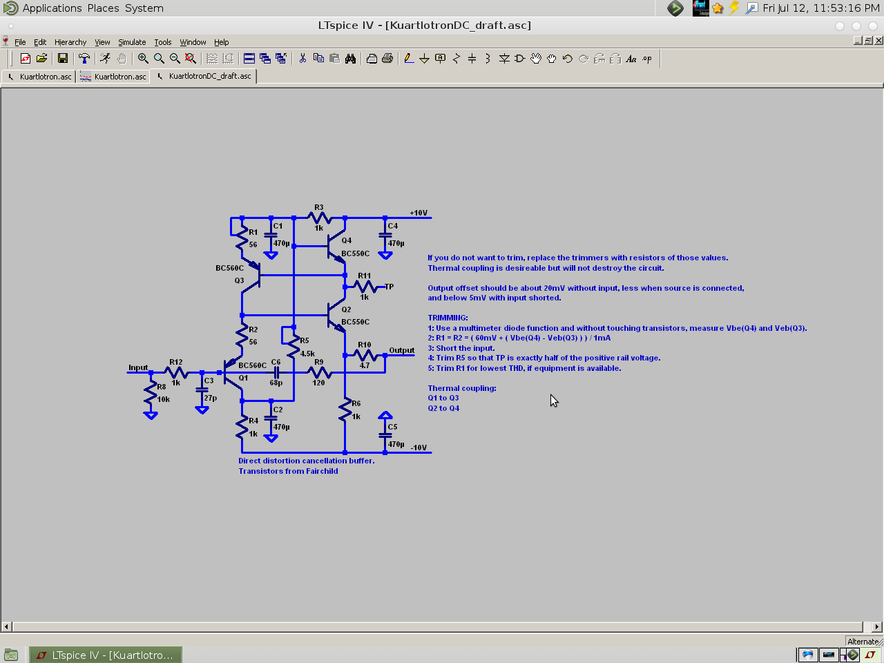

The voltage at the circuit's "ground" needs to be halfway between the rails. Something like this.
EDIT: Better schematic.

Do you know that for sure? Without changing anything, that gets us 17.5mA bias current at 8.75V. That's 150mW. 3 times higher than the 50mW under normal conditions. That's 57C rather than 37C. The circuit will be 3 times more sensitive to thermal imbalance. The old bias scheme will not apply anymore and operating currents will need to be redefined. Furthermore, the BC560C/550C have relatively high Rb, which begins to dominate at high currents, not to mention Ib changes. You are encouraging him to build a circuit that has not been tested and saying it will be equivalent to what we have already tested, which is arguable at best. If RCruz wants to be a guinea pig, that's cool, but lets be straightforward. This circuit hasn't been tested that much that I can see.

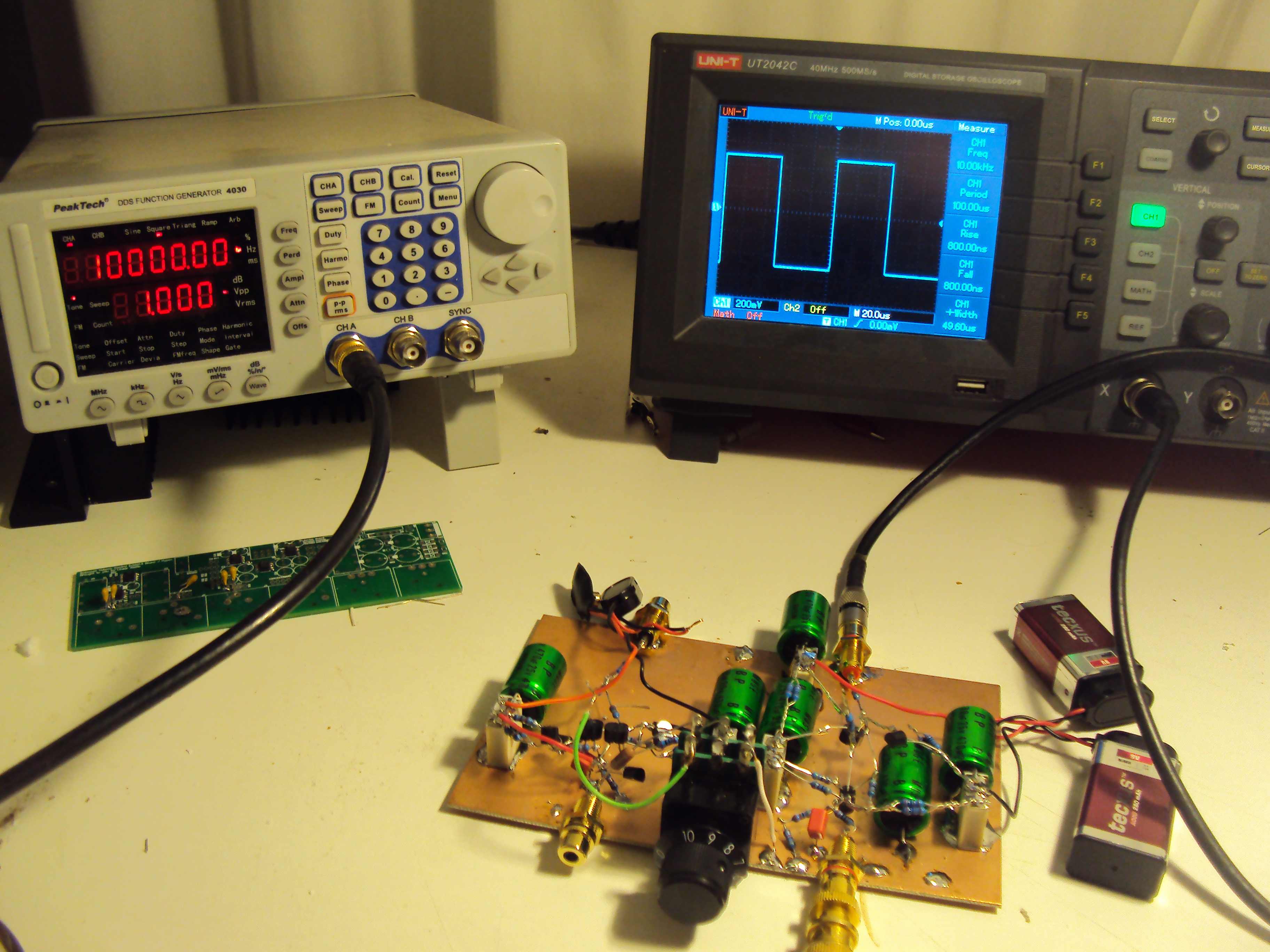

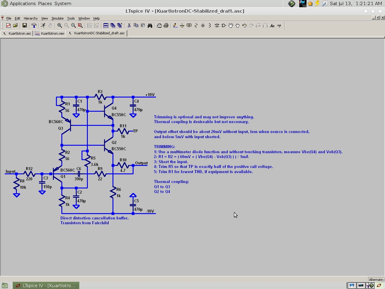

I have build one channel of the buffer now and it worked right away.
At the moment i use it without trimming. Voltage at the test point is 5.7V and i use 9,3V batteries. That shows in slight asymmetric clipping, the positive voltage clipping first.
Instead of 56 Ohms i am using 47 Ohms because i had them.
DC offset at the output is 1.5mV. Offset at the input only loaded with 100kOhm is 75mV.

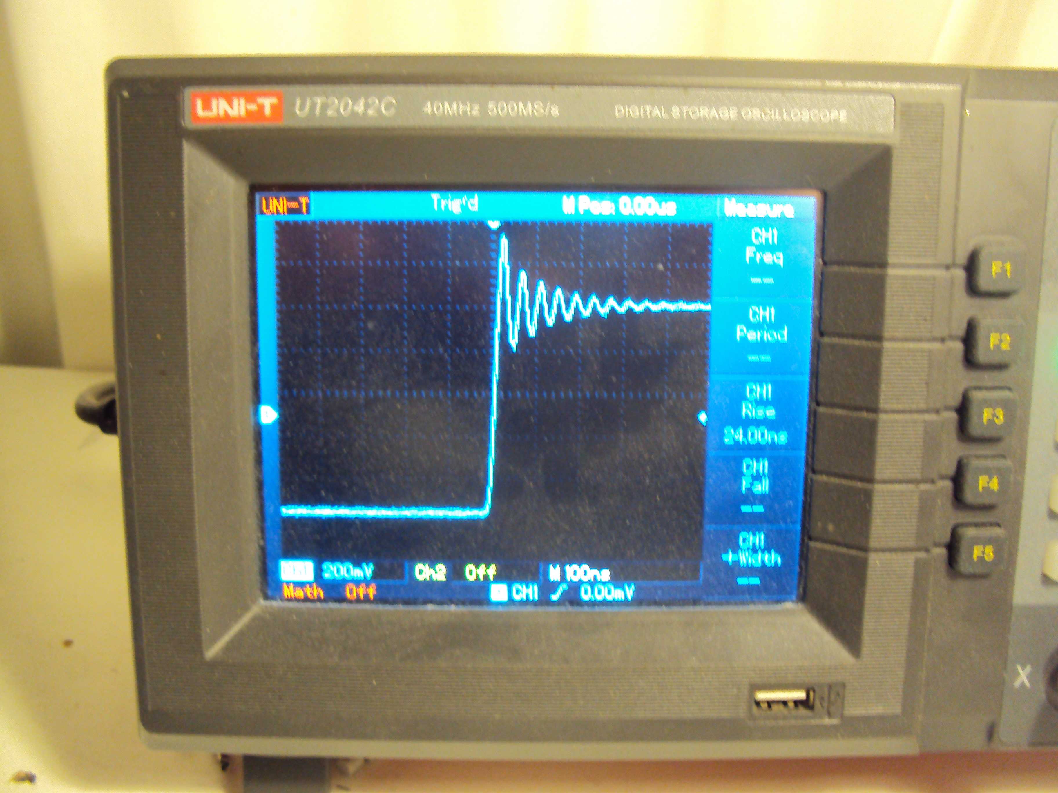

That goes down to under 1mV when i connect my generator that has 50Ohm output impedance. The circuit had considerable overshot on a square wave, even with snubber.
I have then added a 220 Ohm, 150pF lowpass. Now it looks fine.

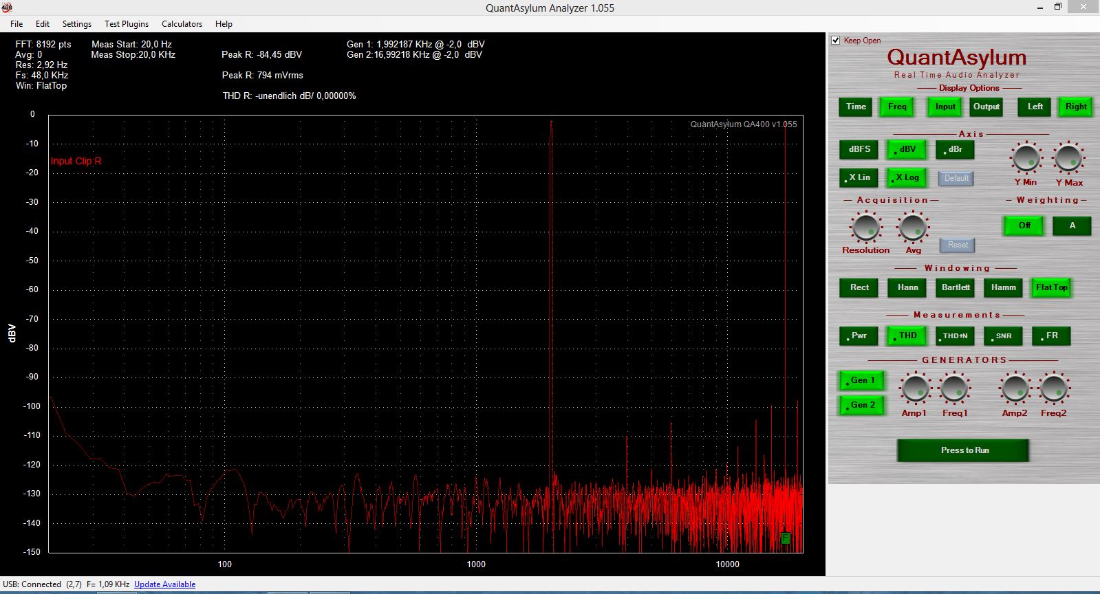

I will measure now distortion.

I would not add the jfet CCS until after I knew I had hit the limit of the original circuit, if I needed even less THD. It may help if there are quality control problems but that does not seem to be the case.

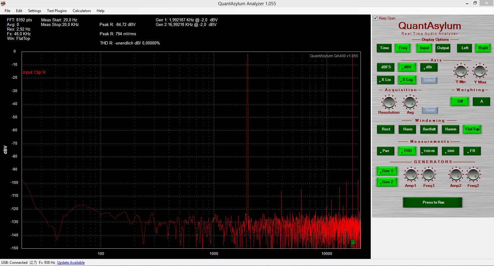

I measured the input signal with left channel, output signal with right channel. Then I use Baudline to subtract one from the other. It gets rid of lots of stuff, so the noise floor is surprisingly low.
For this soundcard at least, left and right channels are very well-matched.

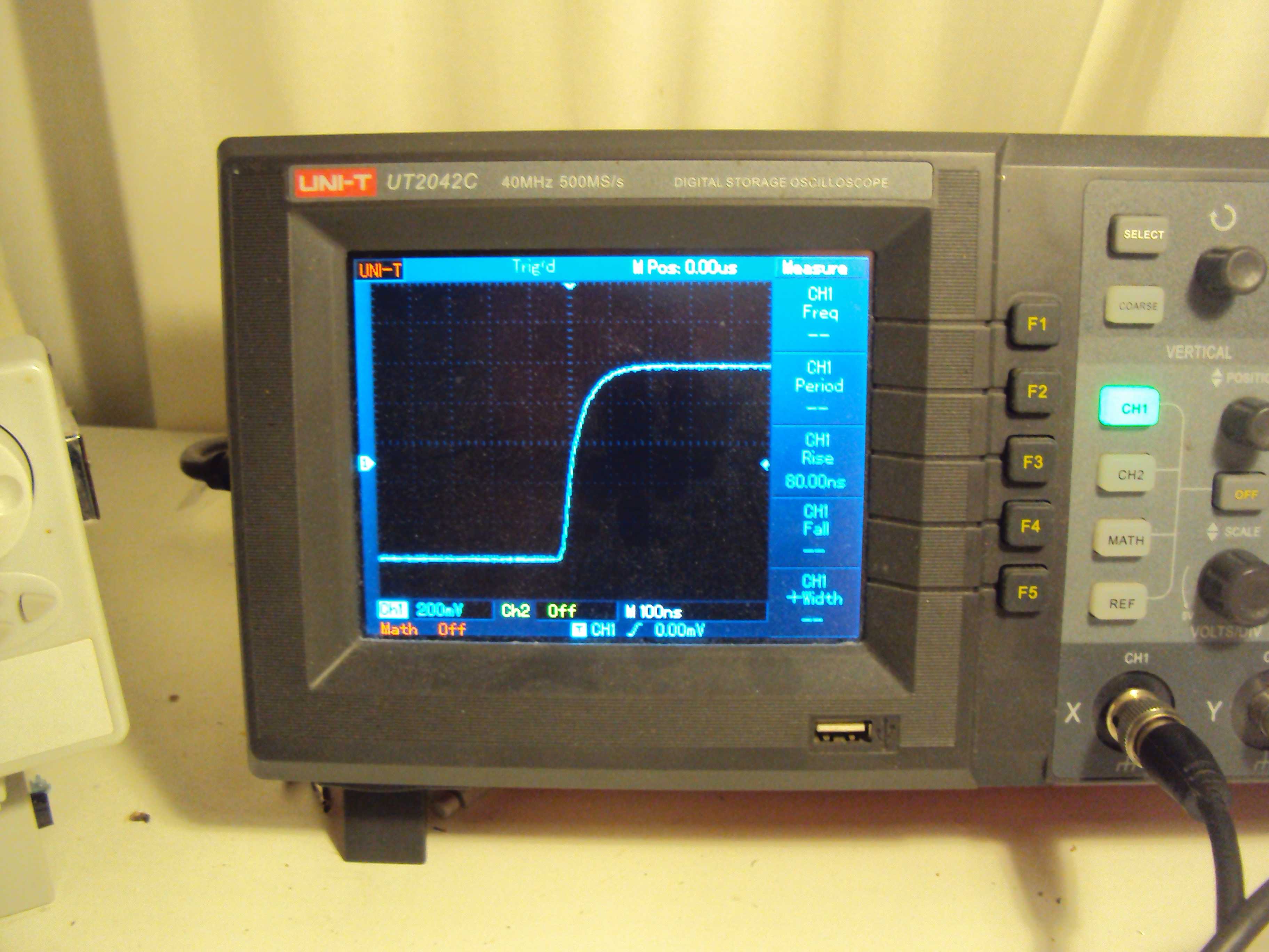

Here is the square wave response with and without the input filter plus closeups.
Joachim, I don't like to see the ringing but it is actually a natural consequence of the output inductance of the buffer resonating with capacitance at the output. All amps do this, without some sort of snubbing scheme. That's what compensation is basically, the trick is to find the most benign snubbing scheme. I've spent the last few years trying to understand this sort of thing.
This is what I came up with. It should be phase-linear with up to 1nF at the output, enough for any signal cable hopefully (lol!). There should be no ringing on small-signal square waves, which is where the music is.
I haven't been able to test it but I can't find a reason why it won't work. I think I might try it tomorrow if the stars align.
I wish I could delete that last schematic. That actually applies to the BC337-40 version, which is easier to stabilize.
I only recently learned about this specific kind of compensation so when I decided to post this buffer, I hadn't thought to stabilize it this way. To try not to waste any more of your time, here is a convenient schematic. You magically have already installed the 220R/150p filter. All you need to do is put in C6 and R9. That hopefully will stop the ringing, rather than just putting it in quarantine.
