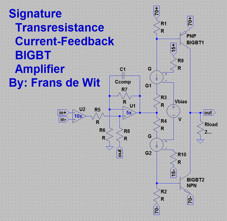

Super quality build... maybe you could give us a hint on the basic topologies used.....
O.k. here it is :) one 'Transresistance CFB BIGBT Amp, By FdW'
