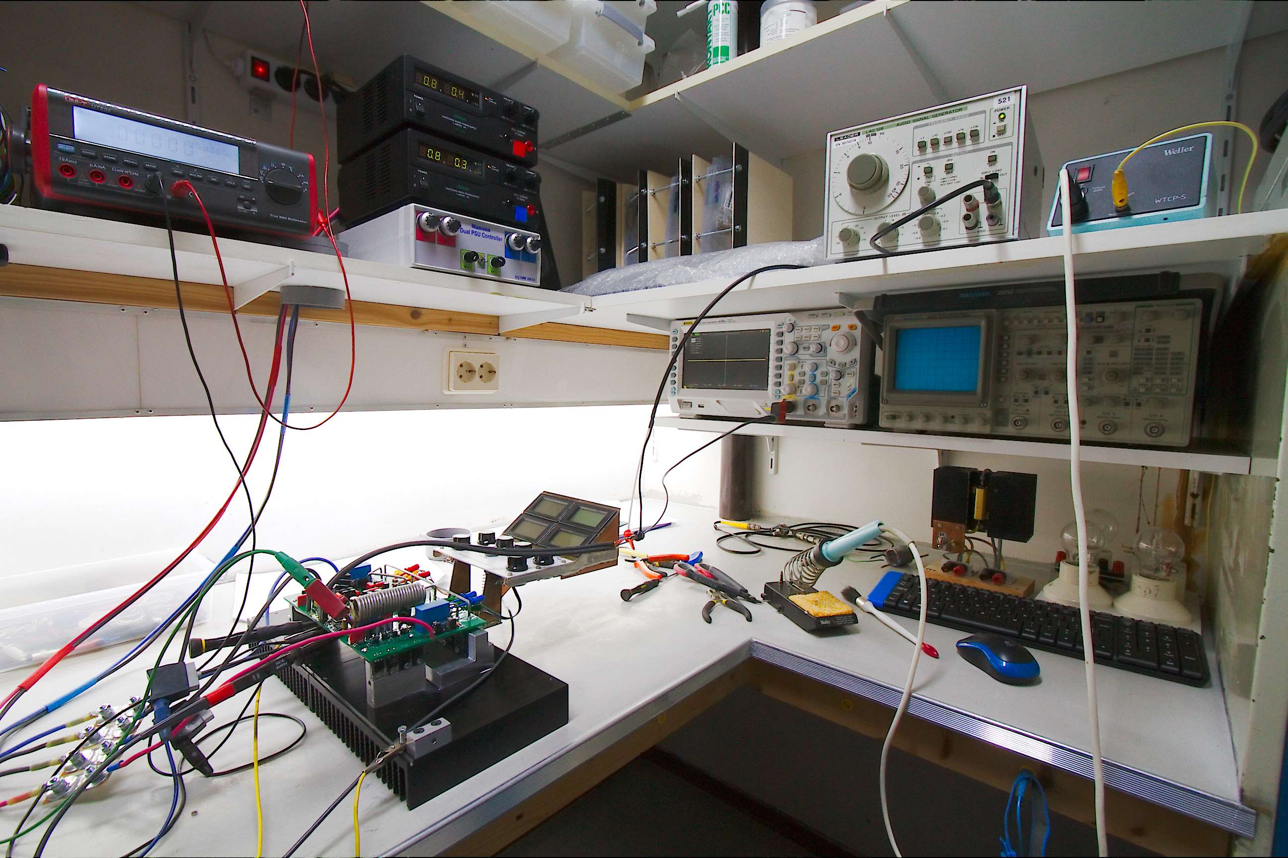

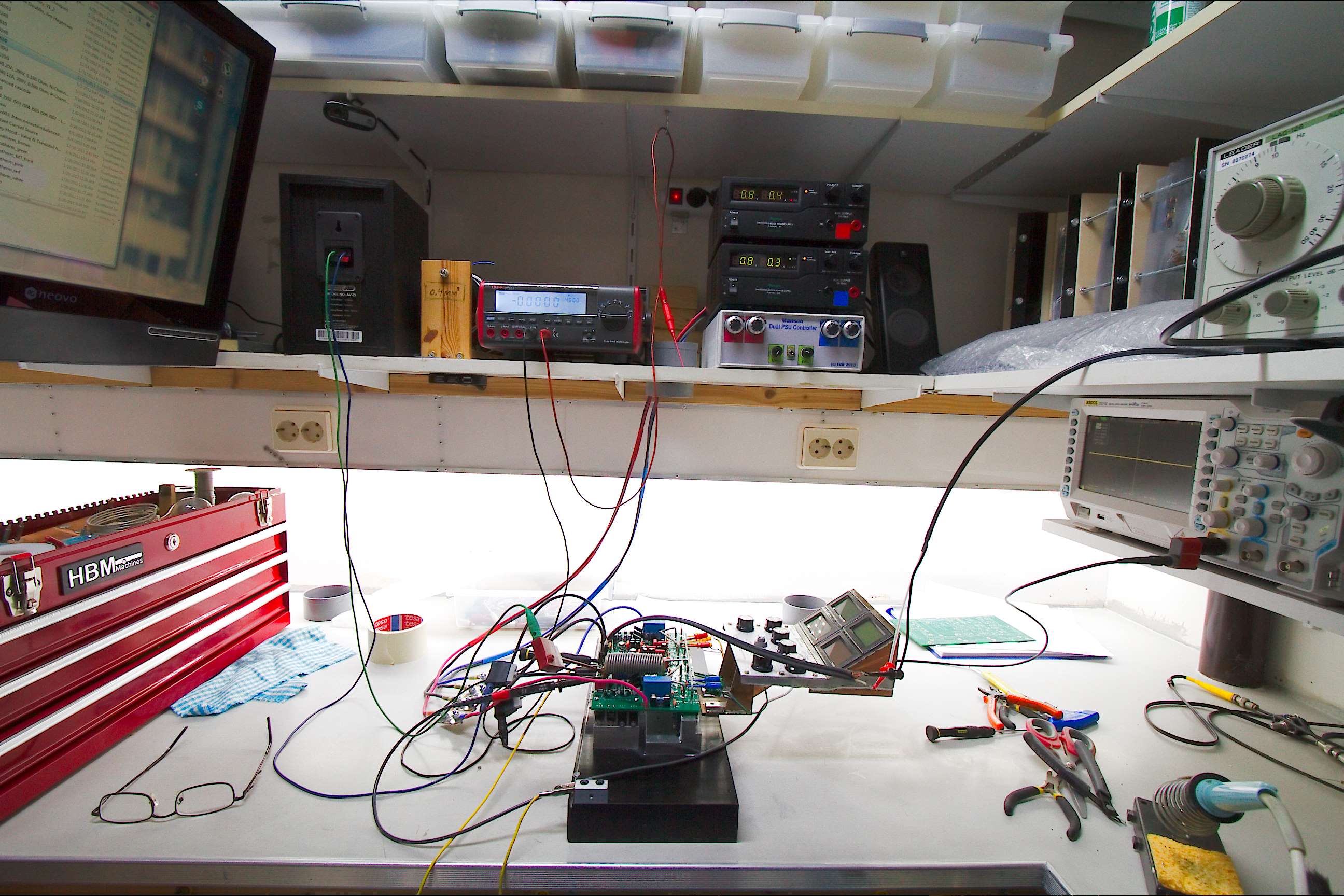

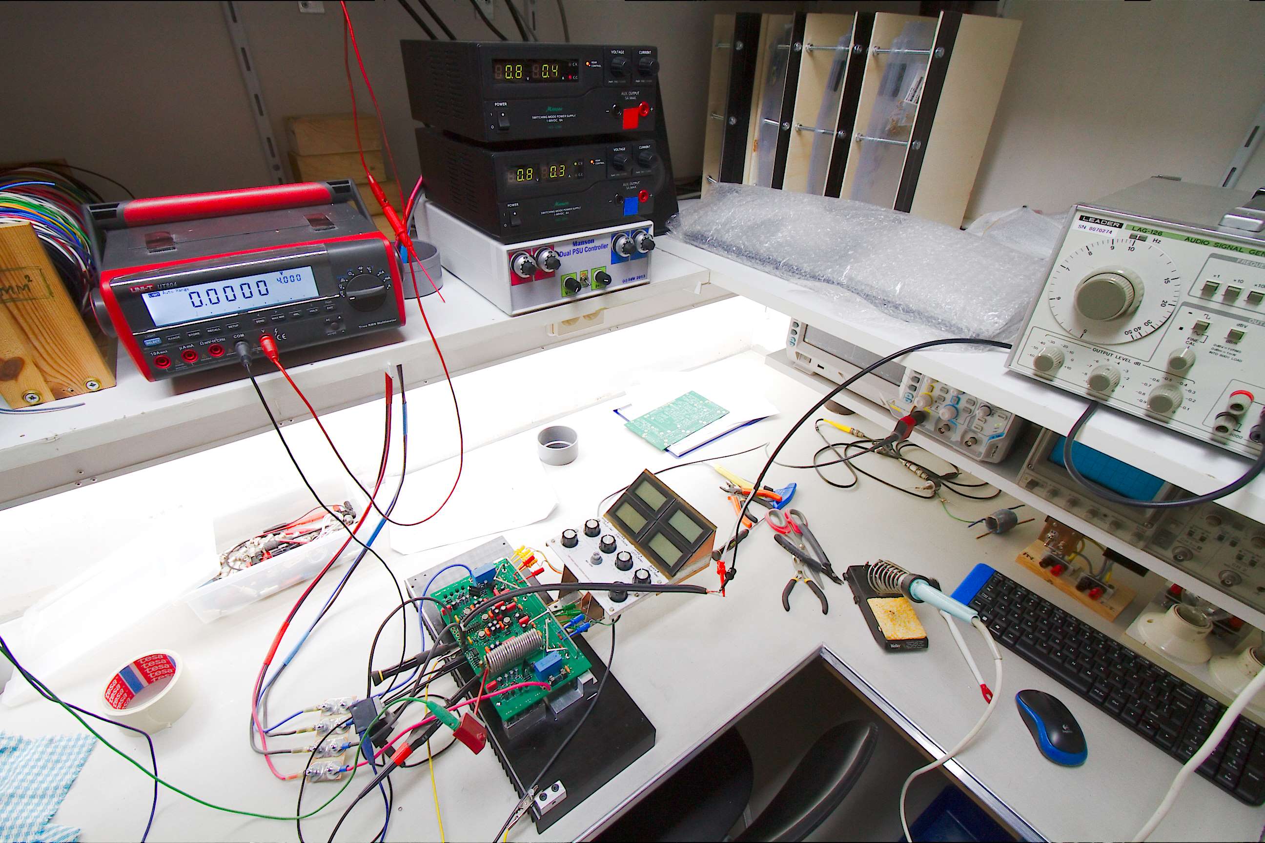

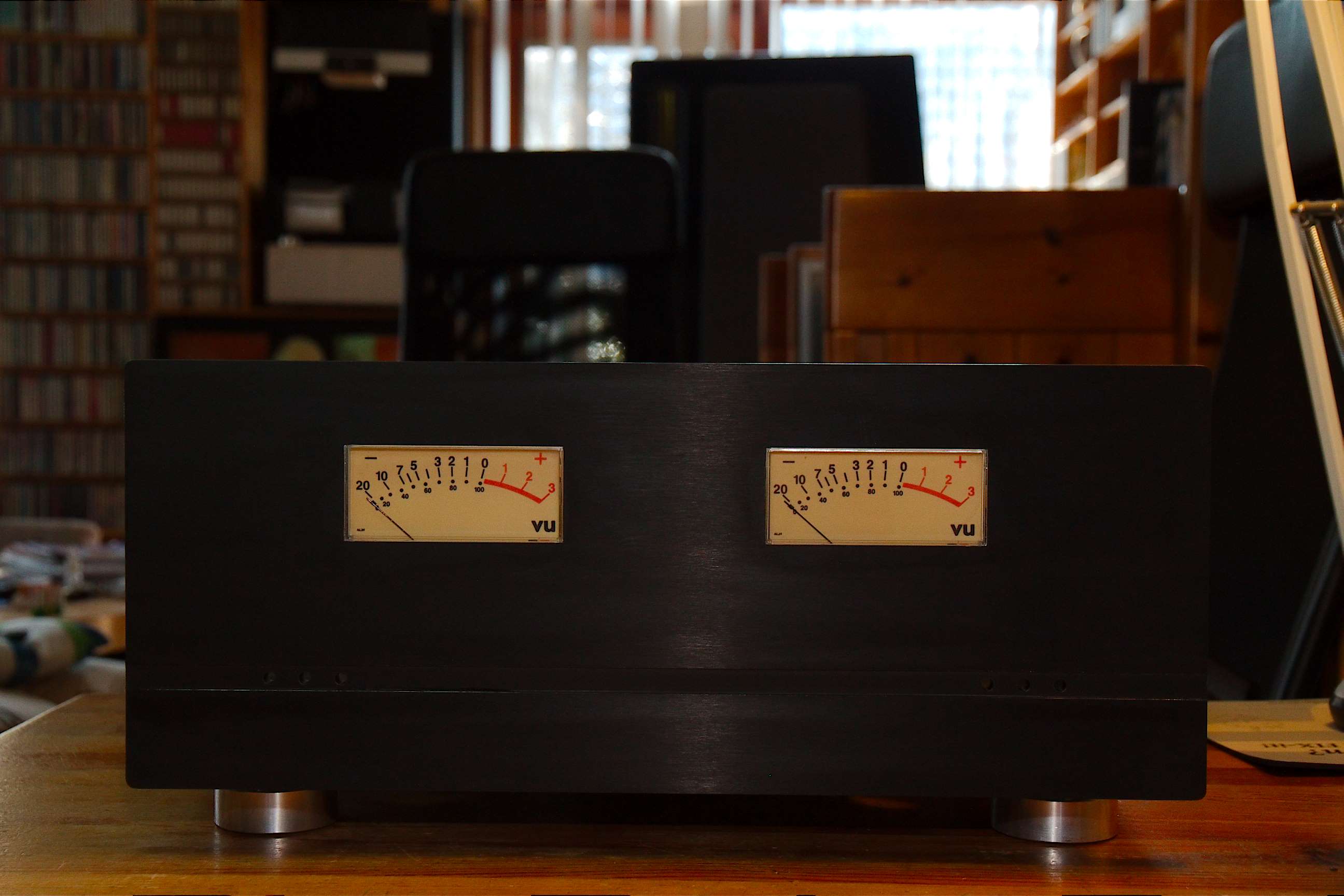

Here a few pictures, to show that the amplifier truly exists :) also the new laboratory now equipped with ESD floor and workbench.

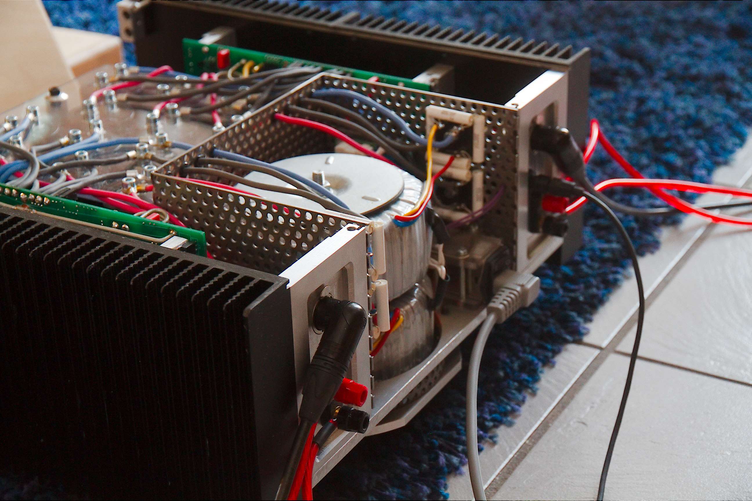

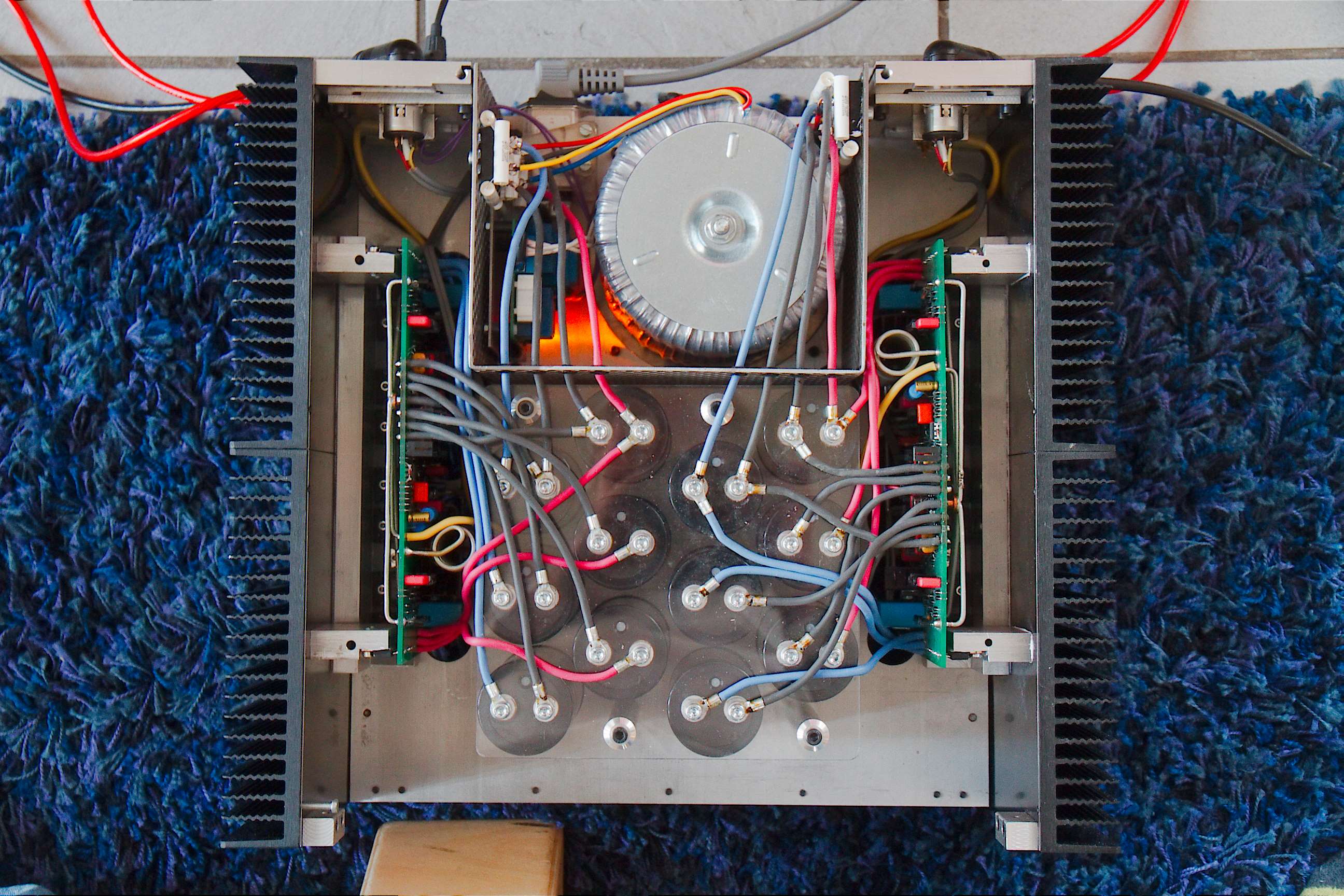

Envious of your lab Frans...so clean and tidy! Also very impressed with your amplifier design. Can you explain the grounding arrangement of the large filter caps? It looks somewhat unconventional.
There are 3 star's +70, -70 and ground, these star's are on the board, and that is where the capacitors connect (and every thing else). This thing is unconventional :) and designed to be unconventional.
I'm curious if connecting that first filter cap in each case via bus bars to the others would result in a reduction in rectification (100/120Hz) noise. Usually I have found that directly connecting those "noisy" nodes from the rectifier to the stars is a bad idea. I'll be following your progress closely! :)

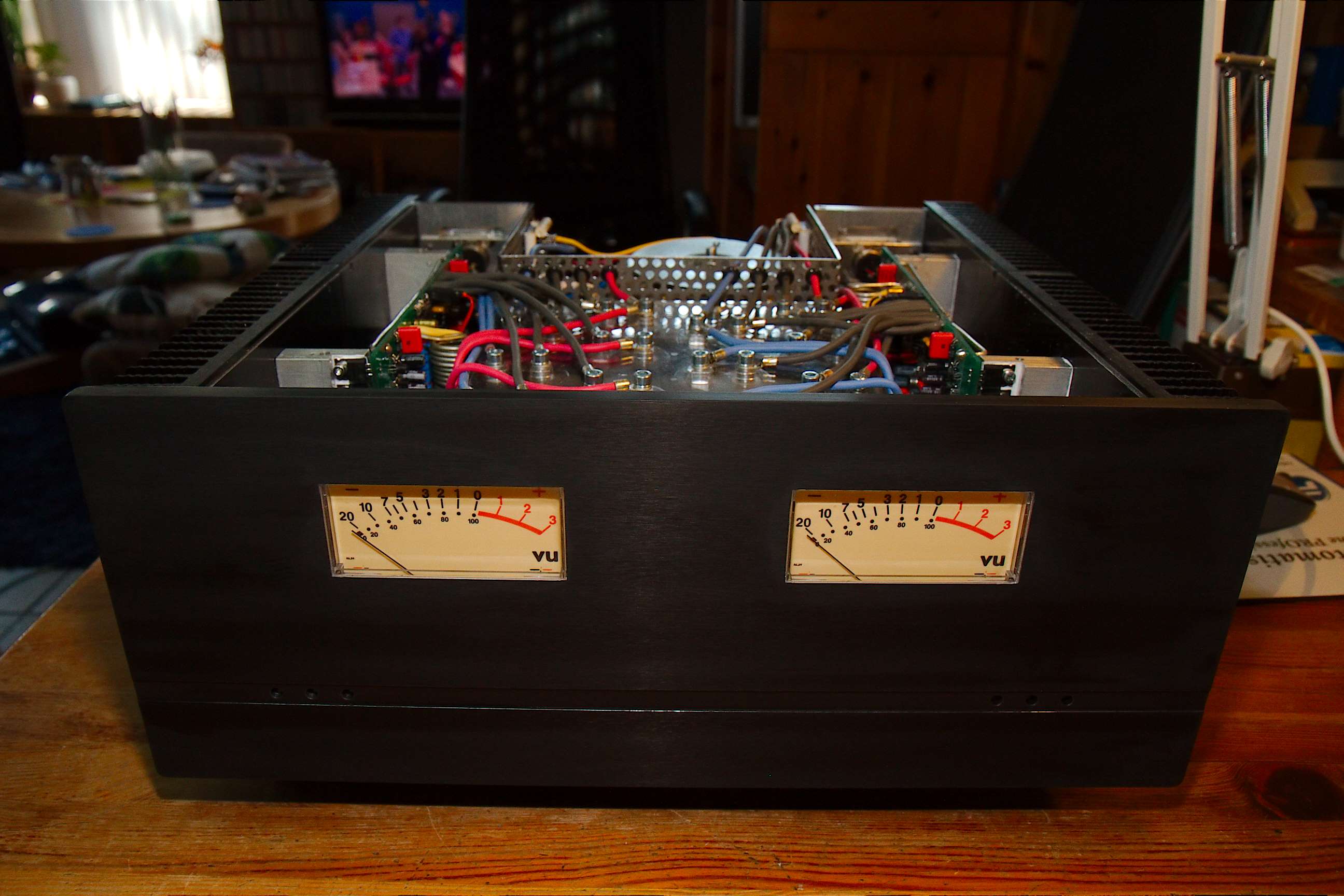

Very nice lab space, very cool builds. Those VU beg for tear down and FDW in deville font printed on their clean space. FG to 0.5MHZ only? 0.005% THD alright but some faster pulse edge would be needed in the future...
The imprinted text will (most probably) be this:
Signature Transresistance Current-Feedback BIGBT Amplifier - Frans de Wit
With thanks to 'Lazy Cat' :) (also note that this is not a SSA or comparable design)
