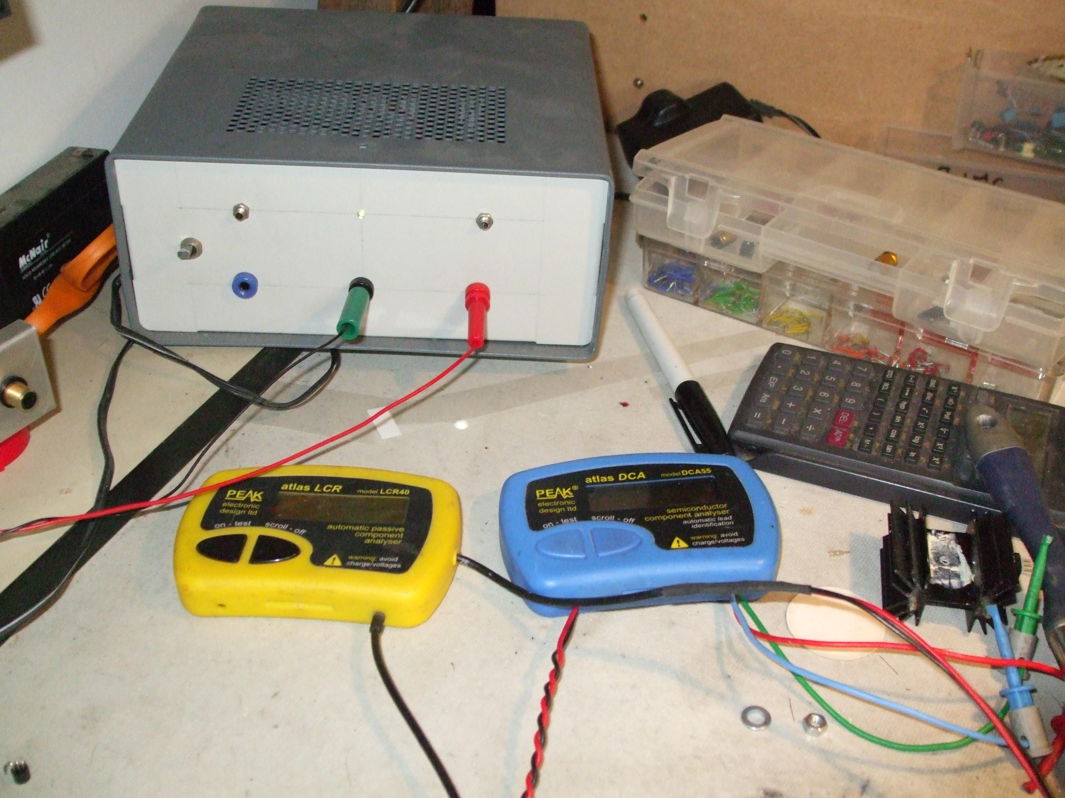

Red and Black vires conected to a 317 set at 12.5 V and soldered to the inside batteri clips works even in the midle of the night when batteries shoop is closed.
