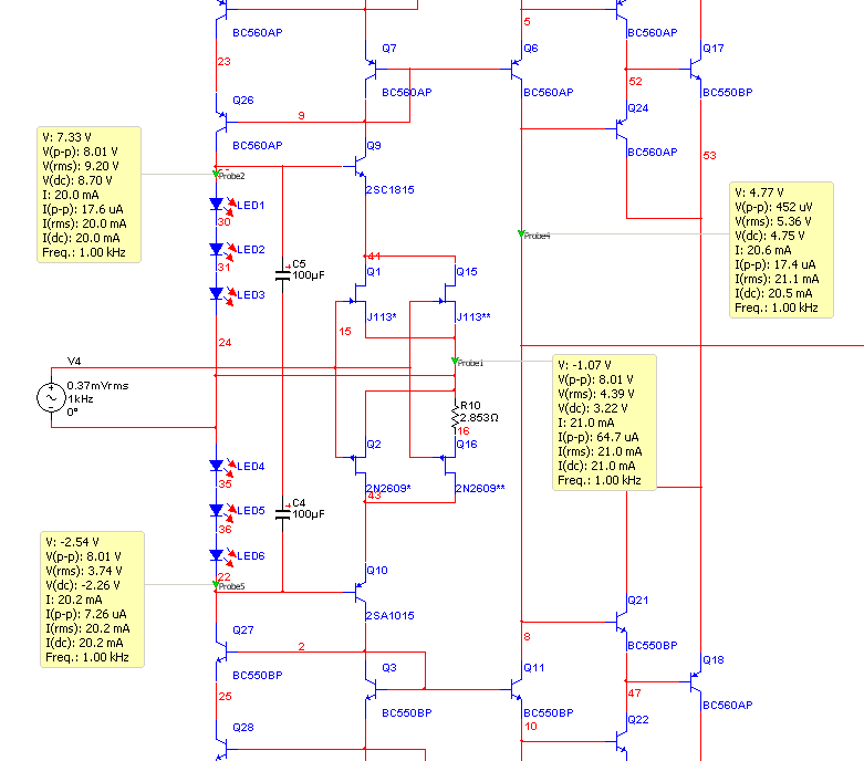

Ok, I have to do some catching up here. Circuit in post #5083 on first glance has same problem, T19&T21 with T20&T22 forms high impedance ccs'es and currents are lost again. Will put it in sim to check first. Post #5097 looks promising, were do bases from T19&T21 goes to ?
