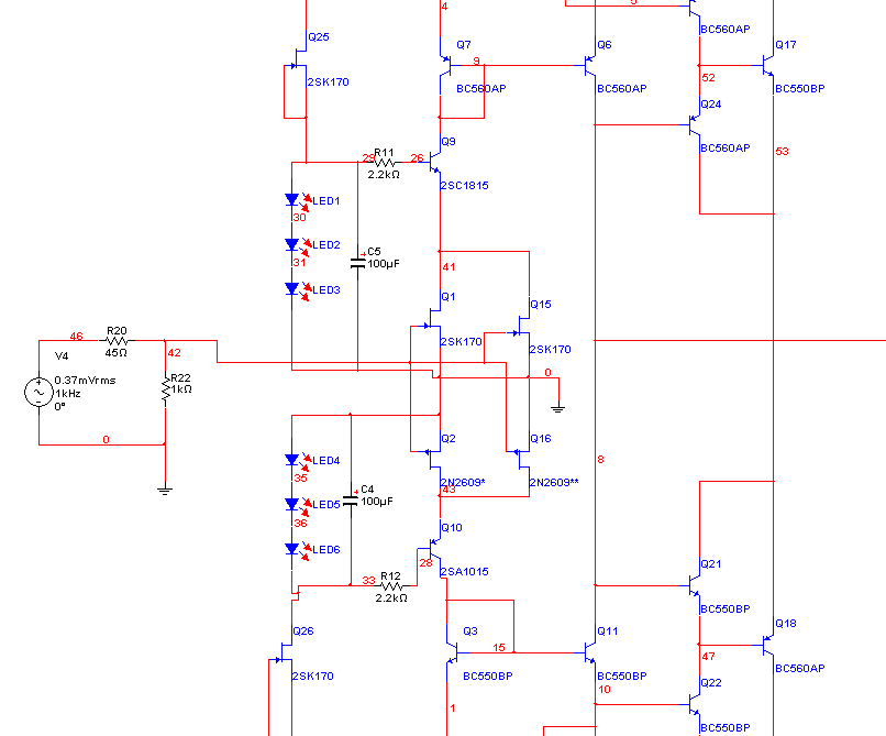

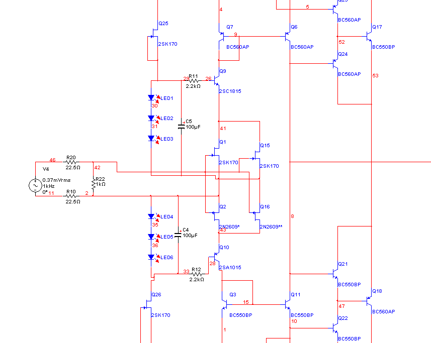

Yes, that is what i just wanted to post ! This is then a floating load. Without the resistor the cartridge is its own floating load, terminated by the low impedance of the negative input, weird. Anyway, a floating resistor would make sure that the Fets conduct, even when the cart is not connected.
This looks good Joachim, but I'm afraid I already tried this arrangement and if my memory didn't froze over the day from this weather we are having here there was something fundamentally wrong with it. If I remember correctly fets sources were just swinging in phase with a source without any reference to ground, but I may be confusing something here. Let me put it to sim and get back to you. Or even better, I can try it on real proto.
ok, it doesn't work without cascodes in proto (LF oscilation modulated by input signal with gain on fet's sources, same thing as I tried some time ago), but if I'm getting this right now, cascodes IS the key. Time to build some. I'm assuming some low current K170 instead of "High Impedance Current Source" in your schematics would do for experiments ?
Sure, they can be casdoded with J310 and then we are in the several tens of megaohms range. The sources of the Fets have to drive the bases and the current source. The higher the impedance of the current source the more drive goes into the bases. For testing one low current 2SK170 is fine.
Mhm, now I got it, cascodes with symmetrical ccs'es are making reference for signal, it should work without any resistors to ground. They are kinda in signal path, but that can be taken care of by making extremely good ccs'es. Or even better, we can put them inside mirrors and replicate that MiiB's auto biasing part (that I really like). Then servoing it and voila - dc coupling. Damn, group thinking is such a powerful thing

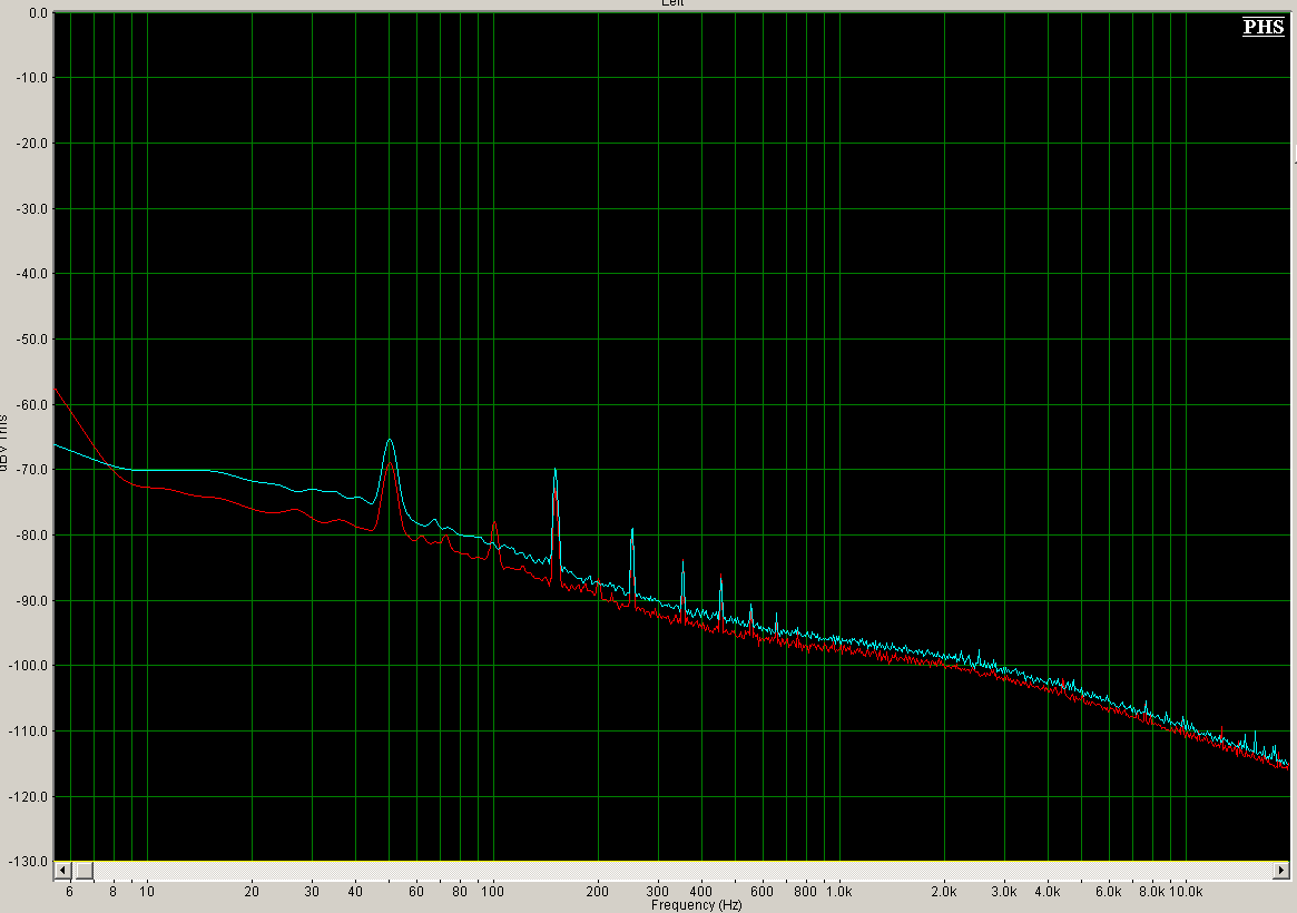

Ok, it works like a charm ! But I don't see any common mode cancellation Attached fft of 2 matched channels, red - balanced, light blue - se. Have to make some balanced measurement setup later, so this is only same cart channel connected to aether input. So much for today, I'm out

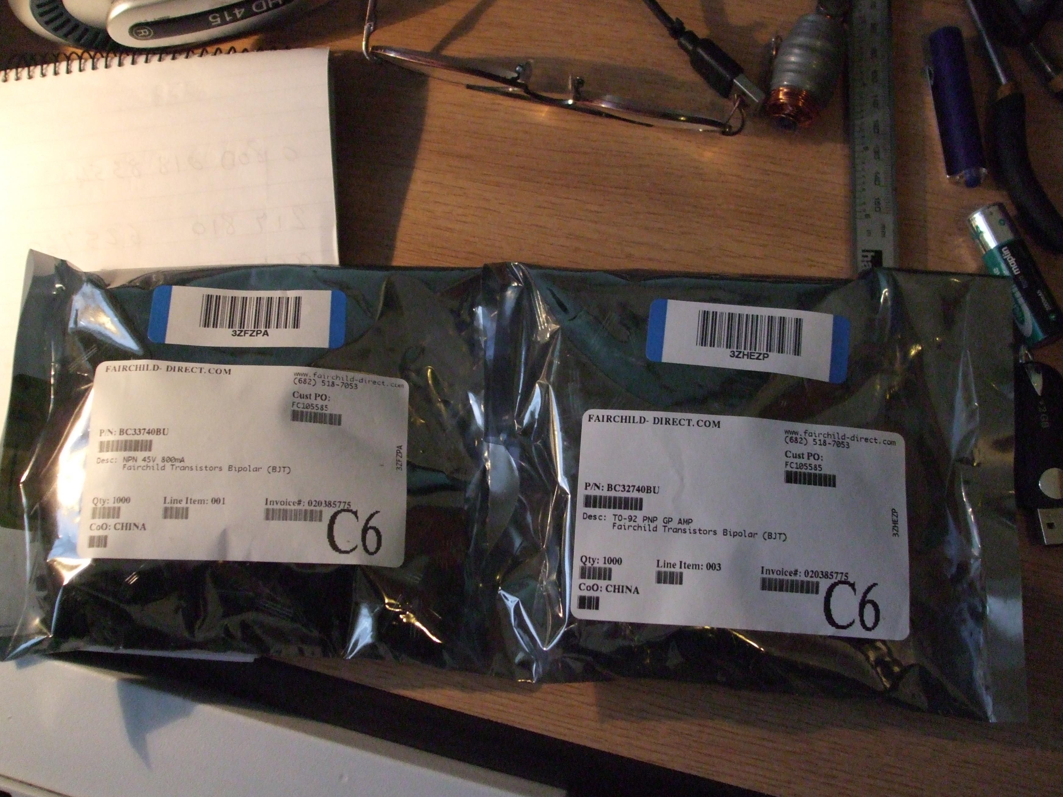

I got a batch of the BC 32740 and BC33740 direct from Fairchild Direct
Farnell does not have the 40s and
Onsemy does 16 and 25
Multycomp is I believe a sourche from multiple alternative manufacturer copies
Frans posted a realy decent link to his suplier and I would suggest you look there first.
Any way
I will start matching soon.
