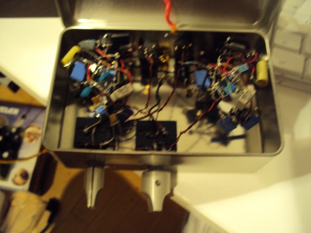

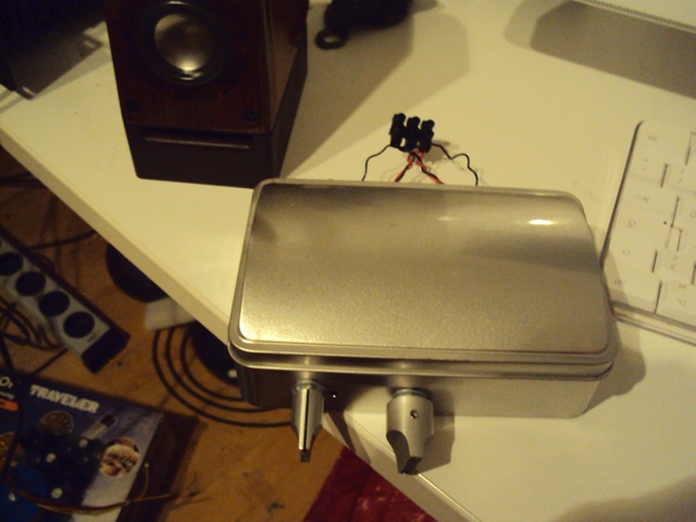

Hi Frans,
just found an appropriate case for my Paradise - ATL modded. Hope the ATL approves the looks! ;-)
Way cool the man at the ATL have taken the day off for beer and women just to celebrate the discovered housing, they love it too
'Area 51' the amazing numbers

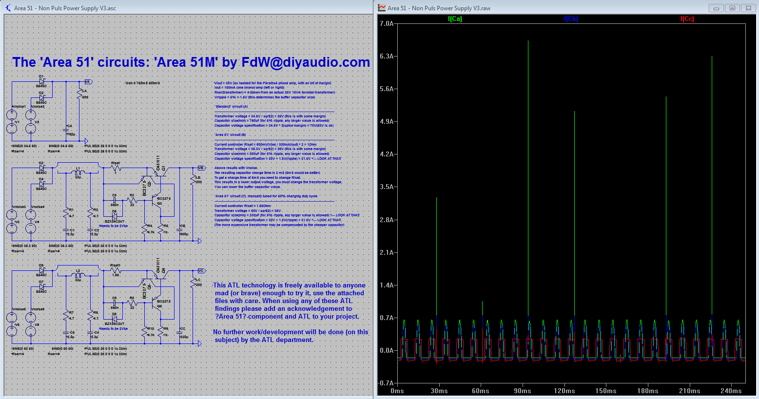

Just before the man at the ‘Alien Technology Laboratory’ went off for a free day (they really like that enclosure) they came up with some practical (it’s just a word they [people I know at ATL (always dressed in black)] say ) numbers for the ‘Area 51’ circuit (it seems that they (the ATL man) also read this forum and found the Bksabath posted message).
Any way here is there text:
This ATL technology is freely available to anyone mad (or brave) enough to try it, use the attached files with care. When using any of these ATL findings please add an acknowledgement to ‘Area 51’-component and ATL to your project.
No further work/development will be done (on this subject) by the ATL department.
Vout = 30V (as needed for the Paradise phone amp, with an bit of margin)
Iout = 150mA (one (mono) amp (left or right))
Rser(transformer) = 4 (taken from an actual 25V 15VA toroidal transformer)
Vripple = 5% = 1.5V (this determines the buffer capacitor size)
'Standard' circuit (A)
Transformer voltage = 34.5V / sqrt(2) = 25V (this is with some margin)
Capacitor size(min) = 760uF (for 5% ripple, any larger value is allowed)
Capacitor voltage specification = 34.5V * 2(spike margin) = 70V(63V is ok)
'Area 51' circuit (B)
Current controller RIset = 600mV(Vbe) / 300mA(Iout) * 2 = 1Ohm
Transformer voltage = 36.3V / sqrt(2) = 26V (this is with some margin)
Capacitor size(min) = 800uF (for 5% ripple, any larger value is allowed)
Capacitor voltage specification = 30V + 1.5V(ripple) = 31.5V <--- LOOK AT THAT!
Above results with Vnoise.
The resulting capacitor charge time is 3 mS (5mS would be better)
To get a charge time of 5mS you need to change RIset.
This results in a lower output voltage, you must change the transformer voltage.
You can lower the buffer capacitor value.
'Area 51' circuit (C). manually tuned for 50% charging duty cycle
Current controller RIset = 1.65Ohm
Transformer voltage = 50V / sqrt(2) = 35V
Capacitor size(min) = 330uF (for 5% ripple, any larger value is allowed) <--- LOOK AT THAT!
(The more expensive transformer may be compensated by the cheaper capacitor)

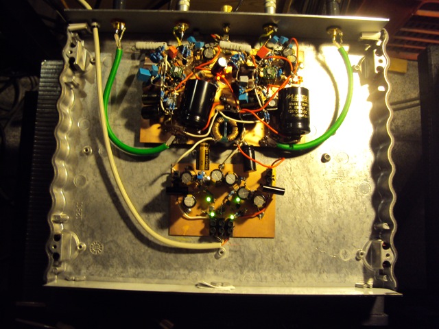

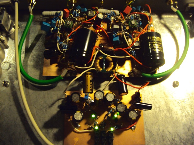

Ricardo, i made some calculations on the high pass that is formed by the electrolytics.
One is for 2 x 4700uF and one is for 2 x 6800uF. Response is down -0.013dB at 20Hz in both cases. See the Group Delay for the 2 x 6800uF case and also the impulse response.
Thank you Joahim
These graphs are very important so I can visualize what will happen when tuning this part of the circuit.
My caps are too big so I will have to place some under the board
Soldering parts is a breeze... The boards are very good indeed
I guess I will have the boards populated in the end of the week.
Yes, the board solders well. It is even fun. Lets see who wins the competition and makes it work first. I am not the one. I am too busy with other things and i do not want to rush it.

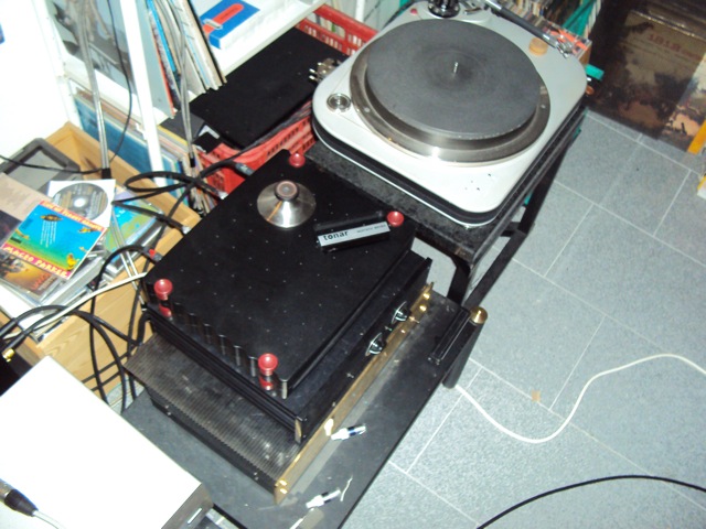

This is more interesting.
Photos of my current vinyl setup, the high speed pre and the JFet NFB phono.
