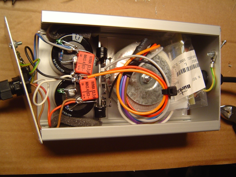

and here is my external power box.
on the right is the input EMI filter (in the plastic bag), a toroidal transformer with 2x24V, full bridge rectifier made with FFPF04N60S2 from Fairchild, followed by two inductors and output caps 10mF+3.3uF.
no-load voltage is 38V.
No, I haven't connected it to the boards just to see what happens ;-) I'll leave that for monday when I have current-limited lab power supplies....
