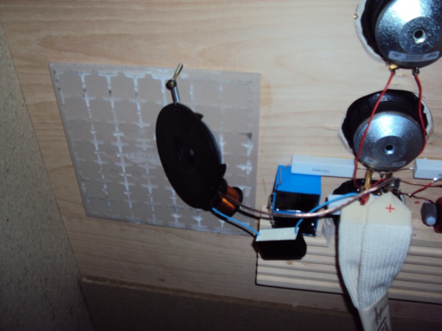

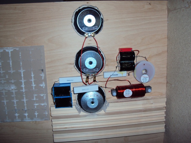

I got the second one ready and i am listening since half an hour. What i hear is good but somehow this version does not have the lifelyness of the single driver version. Somehow i expected that because energy is now shifted to the lower reaches. I thounght about a solution. Actually i was prepared in my mind. i had heard the Linkwitz Orion in Siegfrieds house before the Orion plus modification and although it had a very attractive and natural sound i missed some life and exitement. It was like listening to a lower colouration and much better imaging version of a clasical Spendor BC1 one but with that typical ( for a european ) robust american bass. Well, the bass was not boomy at all but i missed some timeing information. When i came back into Siegfrieds house he had added the rear tweeter and was still experimenting with level. The transformation was astounding. Even better depth perpectives and a much more transparent and lifely sound. I thought that could be the solution here too. In my collection i have some SEAS 19TFF1 tweeters that are much underated. I see them seldom in commercial products but with an extention up to 30kHz and a very flat response from 1kHz on i can find nothing that could explain that. Add the low cost and you have a nearly perfect supertweeter that costs very little. Sensitivity is 89dB and this is perfect for an add on of the Mini MPL. They have a sensitivity of 86dB but beeing a dipole the room helps out and we land in the correct ballpark. I simply istalled the 19TFF1 in the back on some springs aproximately at the height of the midrange driver slightly on the outer side and firing a bit out. As you may have guessed when i build a spaeker for myself, i use measurements only as a guideline and use intuition, experience and my own ears instead. I have to please no one. This is my privat speaker. I use a second order crossover without resistor and from an energy point of view they blended perfectly well. I use them in revers polarity and that seems to be the right way to do it but because i have the tweeters on aligator clips i can play aound with phase too. I will post a photo soon and will have more impressions concerning the sound.
Here is a photo of the arangement i use. You may ask why i just put the tweeter on the back in open air without a baffle. This will give some conciderable combfiltering. Well, this is exactly what i want. I follow a diffent philosophy here that is not similar to what Linkwitz or for that matter even stronger Kreskovky does in his Nao Note. I do not want that the back radiation is a 1/1 copy of the frontal radiation, just of oposite phase. I owned speakers like that, for example several Quads and Appogees. The problem is that they do not work well in smaller rooms. The Quad is less critical here then the Appogee because it has some damping of the back wave and is not a linesource that needs the far field to work. Anyway, my room is 28qm and this is around the upper range of a typical sized german living room. I was at many customers and few had rooms bigger then 30qm. Provided now you put a dipole in that room that has the same radiation on back and front there is a good chance that the back radiation hits the backwall somewhere and when that refexion is not damped you get a second time delayed phantom immage. The result is a sound that is more difuse then a sound that whould cary immage information only ones. In fact a have a pattent that contains the appication of phantom images that cary the imaging information and not the direct radiation so i know how strong information content in single reflexions can be especially when they contain higher frequency energy. The original Quad ELS57 had the backwave damped in the treble to avoid imaging problems in smaller rooms.
For me that is also not the way to go. I want that the radiated energy is the same on the back and the front of my speaker but only the front radiation carries time coherent immaging information. In fact the frontal frequency response of the mini MPL is slightly difuse field equalized. The frequency response between 10 and 20Khz is slightly lifted to compensate for bundeling of the front driver in that aerea. I then cross the baffles some 30cm before my ears. Ted Jordan gave an excellent explanation why that is beneficial. He found that this arangement gives a stronger focussed sound and a wider sweetspot. The radiation on the back of the BMB Mini MPL with ambient tweeter has a good tonal balance ( tonal balance sounds good when i hear from the back ) but is not correlated in phase with the front radiation especially in the area over 1kHz where imaging information is. The result is a speaker with excellent image focus. When i switch on the ambient tweeters the sound gets more lifely and depth perspectve is even better rendered. In fact the Mini MPL BWBA ( bass-wideband-bass, ambient).

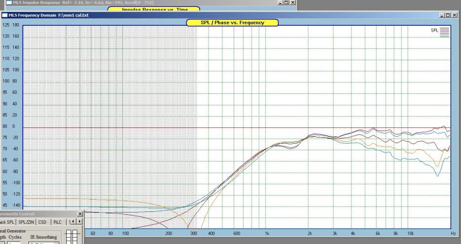

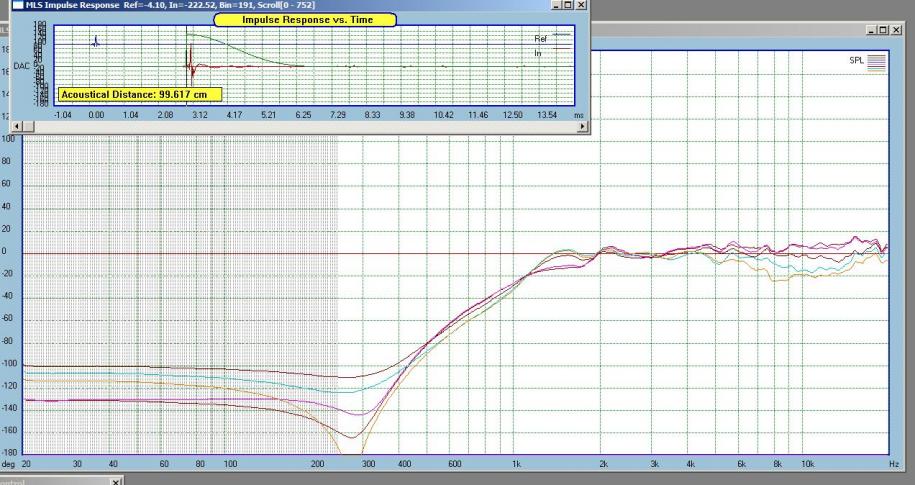

I use the horn Ribbon out of two reasons. First at the crossover frequency of 8kHz i use the wideband has already a slightly restricted radiation pattern and the radiation pattern of the Horn Ribbon that looks very similar to a waveguide fits the wideband better. That slight beeming that goes constantly up with frequency makes the MPL focus really well. I compensate the energy loss at higher frequencyes in newer versions with an aditional backtweeter, see the Mini MPL. The energy at the back of the MPL needs to sound the same as the frontal radiation and i slowly develop a theory how that response has to be shaped.A linear freefield response is not right because the ear has a diffent sensitivity for frontal diect incidence and sidewise difuse incidence. See Zwicker
at.all. for more information. So far i am only listening by standing some distance behind the MPL and then walking though the pair and listen at the listening seat. It is important that the back radiation does not create and aditional phantom immage like in a conventional dipole. This is empiric research at the moment and when i get the optimum subjective result i will measure and do the thing all over again. Listen-Measure-Listen-Measure at infinitum until i get a more or less consistent reading. That may then be only true in my particular room and setup, hence the tittle MPL. My Privat Loudspeaker. The other reason i use the horn that is has some timedelay that by coincidence perfectly fitted the delay in the wideband cone so i got a nearly phase cohrent result with only 3 components in the crossover.

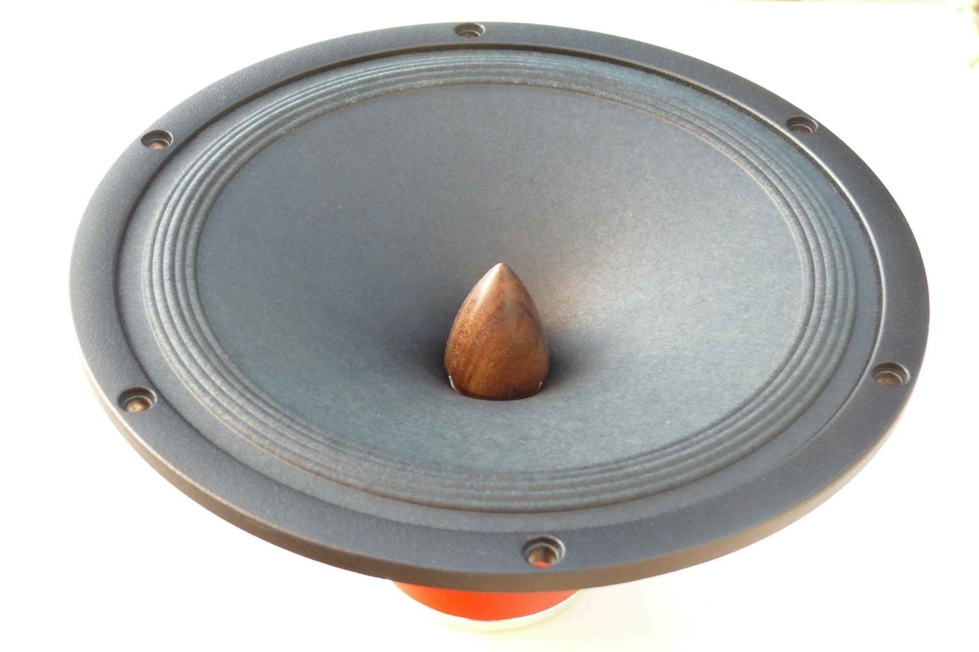

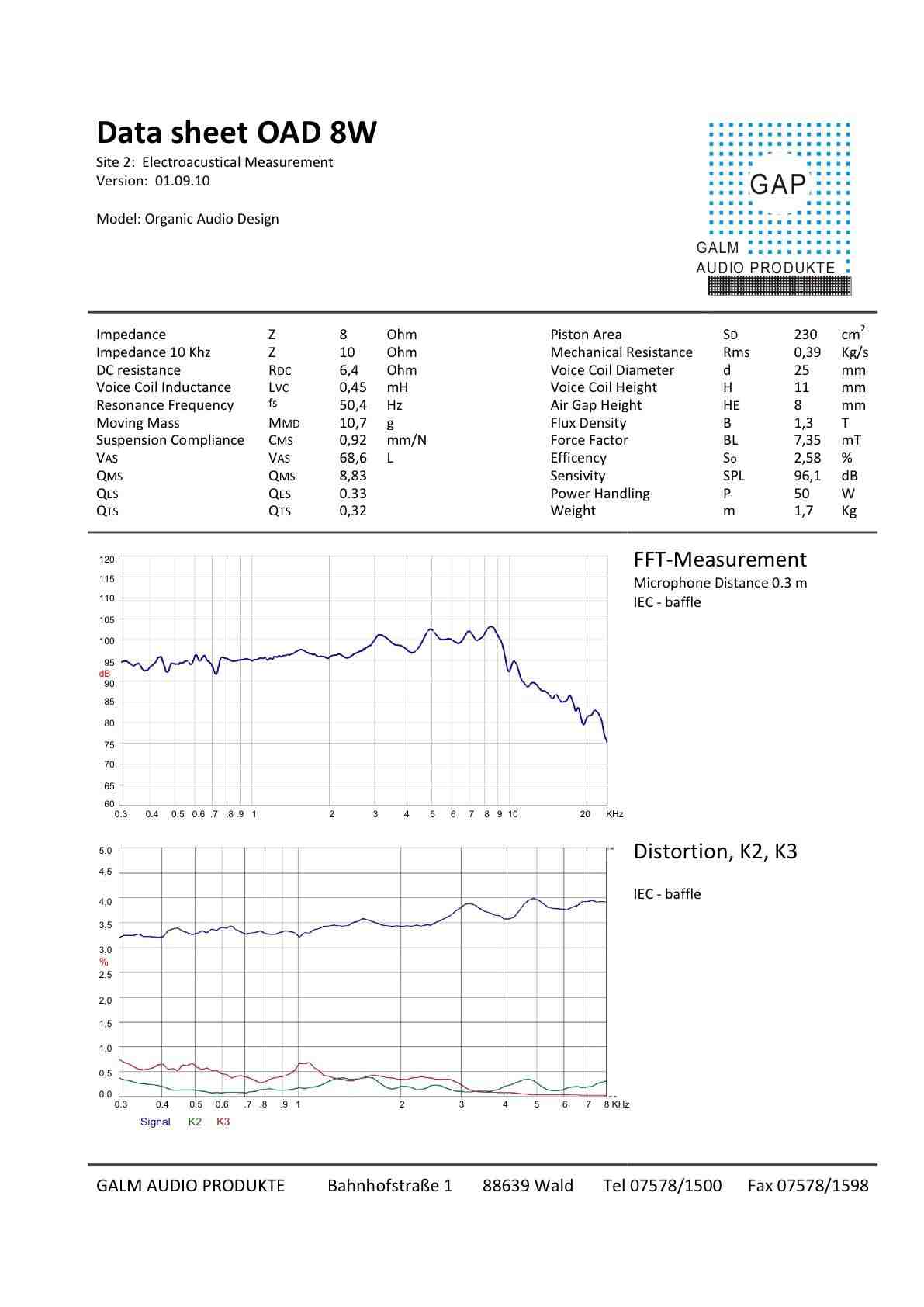

The 8 inch wideband driver is ready and availlable ! We make it only with Alnico magnet because that works best. One version has a wallnut phaseplug and one version has a maple phaseplug. I will publish measurements and parameters soon.
Veeery nice !
But this: "We make it only with Alnico magnet because that works best" - not nice $$$
Where are they going to be available ?
Send me a PM. We tryed Neodymium ( ferrite is really not an option any more today ) and it will not make the driver much less costly. It is all hand made by the designer. We do not know any driver that is better. Especially distortion is so low that it is a challange to measure. A typical electret microphone is absolutely not good enough so you need a laboratory grade condenser.

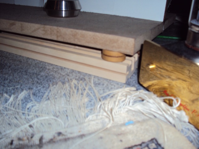

Again i did some improvements to the MPL baffles. First i am now using the Bönicke Swingbase to decouple the baffles from the floor. I had done experiments with decoupling in recent years too and was very surprised that Bönicke had a product that he was showing on the High End in Munich that uses a different principle but gives aproximately the same result. I had used Squash balls in a sand bed to decouple the Sonics Allegria 2.0 from the floor. With an accelerometer i could measure much less vibration on the wooden floor of my friend that owns them and the other surprise was, that the speakers themselves resonated much less too. I was never reallly confortable to spike speakers to the floor because i think the argument that this forms a "mechanical diode ( Goldmund blurb )" and evacuates the vibration from the speakers is simply not true. In fact that resonance energy makes the floor shake and a lot of that energy reflexes back into the spaeker cabinets where is it again transfered to the floor AD
INFINITUM. Isolating the speakers from the floor by "floating" them on a squash ball cradle or in the case of the Bönicke Swingbase hänging them on steel wires avoids that problem. In fact i could measure around 20dB less vibration on the baffle of the MPL when i "floated" them on the Swingbase. In my case i could not measure any diffence on the floor but i expected that because my floor is 2cm Granite on 50cm concrete diectly on the soil. My listening room is in the souterain and was a car port before i rebuild it. More to come.
