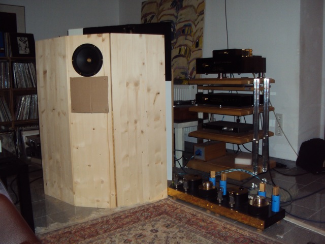

I made a lot of changes to my system. I am listening most of the time now to the Enviee with wizzer on open baffles. First i though that in the upmost treble there is a minor loss of sparkle compared to the ribbon version but my G-Pole principle solved that so well that the total sound is even better then the standard MPL. Much more coherent and 3 dimensional and extremely open and dynamic without any fatigue. It is really hard to stand up and go to bed. Sleeping ? A waist of time if there where not this incredible dreams in the morning.
Really, how older i get the more realistic and on the other side surrealistic this dreams get. By the use of passive EQ and passive line filtering ( semi active ) i got now a phantastic result. See the latest measurements and then some pictures.

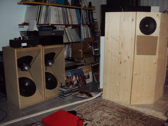

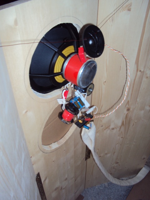

Here is the right speaker with woofer, the left channel plus CD player and tube amps and a view from the back with passive EQ and recent addition of a far end Zobel to suppress RF ingress and oszilation.
My vinyl setup will be posted on MPP soon.

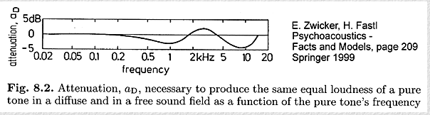

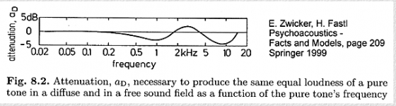

B: shape the back radiation in such a way so that sound coming from the back of the G-Pole to the listening seat sounds tonally the same as the direct front radiation. I am using Zwickers diffuse field curve so ideally speaking it should be somewhat suppressed in the 1kHz region, then somewhat going up between 2 - 5 KHz and then again somewhat suppressed in the 10kHz region. If the back radiation from a dipole is the same then the front radiation, like for example the Nao-Note, then the diffuse part will sound slightly dark because of the subjective presence did in the unequalized diffuse radiation.

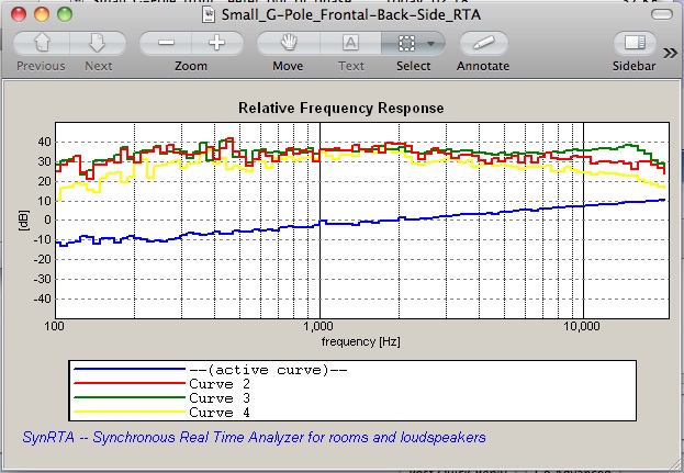

Sure, it is just that little tweeter that hangs in the back that does the trick for me ( post 184, right picture ). I will post a phase measurement from the front and the back of the smaller G-Pole i will describe in Jan´s periodical soon. Then you see how fracked it is by this small measure.
I am also convinced that my idea can be refined and optimized so i do not say that i understand everything what is going on, maybe never will. It has light up a spark in me though. I think it has merit.

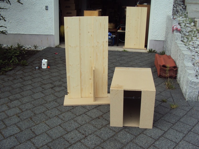

Not many people can place an MPL baffle with 120cm width or the Betzy style version with 140cm width so i decided to design a baffle with 60cm width. The baffle step will be taken care of like in the Mini MPL by using an additional driver in the deeper midrange. For my personal build i will use an Enviee wizzer version for the top driver and an standard Enviee in the deeper mid.There will be a tweeter on the back to arrive at my G-Pole radiation pattern. That is an expensive driver set for the uncompromising but i will also make a version based on the SEAS ferrite wideband driver. I also designed a new woofer that is simpler then my M-dipoles. It is a cardioide based on a U-profile.
I talked to Holger Barske and there is a chance that he will publish this combination as a DIY kit in Klang und Ton.
