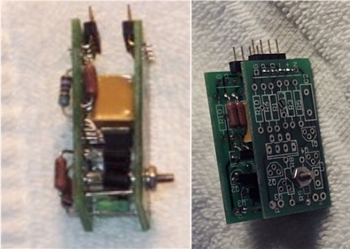

The opamp on the towel looks good.
I am curious as to how you added a 100 ohm gate resistor to the opamp board. Did you just cut the trace on the front of the board between Q1 and the ZVP3310 and then bridge in the 100 ohm resistor?

I installed the 100 ohm resistor in the gate/base hole and bent the gate and resistor leads and joined them together with solder. No cutting or drilling.
That sure is a better solution than cutting traces.

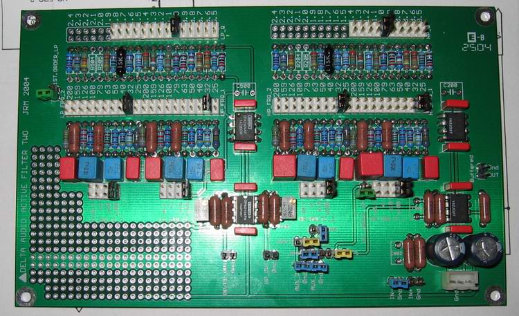

By request...
Arne K
JensRasmussen said:Hello Arne,
Nice one, how about some close ups?
\Jens

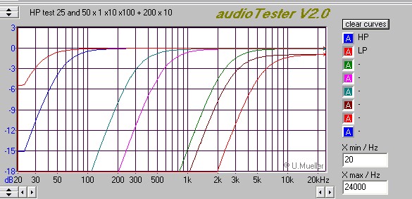

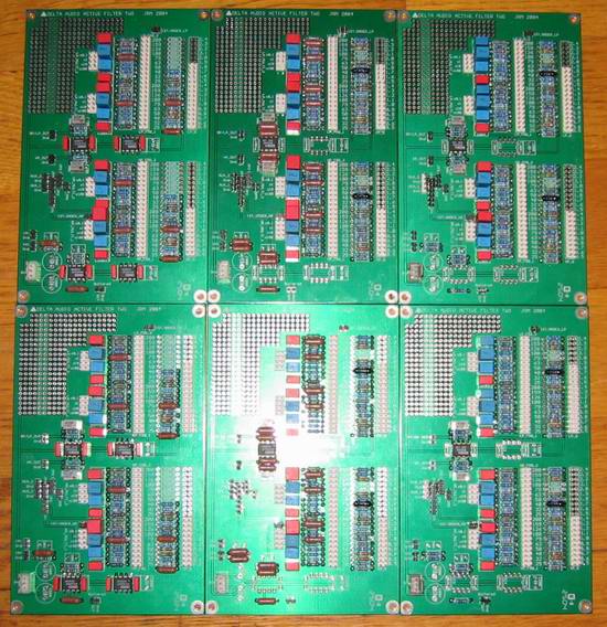

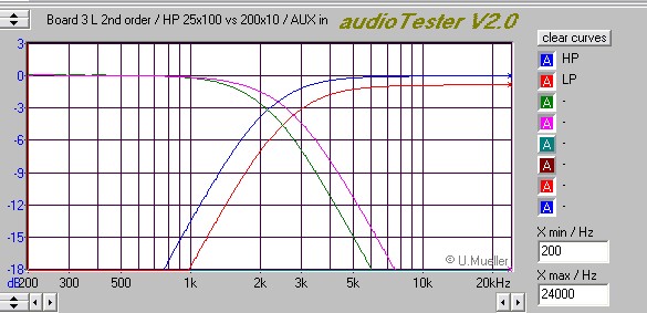

HF rolloff with 100x settings?
Hi all,
I finally got to test my 8 boards. All filter sections are completed, inputs and buffers still to customize.
The results are very good and consistent for the 1x and 10x frequencies.
But at the 100x settings (the 1 nF cap) I have a consistent HF rolloff for the HP section, ca. -1 dB at 20k. The rolloff starts well below 20k, so that the crossover frequency shifts significantly and the HP and LP lines don't cross at -3 dB anymore.
Any ideas as to the cause? I eliminated the following:
- op amps: tested OPA 2134, TL072, NE5532
- input: buffered or unbuffered
- all 8 boards react the same
- soundcard has reference (its other channel)
- input buffer alone, or any HP settings with the 100 nF and 10 nF caps (1x and 10x) are perfect at 0 dB at 20 kHz - so it couldn't be in/out problems anyway.
Whay should the smallest cap cause a HF rolloff in a HP filter?? I can only think of lead inductance or parasitic capacitace to ground.
Pics attached, self explaining I hope. Note especially where the 2000 Hz HP, using 200 Hz x10, has 0 dB at 20 kHz, while the 2500 Hz HP, using 25 Hz at 100x, has -1 dB at 20 kHz. The 25 Hz at x1 or at x10 is perfect at 0 dB at 20 kHz.

Well, now, this is interesting. Ages ago I posted a similar pic showing the same odd behavior and was really scratching my head over it. To me, it did not look like rolloff--Fc was dead on, and the slope looked to be zero outside the crossover. It just looked like it was -1dB down.
Looking at your post, I also do not think Fc has been shifted when the level is corrected for.
http://www.diyaudio.com/forums/showthread.php?postid=383881#post383881
But Jens was unable to duplicate my results! What could be different about his setup and ours?
Tiroth,
You're right, FC shifts only insofar as now the curves intersect only at higher F - in fact it is due to a loss of gain in the HP. It doesn't shift w/ frequency after it reaches its maximum, so it is likely not stray inductance/capacitance as I speculated. Could be that the formulas for Sallen key make some hidden assumptions which become invalid for certain ratios of caps and resistors... I didn't know/remember that you had the same results...
In retrospect it would have been better (for me) to cut all R values by a factor of, say, 5 (better also for low noise and for op amp balance regarding R on negative vs positive inputs...) and to multiply the caps by 5 (I don't need the 0.1 x setting anyway which would then require a very large cap). Hmm, or I can use an intermediate cap at the 0.1x position. But that would make for odd frequencies.
I guess now the only quick hack is to raise the Q for the HP to compensate. Or to live with it
MBK
