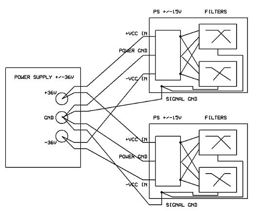

I have a question about the proper way to attach the grounding when using a seperate external power supply and seperate x-over chassis.
Should each ground from the MOX boards return to the separate power supply chassis ground or would returning all grounds to a common point at either the input or output grounds on the x-over chassis be best?
I want to build a 2 channel bipolar supply that will output a regulated +\- 36 volts. This could then be used for other projects or changes in the future and then do further regulation for the specific circuits. So, for the MOX x-over I would use regulators +\- 15 to 18 volts in the X-over chassis and have the +\- regulated 36 volts feeding the x-over chassis.
Thanks in advance for any replies. ( maybe Mo-amps will reply )

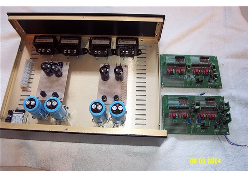

X-over boards are stuffed, discrete op-amps are assembled. Purchased two 20 series chassis from Par-metals (Nice chassis). Working on the power supplies.
How are others coming along on their x-overs. Haven't heard much for awhile???

Hi BDP,
I think it would be best to use one power supply for each crossover channel. Experience has taught me that grounding loops can be very tricky business, especially when it comes to a bit more complex power supply schemes like the one you would like to implement.
I myself am not so sure that this is a good way to go but if that's what you want, see the block diagram in the attachment below that shows you how I would do the grounding if I really had to. The basic idea is that the power grounds and signal grounds meet in only one point, which is the star point of the main power supply. The power grounds and signal grounds of other equipment that you may choose to connect to the main power supply should also be isolated in this way. In practice, this means that power supply cables from the main PS to each piece of equipment should consist of 4 wires (for +VC, -VE, power ground and signal ground). I hope this helps.
Milan
Milan
Thanks moamps for the reply,
I will be using one power supply for each channel. Both will be housed together in a separate enclosure from the x-over boards. I will only be powering the MOX boards. If I put 4 MOX boards in one enclosure then there is no room for transformers. This way I get some isolation between the transformers and the X-over boards. I hope to keep the power and ground wires as short as possible. Six to eight inches. I want a more flexible supply so I can power experimental circuits in the future without having to build a new quality supply again.
Looking at some pictures of the XVR X-over I see the power is attached by a DB-25 connector. Maybe it is used because of all the returning grounds to the power supply??
What power supply arrangement would you implement for the MOX design?

This sounds just fine.BDP said:I will be using one power supply for each channel. Both will be housed together in a separate enclosure from the x-over boards. I will only be powering the MOX boards. If I put 4 MOX boards in one enclosure then there is no room for transformers. This way I get some isolation between the transformers and the X-over boards. I hope to keep the power and ground wires as short as possible. Six to eight inches.
I'm not sure. It's possible that NP uses a couple of pins for one signal connection. DB connectors have very good and reliable characteristics.Looking at some pictures of the XVR X-over I see the power is attached by a DB-25 connector. Maybe it is used because of all the returning grounds to the power supply??
I built my last crossover using the block schematic in the picture below.

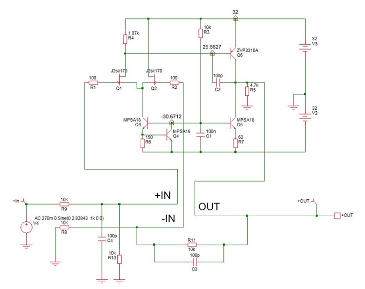

I have tried to change the opamp circuit around a bit. The main reason for attempting this would be because I have recently completed a nice power supply that has 32V rails and I like all the op-amp boards that I got.
I recently downloaded the SIMetrix program which helps give a general idea of how a circuit will behave when changing values.
Along with reading the "DIY op amps" article by Mr. Pass it becomes easy to adjust the bias values, and this is all that is really needed to get something working with a different supply.
I have changed the output follower to ZVP3310a and the current source bipolar's to mpa18 (mpsa42 is very similar). I optimized the current through the 2sk389 to 4ma total shared evenly and 10ma through the follower. The bottom is just an input buffer with 0db gain to test the opamp.
I haven't built this yet but plan to. The circuit is the same and nothing has really changed so I don't foresee any problems.
-dave
With the supply rails at +/- 32 volts R3 will have to dissipate 400 mW. Your resistors should be about double or so the wattage. The size would be getting rather large for the boards. You might try increasing the resistance to reduce the dissipation. A pot. in the drain used to adjust for variations between zvp3310's would be nice also, but at unity gain might not be needed.
