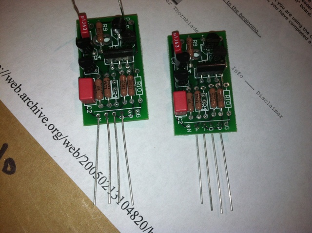

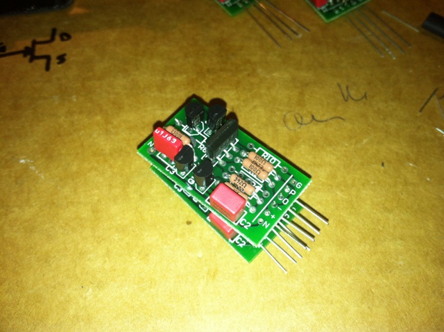

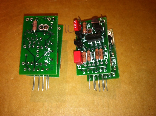

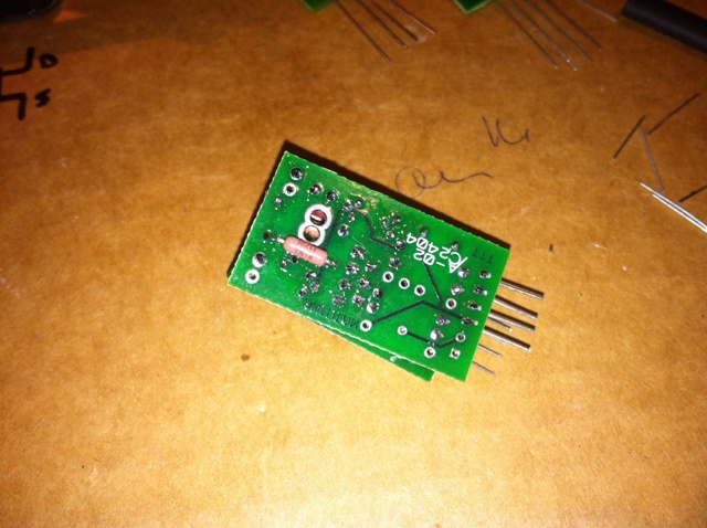

MOX II- Populated Boards
Here is some info on assembly of the MOX II discrete opamp.
