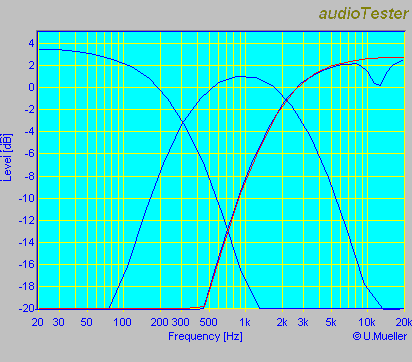

Here are the actual measurements from the prototypes. This is for a real set of active loudspeakers
Low pass: 320Hz, Q=0.5
Band pass: 320-3200Hz, Q=0.5
High pass: 1600Hz, Q=0.5
The red trace shows the high pass output, the blue trace shows a parametric notch filter centered at 12kHz, gain -3dB, Q=4.
I can see from the HF measurement that I need to reduce the ground fill a bit around the HP section. I thought that simply moving to a single-side fill would be enough, but I can see there is still a little too much stray capacitance.
Tyler,
Nice work
What's the problem with the groundplane? does the measurement not match the calculated response?
I did some experiments with my filter one board and found that the calculated response matched the measured nicely.
Please explain further
\Jens
