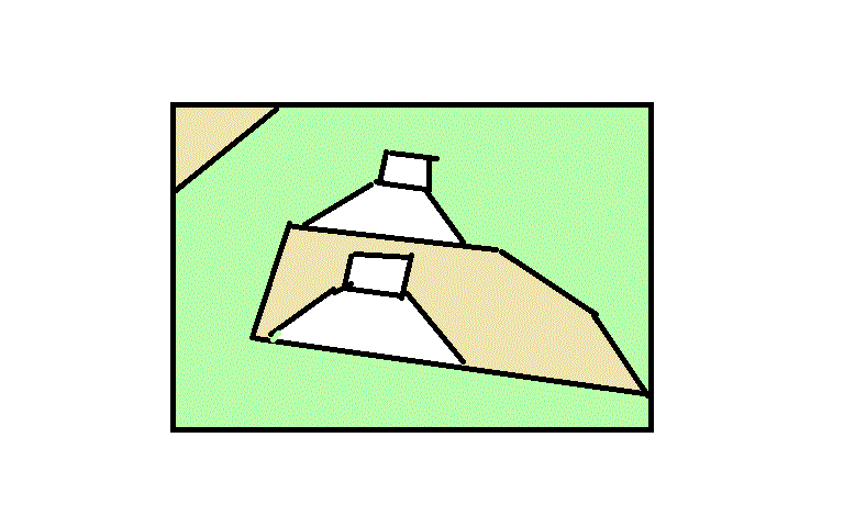

Yes maybe but Danley dont thinks make something bad..... also has make TH221 extream low frequency and powerful subwoofer doese eny one knos the plans of this ? http://www.danleysoundlabs.com/danley/wp-content/uploads/2012/04/TH221_SPLASH_03.png

That's an interesting layout. Any information on the internals? For example, is like the attached diagram?
Dont find the plans man but your idea seems correct or something like this.... View image: 20150529 horn

Looks like a front loaded pipe similar to a Danley BC
