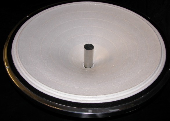

Take a look at Hartley 224HS. It is 24" super-woofer, with fs = 13 Hz.
Hartley loudspeakers
I don't know if is it the most powerfull but certainly is interesting
Website is horrible but probably worth the effort
At least as a curiosity.

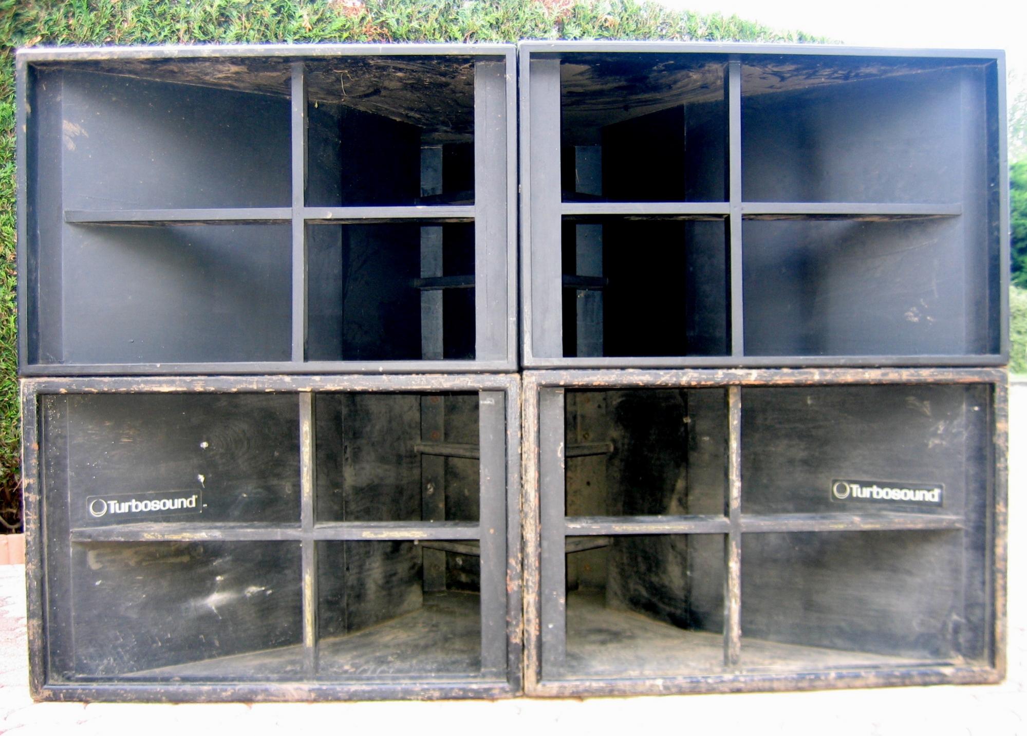

Hi koutrou, the PrecisionDevices Drivers are surely very ones, but only when in the right enclosure and also used the right way! Both work best in Horns and then you do need a lot of this horns to get a high performance at very low frequencies! I have worked with the Turbosound Speakers for long years and I allways liked them. But when you do require really high SPL at extreme low frequencies you do need more then 1 or 2 of the 21 or 24 inch Horns! But that surely depends on the size of the room you want to party in!
But there re so many more possible solutions, it only depends on what performance you do expect and what you intend to do with the speakers! As I said in my first post, when you want to use it ast home, when you have good time with friends and wanna party and dance, then one 21 inch in a good enclosure and with a good amp is surely enough, when you want to do a huge openair party with 5000 friends then you need some bigger weapons!

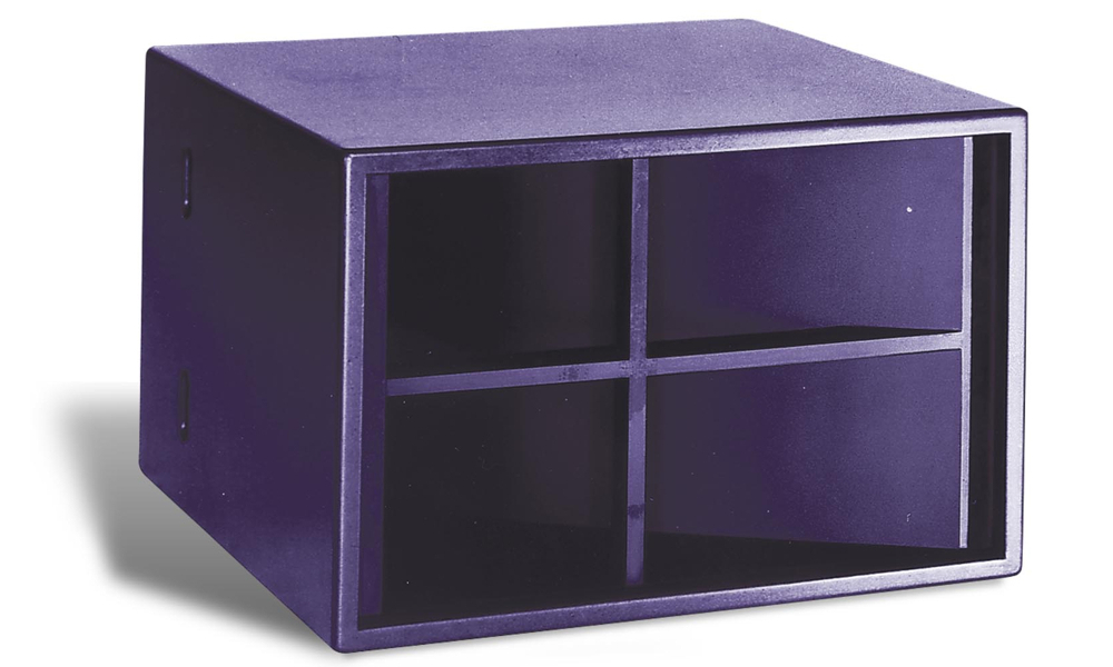

I attach some information about the TSW124 for you as example!
Thanks man, nice enclosure sub bass design maybe i will buy Beyma 21Pw1400Fe is very powerful !!!
The TSW-124 was never intended to be used as a single Sub. Normally it was used in groups of 4 or 6 Subs and then it works! Promissed!!!

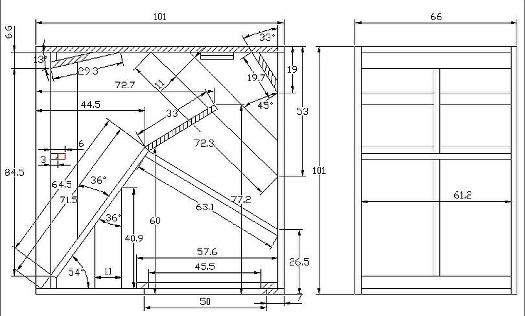

see my simple plans for a new box desing, i think that will be powerful and produce low frequency.... what do you think ?

HMm what Do I think about your design koutrou? To be honest, nothing, cause this is no design! This looks like a 10 years old Kid draws Daddies whatever!
i have the original project but to paper, just now drawn fast to see the idea with 2 ways hornloaded (not sealed from the one way and from other way hornloaded) combine with custom horn flare (infrabass) for extended bass....
