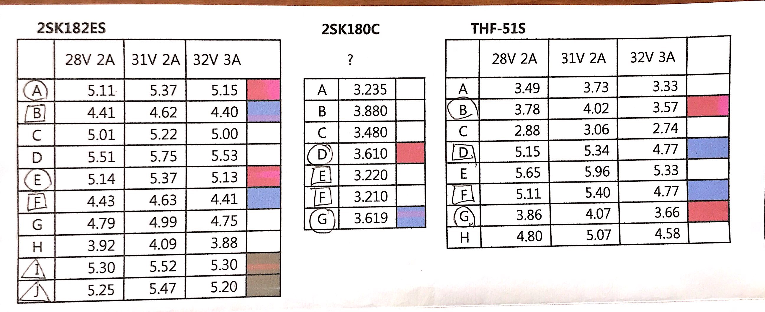

What I cheked is below and I forgot what condition I did. Maybe one of 28V 2A / 31V 2A / 32V 3A. I was dreaming of big tower amp driving my Dynaudio.
But you can see the Vgs are not so jumpy, but too low.
counting on fact that all 3 tables were made with same goal in mind , we can count on fact that thety're comparable
from that I can see that 2SK182S is having too big Ugs ...folding on other side of IRFP9240 Ugs , so wee need to fill gap between sources , to have gates in same point
while with 2SK180 - I see Ugs is even smaller than THF , so opto bjt will have even more space to be put in
from that point of view , SissySIT is most probablydoable with 2SK180 , while possible difference in sound vs. THF iteration , I can't predict ...... probably not much , but that only real test can show us

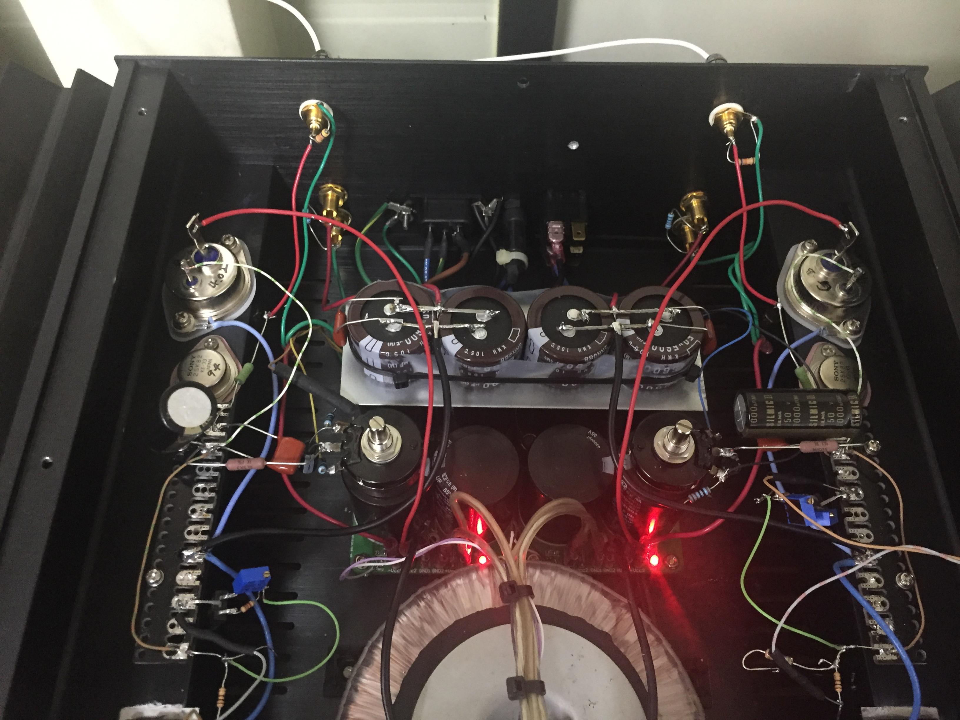

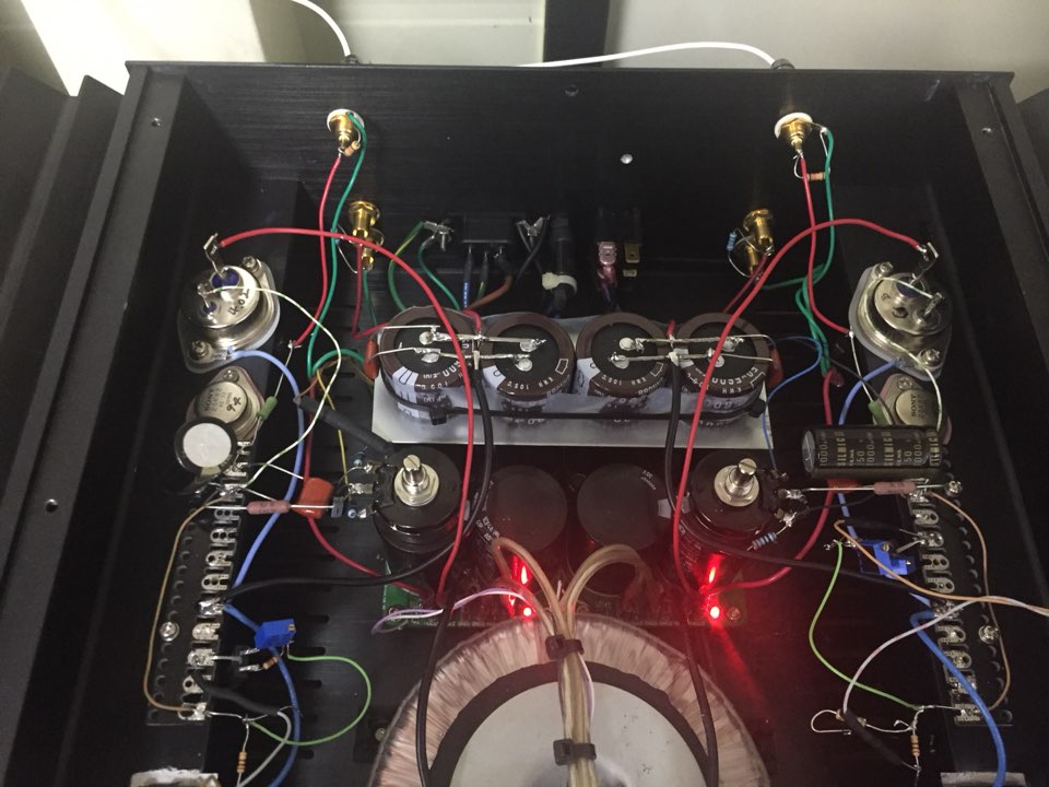

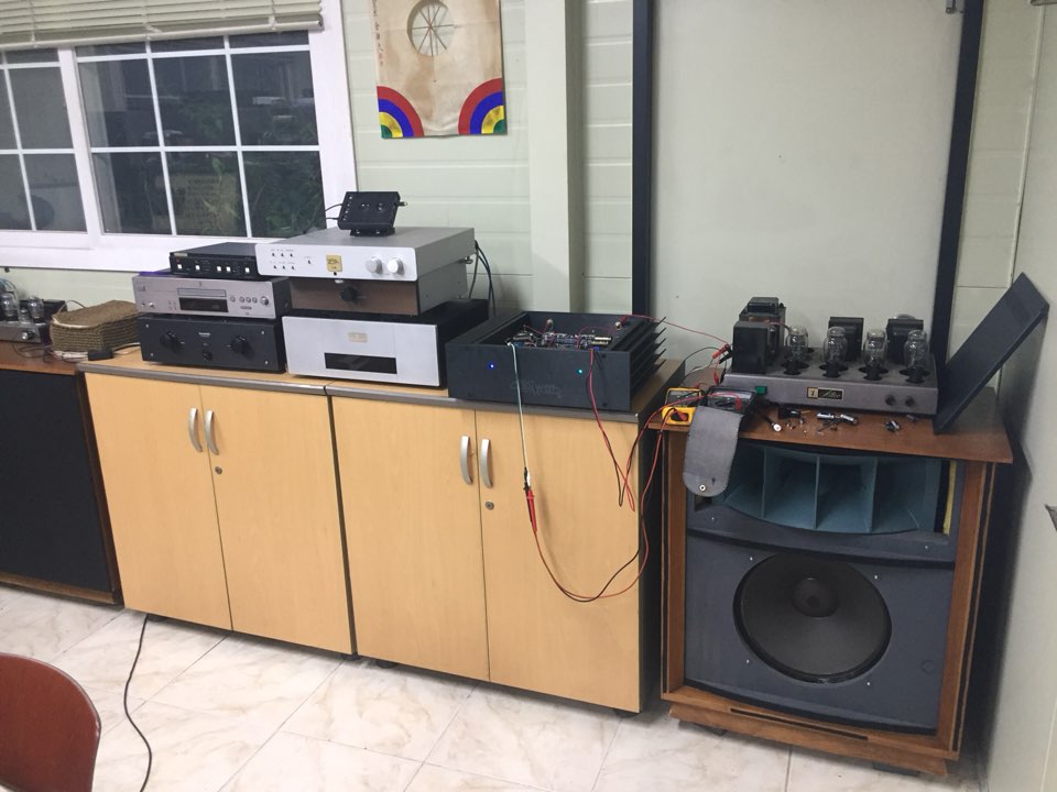

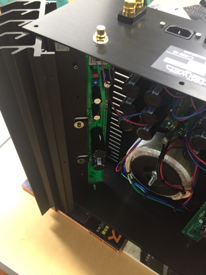

OK ZM, here goes the random pics.

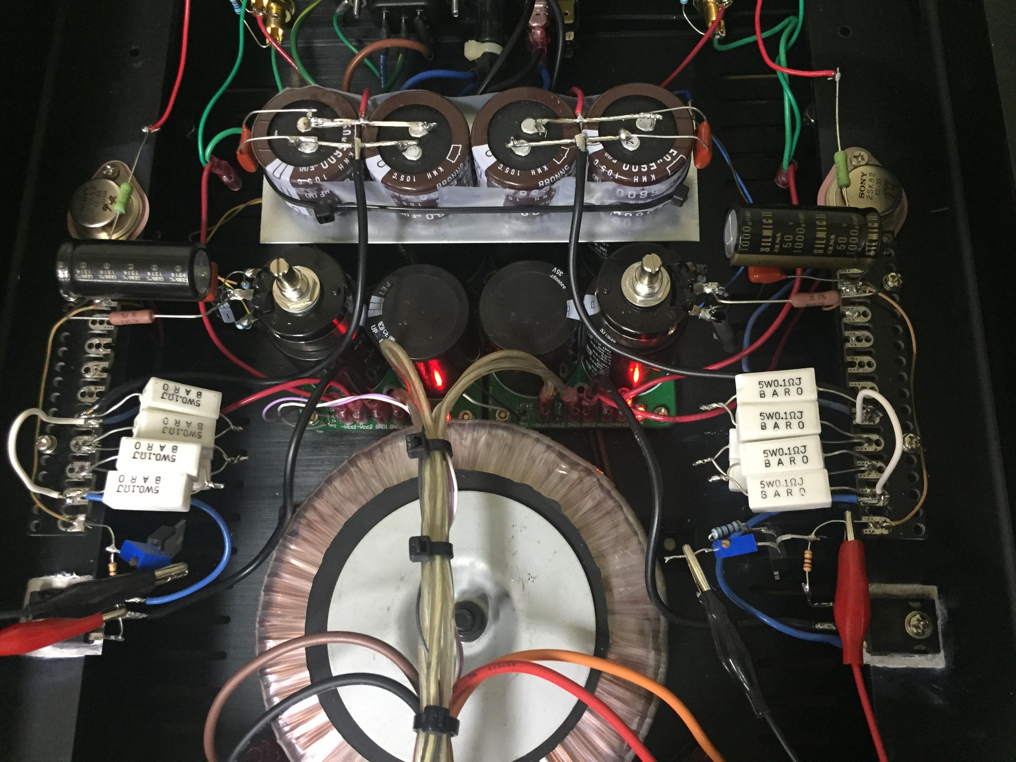

2SK82-IRFP9240 with 0.6 ohms Source R
2SK82-IRFP9240 with no Source R CCS from 12V batteries to the 100 ohms gate resistor
THF-51S-IRFP9240, same as above
THF-51S-IRFP9240 with CCS from regulated supplies to the 100 ohms gate resistor - hum
THF-51S-IRFP9240 with separate bias from regulated supply to the 100 ohms gate resistor - still hum
The SIT-3 serving my curiosity

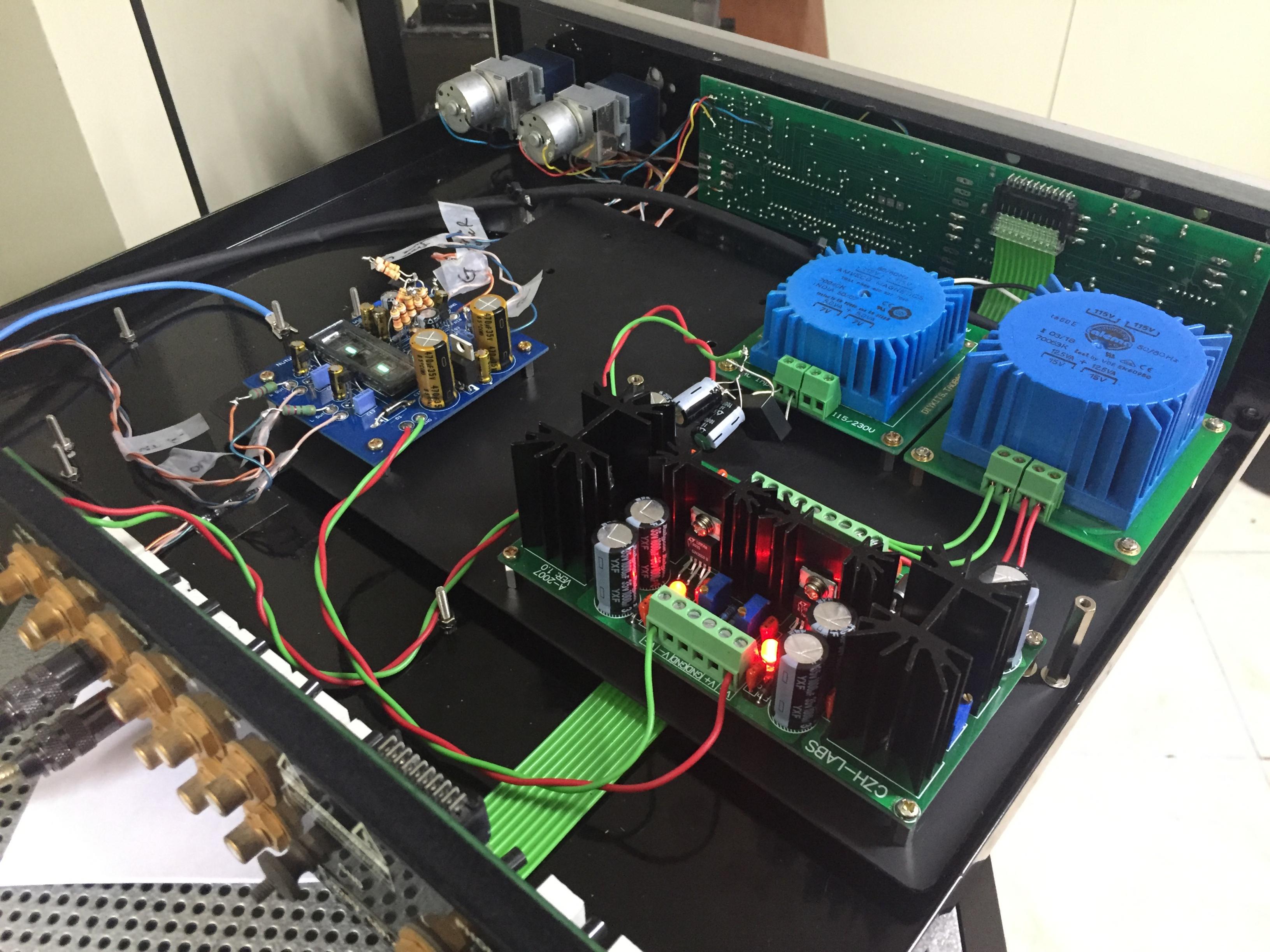

Chassis .... dear old F2 (hardcore porn right?)

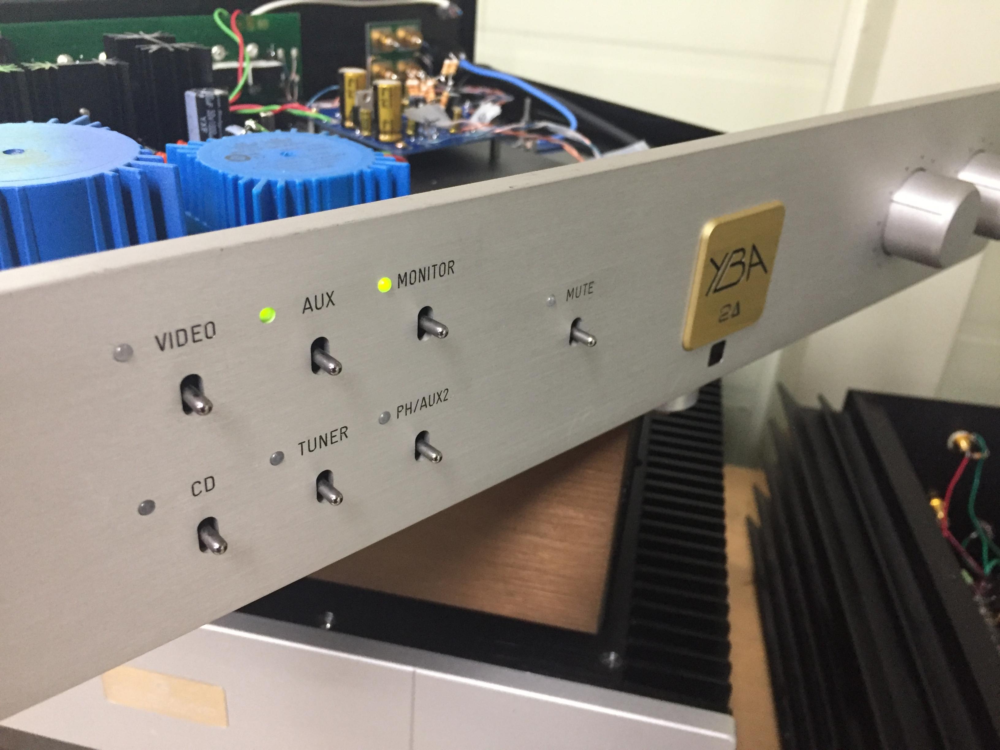

YBA slaughtered into KORG B1. This YBA circuit is just ridiculous and I punished ..

Using an F2 as a chassis is ultra hard core.
Good stuff Chul.
Dennis
This does not mean F2 is not good enough. This F2 is my DIY friend's and he got a brain stroke and impaired. His only joy is listening to music and he wishs to have a listen to SIT. Initial plan was only replacing one FET but ended up like this. This ia no offense to the F2 I hope.
Why not free set of SissySit pcbs,perfect for that box?
Cause is good ...
There is no reason why not..
You got mail sir.
