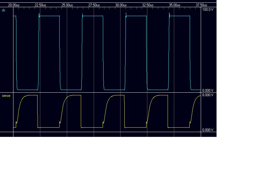

I have simulated a snubber and taken the opportunity to include the current sense circuit based on Rds(on) that subwo1 proposed. It seems to need a few pF at the output (perhaps the SD pin or wherever it goes capacitance is enough) to filter the recovery peak, that is higher than the voltage to measure.
Upper trace is Vds (a single mosfet has been simulated, a IRF640 with 50nH series inductance and a 470pF+10ohm snubber).
Lower trace is output of the current detector circuit.

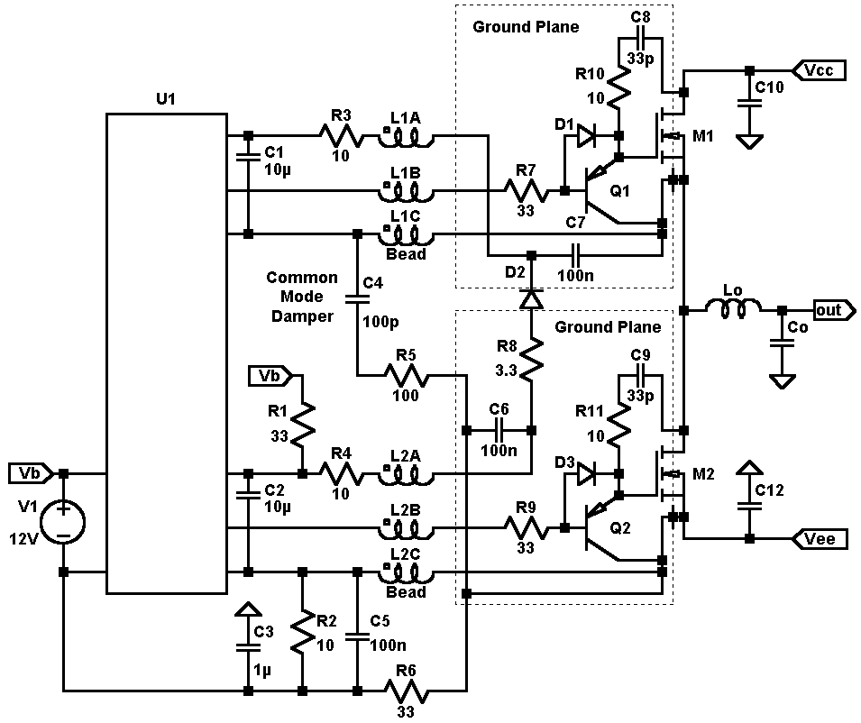

If I were building a DIY class D amp for myself, I would put the driver circuitry on little daughter boards above the main PCB in order to solve the routing conflict around the output mosfets between power and drive signals. I would contact the mosfet leads using traces to the edge of the little board at about 5mm below the body of the mosfets and fix the connections with solder from just the front side of the mosfets. One side of each of these boards would be a solid plane connected to the source of its mosfet. The signal leads to the driver IC (which would be on the main PCB) would each be a twisted triple of kynar wire routed through an approximately 5mm diameter by 10mm long ferrite bead. This would decouple the driver IC from the mosfet switching edges and ringing on both the high side and the low (ground) sides. Please see attached schematic.
Regards -- analogspiceman

Some considerations: I am taken for granted that the diodes I am using for the gates and for the VS to COM protection as well as for bootstrap are adequate: they are MURS120. They are ultrafast, not schottky.
Here is the datasheet:
http://www.onsemi.com/pub/Collateral/MURS120T3-D.PDF
Do you think that there can be any problem with them?
Particullarly the VS to COM diode: it is effectively in parallel with the lower mosfet, it was intended to protect VS pin from going too negative. Perhaps this needs a review now.
