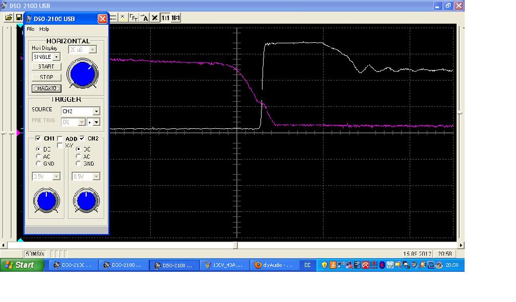

The attached screen shot is showing the turn OFF characteristic when switching a mostly resistive/inductive load of 115V / 45A.
You can see that the gate plateau and voltage transition of the load is in the range of 400ns. Due to the inductance of the heavy resistors we get an overshoot which is perfectly clamped by the varistor and then rings off in a well behaved manner.
Time scale is zoomed by factor 10, means 2us/grid
White trace is the voltage across the switch measured with a differential probe 1:100 means 50V/grid.
Red trace is the gate drive voltage with 1:10 probe means 5V/grid

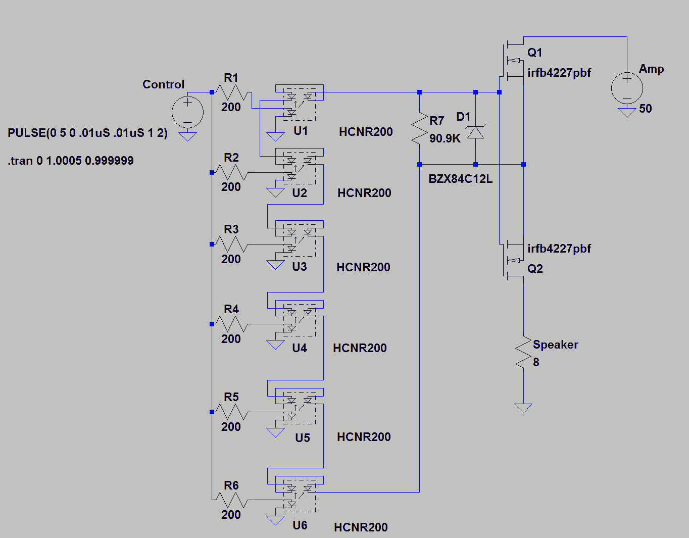

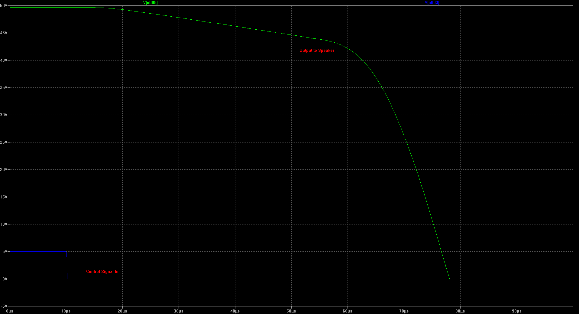

I want to build a simple MosFet relay for switching the speaker output from an amp with +-50 V rails using locally available parts. This is what I came up with.
LTSpice says the turn-off time from 50V to 0V is less than 100us.
Does this look like a reasonable design?

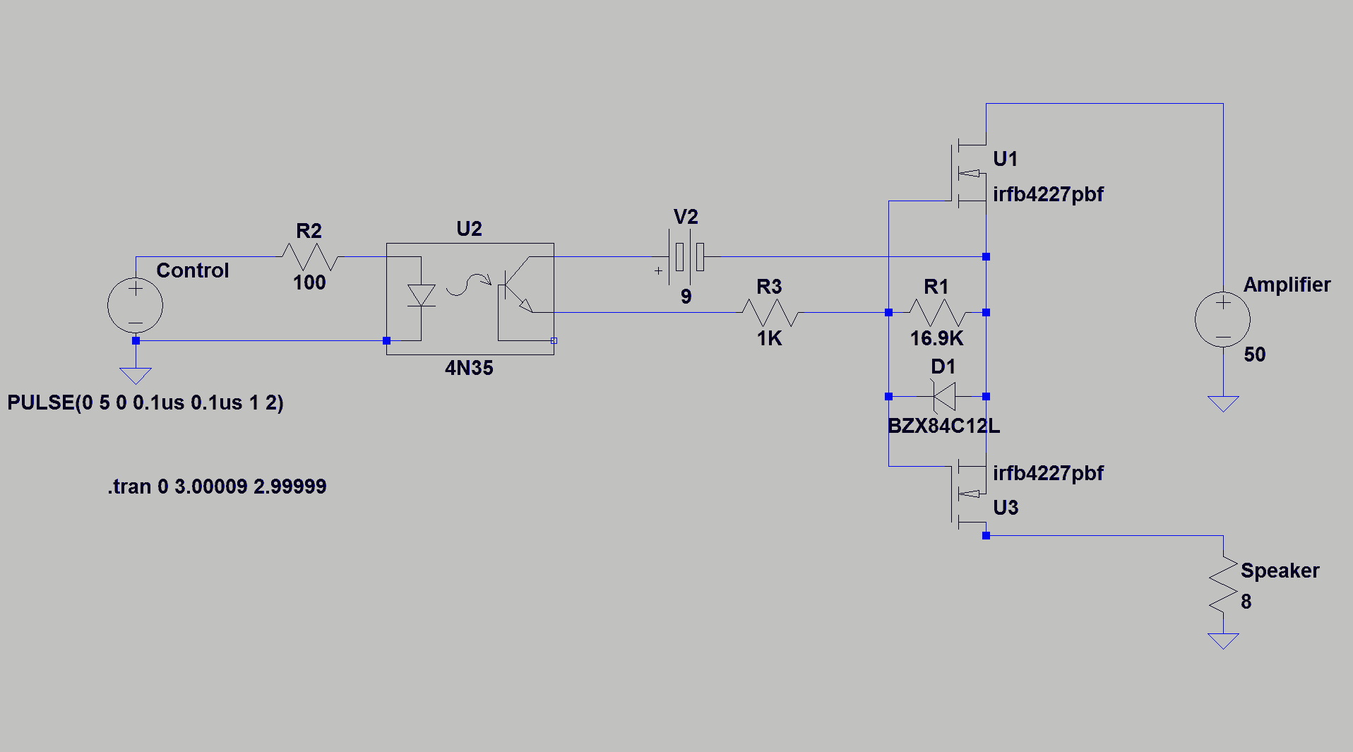

How will you obtain the 9 volt "floating" DC source in practice ?
Yes its fast... whether in reality it performs the same as in simulation would have to be seen. The real time delays come in the drive and offset sensing circuitry that would drive the opto.

I had intended to use a separate transformer and dc supply for the floating 9V, but I like Bonsai's approach using PV diodes instead of an external power source much better. I was unable to find a Spice model for the TLP191 that Bonsai uses, so I stacked some HCNR200's (which has an available Spice model) to attempt a similar emulation in LTSpice. Here's what I got. I trimmed R7 for the best turn-off time (at the expense of turn-on time, which is unimportant to me as long as we stay within the SOA of Q1 and Q2). I got a turn-off time of around 40uS. Bonsai, you say your circuit has a turn-off time of less than 250 uS. Have you tried using an external resistor to tweak the turn-off time of your circuit?
