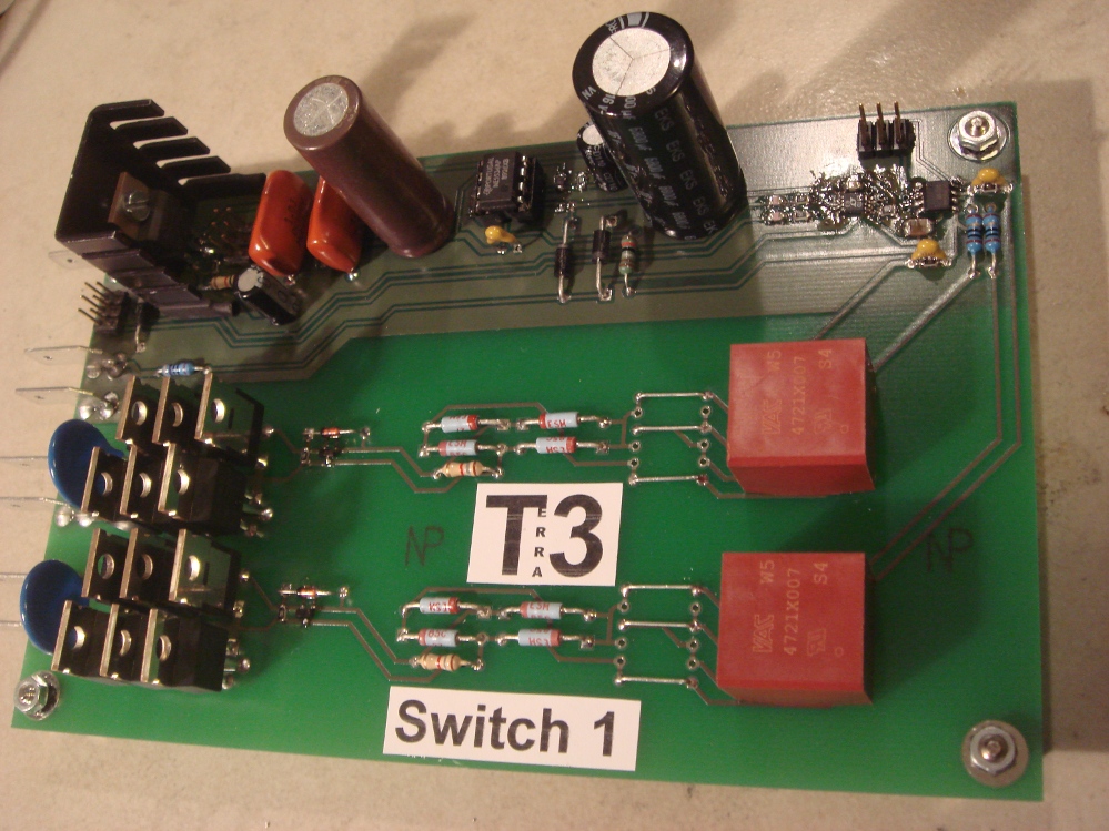

MosFet Relays
Also tired about struggling with old or low quality speaker relais?
May be this solution is more adequate for the 3rd Millenium.
It offers fully isolated speaker switching within few microseconds and distortion well below my measurement accuracy.
Don't bother about the huge PCB. The shown PCB is a trial PCB for multiple functional blocks which I intend to use in my next class D amp and also for getting familiar with the layout software...

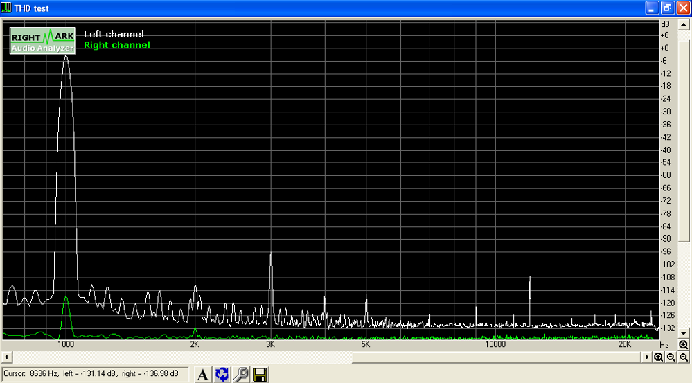

The distortions are below my measurement possibilities.
Especially I am lacking a power amplifier, which would have a harmonic spectrum below -120db... :p
I adjusted one of my amps for class A operation, and
even with this the distortion spectrum remains unchanged when adding the switch. Here the spectrum of the class A amp with this switch delivering 10W into 5 Ohms.
How can I tell -120db from the above? From the above I cannot.
But I analysed the voltage drop accross the switch itself, which is approx. 1/1000 of the amplifier output voltage.
Analysing this drop showed nothing but the fundamental and the noise of
the mic amp, which is 60db below the drop of the switch.
So the distortions of the switch are below -60db of 1/1000 of the amp output.
Means referencing to the amp output the switch introduces distortions below -120 db.

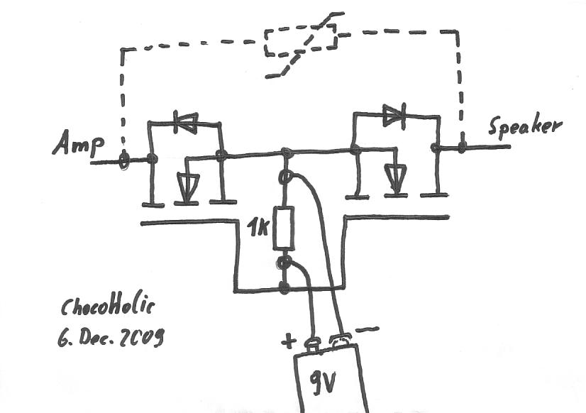

The first schematic is the Rolls Royce, which might look complicated.
But we can simplify things to
2 MosFets
1k Resistor
9V Battery
For first real life trials you can even skip the protection varistor (BTW: Overvoltage protection could also be ensured by simple diodes from the MosFet drain to the amplifier rails).
The attached schematic shows all you need to start playing around.
Battery not connected ==> Speaker off
Battery connected ==> Speaker on
Feel free to start playing around and listen.
The MosFets should have low Rdson, the voltage rating should be as high as the rails of your amp.
How does the circuit work? If turned ON the N-chanel of the MosFet is able to conduct in both current directions! The only unpleasant thing is the body diode during the turned OFF situation. If you use only one MosFet, then you could block only on current direction. So I simply use two MosFet in series, connected in opposite direction. This is done since decades in bilateral CMOS-Switches. Modern MosFets allow such low Rdson that you can neglect the influence on distortion and damping factor.
  • C ...-zzz-Emeko.ckt.pdf
Basically yes, but do NOT start playing like proposed in posting #6 in a high voltage circuit.
If you want use the MosFet Relay for this application you will have to use 600V MosFets with low Rds_on and use a protection varistor which is intended to operate at 250V or 275V mains.
Furtheron your driving transformer must ensure the isolation for such voltages.
The nice thing is that you can test the relay and ensure by measurements also for proper gate signals under low voltage conditions and then if everything is Ok, you may step to higher voltages.
In any case: Take care! Mains voltage applicatons can easily kill a homo sapiens and even easier a homo incautus.

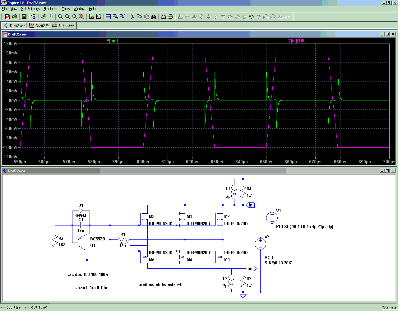

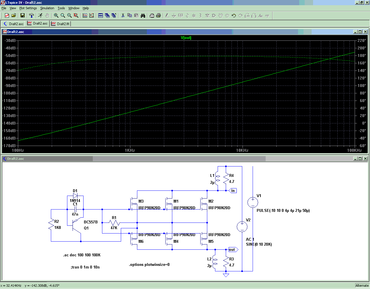

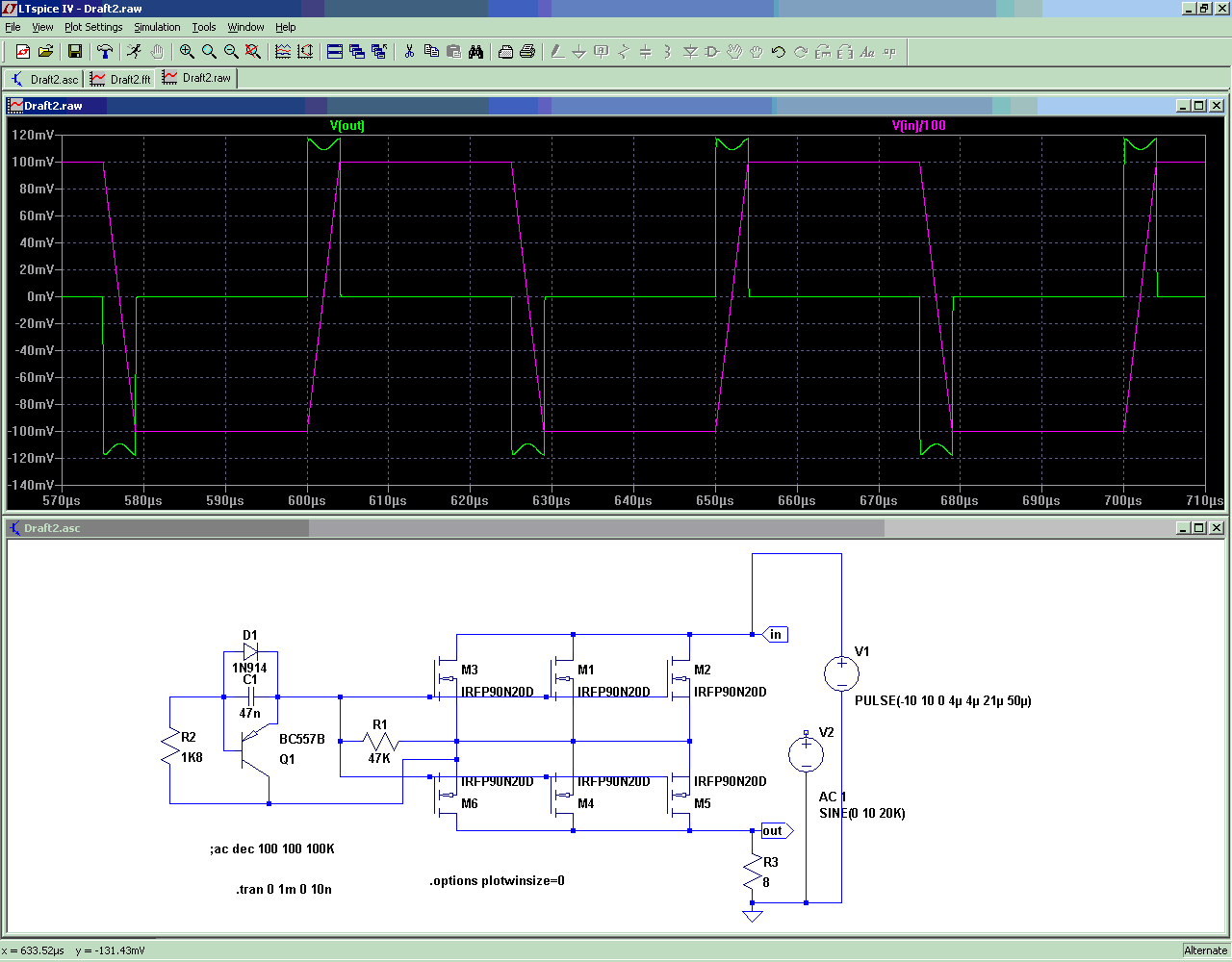

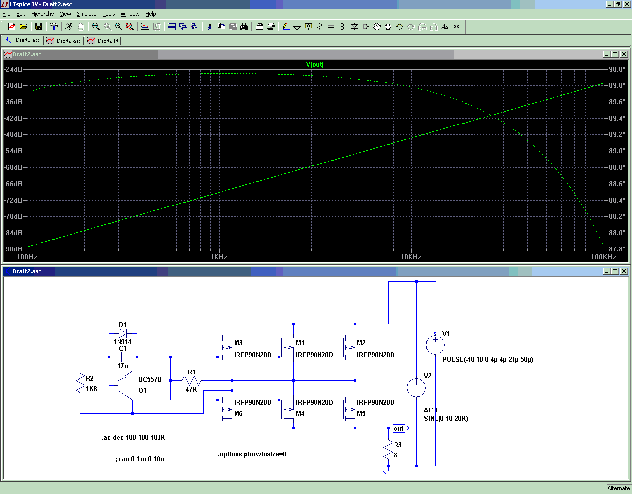

Hi Chocoholic
You seem to have done a good job ensuring artifacts in the ON conditions are minimal.
But you might have overlooked the OFF state. Large MOSfets have pretty large and non-linear parasitic capacitances, and they could cause unwanted leakage into the output when OFF.
Choco1 shows the isolation vs. frequency of a circuit similar to yours. At 3KHz, in the region of maximum audibility, the isolation is ~60dB, which is clearly insufficient.
This applies to a single throw switch. The situation would much improve in multiple-throw configurations.
Choco2 shows the situation in the time domain, with a slew-limited square wave.

Still - its at -80dB at 20khz, and the primary reason for protection relay is to protect the speaker from DC by catastrophic failure, and to prevent turn-on/off peaks.
Chocholic: Did you listen to the amp with this circuit, and does it work as inteded in real life?
If it is a protection relay only, the isolation is unimportant, so it should be OK.

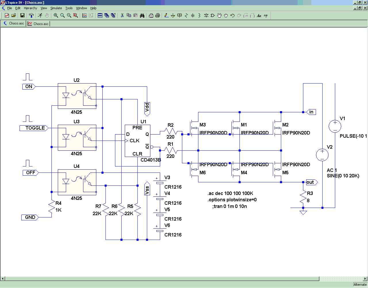

Combining the battery option with a small circuit could improve the matters slightly for other applications: by reverse-biasing the G-S capacitance, the isolation can be improved by ~6dB (ChocoLv1).
ChocoLv2 shows an example circuit doing that (obviously, not all inputs should be implemented).

Hi Ho !
That's nice, the discussion is started.
Off isolation was also one of my concerns, especially because of the protection varistor. First calculations told approx. 60db at 1kHz.
My measurements at 3.9 Ohms load show -63db at 1kHz and -44db at 10kHz.
As you already noticed for a speaker relay that's fine, for signal selector you would need the traditional arrangement with two switches.
One in series with the load, the second in parallel with the load and both switches driven with inverted control signal. You can of course do this arrangement also with the shown switch and theoretically then you will reach values in the 100db range.
But as you already noticed: For a speaker relay, the OFF-isolation of the simple arrangement is Ok.
