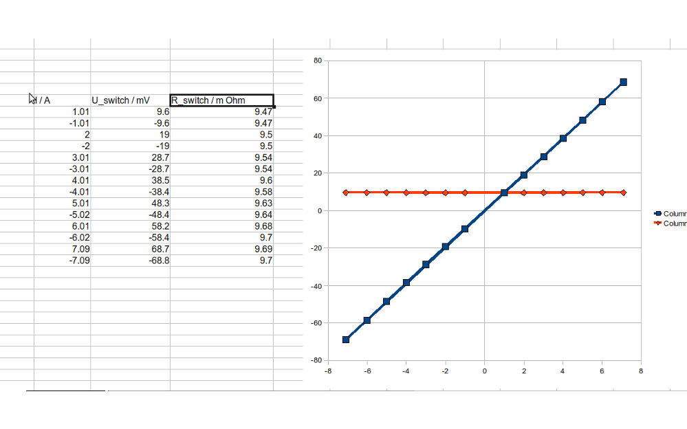

I settled a simple rectifier + RC-Filter in order to get a proper DC source( Rectifier, 10 000uF, 5 Ohms, 100 000uF, 2.2 Ohms).
This allows to measure up to 7A.
In order to allow best comparison of both current directions, I always measured both directions directly by swaping switch connection, but keeping the DC source and both DMM untouched.
The only imperfection which I found was a slight increase of the switch resistance towards higher currents, seems like 0.2 mOhm increase due to slight temperature increase at 7A.
