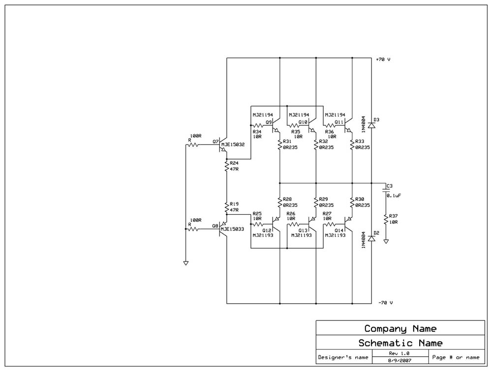

Maybe you should grab two old transistors from the parts box and make a "test" output stage.......
Update??
JJ
Mr. Pass, can I bribe you with pistachios? Maybe? 🙂
I have an oscillation at about 11MHz in the output stage. It doesn't matter if the drive inputs are open or shorted to ground. The level is very slightly lower when they are shorted.
I tied the frontend to the output drivers with no change. I even increased the FB with no help.
I also seem to have a problem with the Vbe. I have about 2.5V across it. The bias levels seem off the charts!! Does that voltage appear correct for a 160mA output bias?

Are you saying that with no input stage connected and the
output stage's input grounded that it's oscillating?
How about a schematic of your test setup?

Nelson Pass said:Are you saying that with no input stage connected and the
Mr. Pass,
The oscilloscope is at the output. That's it!
Mr. Pass, I just checked the other channels output section in the same manner, and it is oscillating also. It appears to be at the same approximate frequency, but at a slightly lower level. Hope this info helps!!!
Thanks, DonS
Thanks, DonS
Maybe you should attach the output node to between the
two 47 ohm resistors and see what hapens.

Mr. Pass, I did the above with no change.
Maybe I should try miller comp caps across the drivers?

Oscillation Update!
Mr. Pass, after further investigation I believe I found the source of the oscillation. The frontend board is still hooked up to the same power supply. If I touch the drains of Q1, Q4, or Q6 the oscillation stops. I can see this oscillation at different points on the ground rails and the power supply rails. It does not appear at the output of the frontend though.
Depending on where the test point is, the oscillation varies from 20mV to 100mV P2P.
What gives?
Thanks, DonS
What gives?
Thanks, DonS
