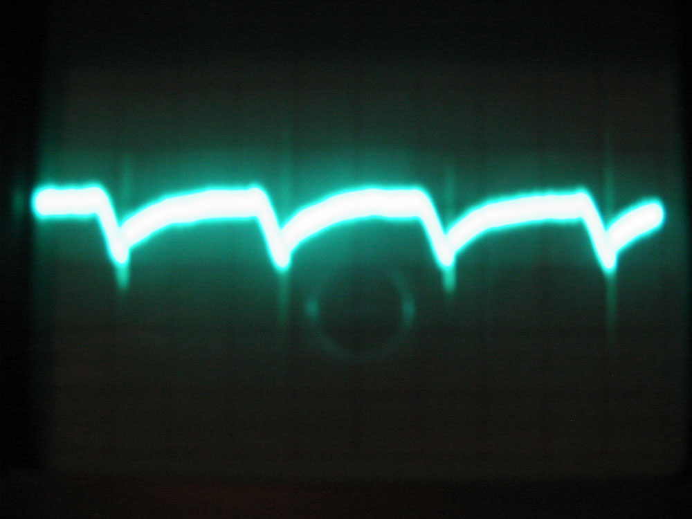

So now that this engine is running I need to get it idling smoothly. What I mean by this is that there is audiable hum/buzzing from the speaker. The oscilloscope shows several mV's of ripple at 120hz, with really quick spikes at 120hz and 240hz. (See scope shot below.)
I think that increasing R39 and R40 to 22R0 should improve this signifigantly without losing much voltage swing from the fe. (gaining ~15dB minimum of noise reduction with this change)
The other solution would be to increase the PSRR of the circuit. I just don't know how to do this easily!
Mr. Pass, and or other forum members, suggestions?
Thanks, DonS

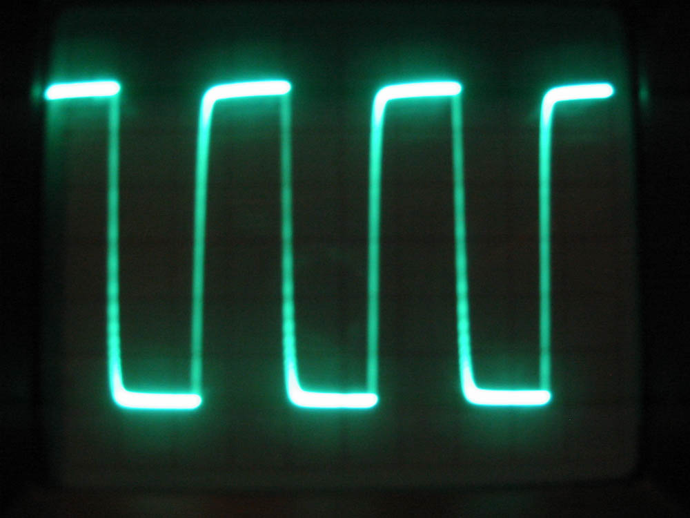

I am disappointed by the 10Khz square wave performance. (See the scope shot below.)
It shows no signs of ringing or overshoot, but the initial rise time looks a little slow and the rise time gets really slow as it approaches the peaks of the signal. (Good complimentary response though I think!) My instincts tell me this is an artifact of low negative feedback. (Possibly relatively large amounts of 2nd harmonic distortion?) (The transfer function appears to simple.) Please correct me if I am wrong. The circuit tests to ~ -2.5dB @ 100Khz with a sine wave, so I don't think circuit speed is a problem.
Mr. Pass, and or forum members please let me know what you think!

Nice work!
It would be good to know what scale your scope was set at for the square wave, and also what the load was. The picture was a bit blurry -- was there some detail on the downgoing portion of the square wave that was lost by the photograph?

Don S said:I am disappointed by the 10Khz square wave performance.
I've seen worse.
Nelson Pass said:
I've seen worse.
LOL ROTF

Nelson Pass said:Issue 3
Regulate or filter the supply.
BTW this is Issue 1
Presently I am filtering the supply to the FE with a C/R/C network of 10000uF/5.6ohm/470uF.
Will increasing the R value to 22ohm help significantly? Can I easily increase the PSRR of the FE?
Thanks, DonS
