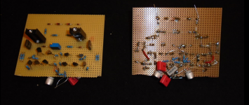

I put Banglas Amp in the lab to find out what happens. I told you that one channel is distorting, especially when the volume comes up. I build a dummy load as a voltgae devider so i can use my scope over a wider voltage range. The right channel is fine. The left channel has a trace of noise overlaid and when it goes into clipping there is some spikes visible. I shunted the input caps but that did not help. What can i do ?

This is an HF oscillation - most likely the local one, happening in the bottom sholder of the output stage. Can you please drop a link to the exact schematic of the amplifier.
I don't recommend using the faulty channel with the speaker so far - at certain amplitude oscillation can fry the tweeter.
the 22n-bad part?

After your explaining words my thought- the 22n?
Joachim if you would like to repair it- i have done tin solder on copper tracks-
like timios on his work and all isolated with Plastic 70 Schutzlack- could stinking a bit. It's ok- i only can learn there.
Hope the amp will be on life after that.
Also hope that is to find the oscillating part, that you can enjoy music without
to destroy the speaker.
Cheers Bangla.

Elvee's compensation scheme is good. However, some faulty part may cause such issues.
For example, some time ago I used a cheap 50V-rated 100pF capacitor in a prototype for compensation in position, where it potentially sees up to 100V (push-pull VAS - one of two Miller caps) - just did not have a better one in hand at that time. In about half a year, at power on, it failed - went open, almost no capacitance - causing a pretty nasty oscillation. Replaced it with a good one - everything's fine again.

Supply voltage is 35VDC.
Capacitors: Styroflex- Banzai; 220n- MKP Q4 Audyn; FKP2 5%- Banzai/Schuro; Mica-
TubeTown. All new never soldered before.
Not sure- what i have used in place 330p-MosFet, 1n-Darlington?
I am interested to see wich is the faulty cap- the bad !
Cheers Bangla.
