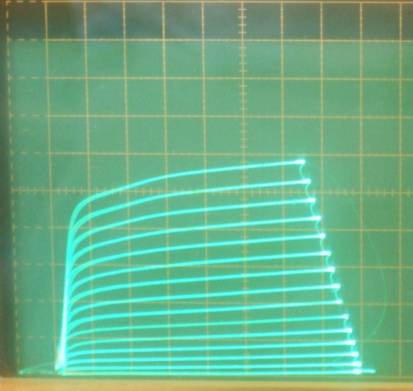

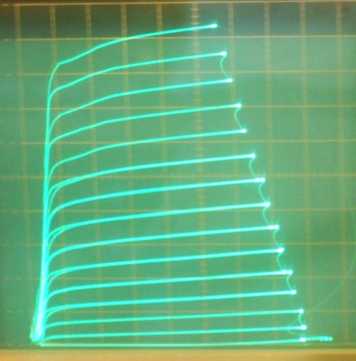

I have enough grid V sweep range now to do a half way decent curve trace of the 1625/807 tube using a 20K Ohm grid2 to grid1 resistor. (no grid1 to cathode resistor here) Similar to the STC schematic sser2 posted.
1625/807 STC drive, similar to Twin/Crazy drive:
20 mA/div Vert., 50 V /div Horiz., +12V steps on grid2 (with 20K to grid 1)
Looks like they knew how it worked back then. This probably never caught on due to their choice of an 807 tube (with HV grid2). Nobody wanted to use a 6L6 to drive an 807.
2nd pic is the 1625 with grid2 drive only.
Same 20 mA/div Vert., 50 V/div Horiz. and +12V steps on grid 2 only.
Less plate current output without the grid1 and 20K, and more gm variation.

The two 1625 curve sets posted above both start at 0V on grid2 and go up to +168V on grid2 in 12V steps. So there is not some conduction gap, like for class C. One will need relatively little positive grid bias for a low crossover dist. idle current setting in P-P class aB, due to the near constant gm.
The extra grid1 to cathode resistor, Rg1k, used up till now for Twin/Crazy drive does not seem to help much for the 1625/807 tube. But it does seem to be helpful for many of the LV grid2 TV Sweep tubes (Rg1k can reduce anomalously high gm in the low current range, probably due to some internal thermal-electric grid1 V offset preventing grid1 current in the low drive range). I would just call Rg1k a variable value to be optimized per tube type. Could be infinite or very high value for some tubes.

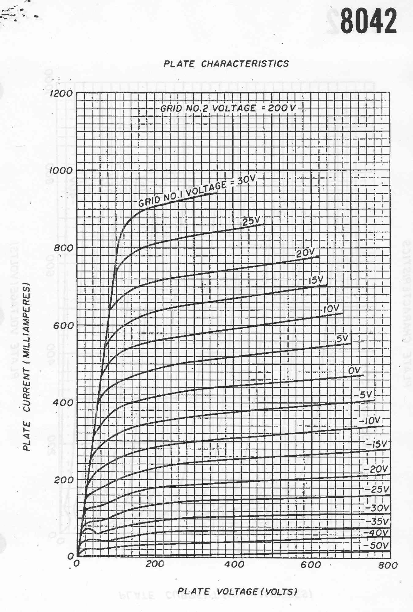

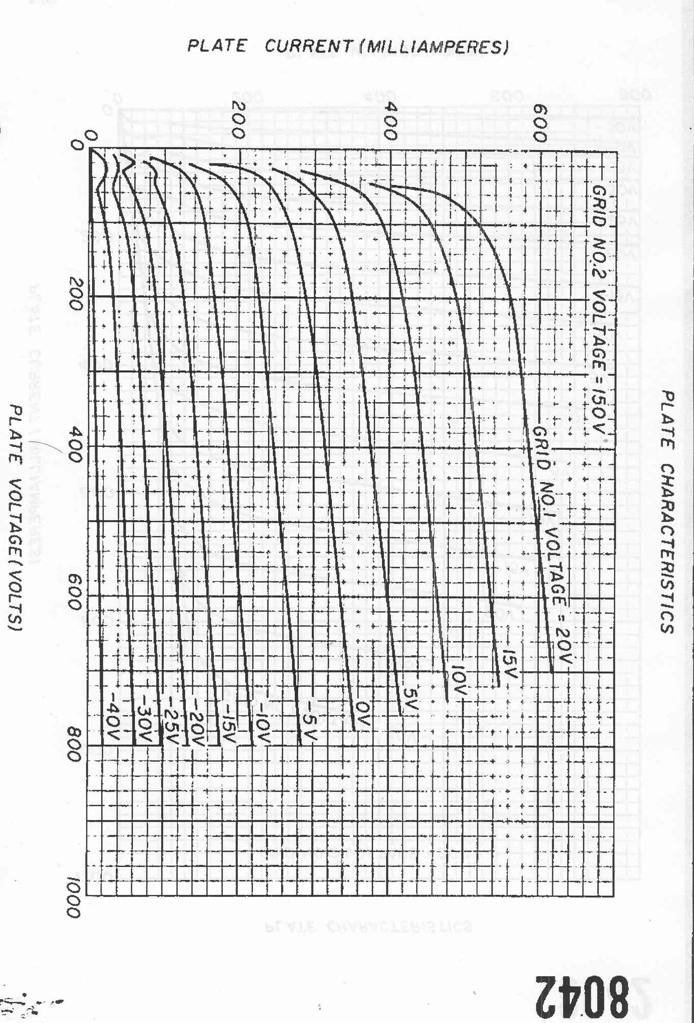

I have one more for your list. It is not a TV tube, but RF beam tube.
4652/8042 25W, 150 mA, Ug2max=250 V, mu=4, RCA 1969
Unfortunately, data sheet does not have plate curves. Unlike TV tubes, this one is directly heated, a bonus for those who like the sound of filament cathodes. I have a few of these, maybe you can get g1g2 drive curves?

4652/8042 specs:
25 Watt, 235 mA @ 150Vg2 knee, gm1 = 6000@100mA (7000 for 8042), Mu 4 (4.5 for 8042), 150mA max DC, RCA 1969 (4652), Amperex 1961 (8042)

4D32 looks like it has about 60% the gm2 of similar sized TV sweep tubes (like 6LW6) for the same plate current, due to the high Mu 10 factor, but then the 20,000 gm1 almost fixes that.
4652 has the low Mu 4 going for it, but then a lowish gm1 is not real good, since gm2 = gm1 / Mu

some 8042 curves:
50 Watt, 248 mA @ 150Vg2 knee, gm1 = 20,000 @ 300 mA, 9.5 to 10 Mu, 300 mA max DC, Raytheon 1950
4652/8042 specs:

some 8042 curves:
