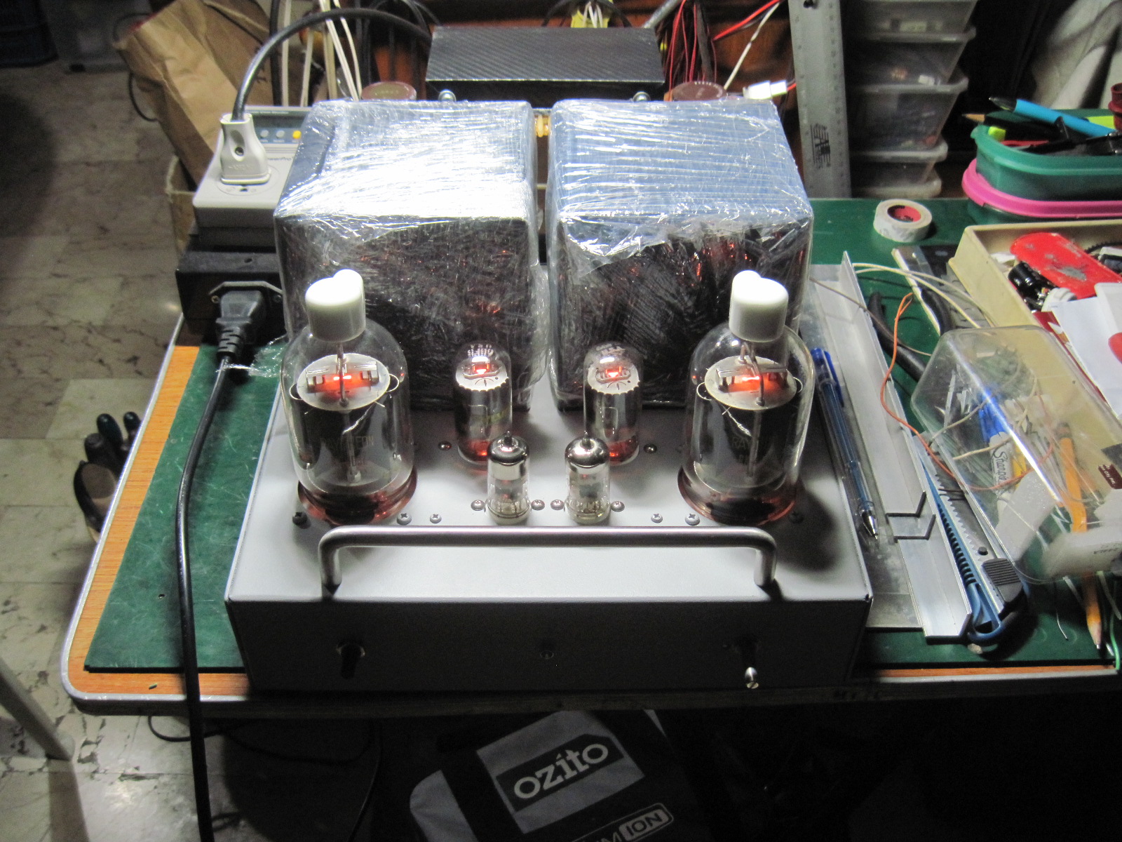

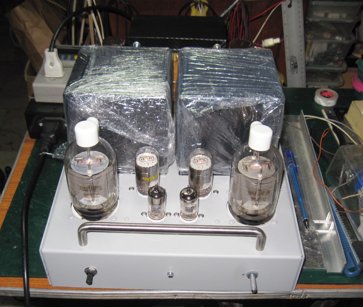

Hello everyone, I have not been playing with my crazy drive/twin drive amp lately as I have been running an AB2 triode amp I built with KT66 wired as triodes for the output stage. Since everyone was talking about idle currents and twin drive I thought I would quickly connect my twin drive up and see where I left it with regards to idle current. The amplifier still sounds very good to me and it is idling at 8ma per 6DQ5 output tube. Just for the fun of it I hooked up my 475 scope and looked at the cross over distortion and really could not see one. I then cranked the bias down to 4ma per tube and could see some onset of cross over distortion. As fall turns to winter here in Oregon, I will probably play some more with the amplifier during the months to come. I would encourage others to play with twin drive and share their results. I spent next to nothing building this amplifier as I had more than 90% of the parts needed in my collection. Its been fun playing with something different. I thank Smoking Amp for the inspiration to play with this output stage driving scheme as his graphs of crazy drive performance of sweep tubes were just too irresistible! I would also like for people to know that since my old original schematic was posted, I did change the bias adjusting scheme to achieve the ability to turn the current down lower in the output stage. Thus, the original schematic is out of date. Mickeystan
Thanks greatly, Mickeystan!
I think we can all settle for just 8 mA of idle current. This is way below the usual class AB g1 pentode idle current. I think we can all feel relieved that crossover can be handled well with the new scheme.
Do you see any hint of gm doubling above the 8 mA, maybe at 16 to 20 mA or so? Or, to put it differently, does any new squiggle in the crossover appear somewhere above the 8 mA level.
Smoking Amp, I took a quick look earlier today at the crossover performance at 4 ma, 8 ma and 17 ma of cathode current on the 6DQ5 output tubes. The only setting I saw any squiggle (distortion to the crossover region) was at 4 ma. Since the amplifier is still up on the bench, I will take a closer look and measure the actual distortion 1 khz and 1 watt of output at all three levels and share the results. More to come..... Mickeystan
Ray, I will be happy to re-post the schematic. Before I do, I want to check it out again against the amplifier since I know I have changed the bias scheme. Tomorrow, I will take a better look at several bias levels while measuring the distortion levels. As I do this, I will take the time to recheck the schematic and update it as necessary before I put it up to share. Mickeystan
Hello everyone, This message is a follow up I promised to do with regards to my Crazy/Twin drive 6DQ5 sweep tube amplifier. Today, I took a closer look at the output waveform into a non reactive 8 ohm resistance load, at various output stage idle currents while measuring distortion today. I did this using a Wavetek 182a generator and a HP 334 distortion analyzer. The as built amplifier schematic is also attached. The results I obtained are listed below, (all were taken at 1 watt rms output at 1khz);
5 ma cathode idle current per output tube 0.44% distortion
8 ma cathode idle current per output tube 0.40% distortion
12 ma cathode idle current per output tube 0.21% distortion
20 ma cathode idle current per output tube 0.16% distortion
24 ma cathode idle current per output tube 0.23% distortion
28 ma cathode idle current per output tube 0.30% distortion
In my earlier post the other day, I thought I could see a slight deformation in the cross over distortion at 4 ma idle current. After taking a closer look, I truly cannot say I see any form of crossover distortion. It seems that 20 ma of idle current is what the amplifier wants and it will make 50 vpp output when cranked up without any significant distortion to the sine wave output. Thus, it will deliver approx. 40 watts rms into a 8 ohm load.
I have listened to the amplifier at various idle current levels and have not noted it sounding any different at any of them. This amplifier sounds very good to me and I am pleased with it. I do not attempt to describe in detail how wonderful a amplifier sounds. Unlike most people, I use a preamp ahead of all my amplifiers to boost the high frequencies as my hearing is significantly damaged above 4 khz. I hope this feedback is useful to folks. Mickeystan
