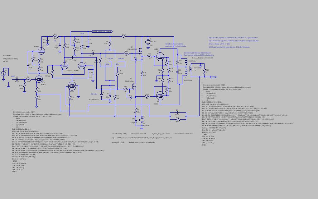

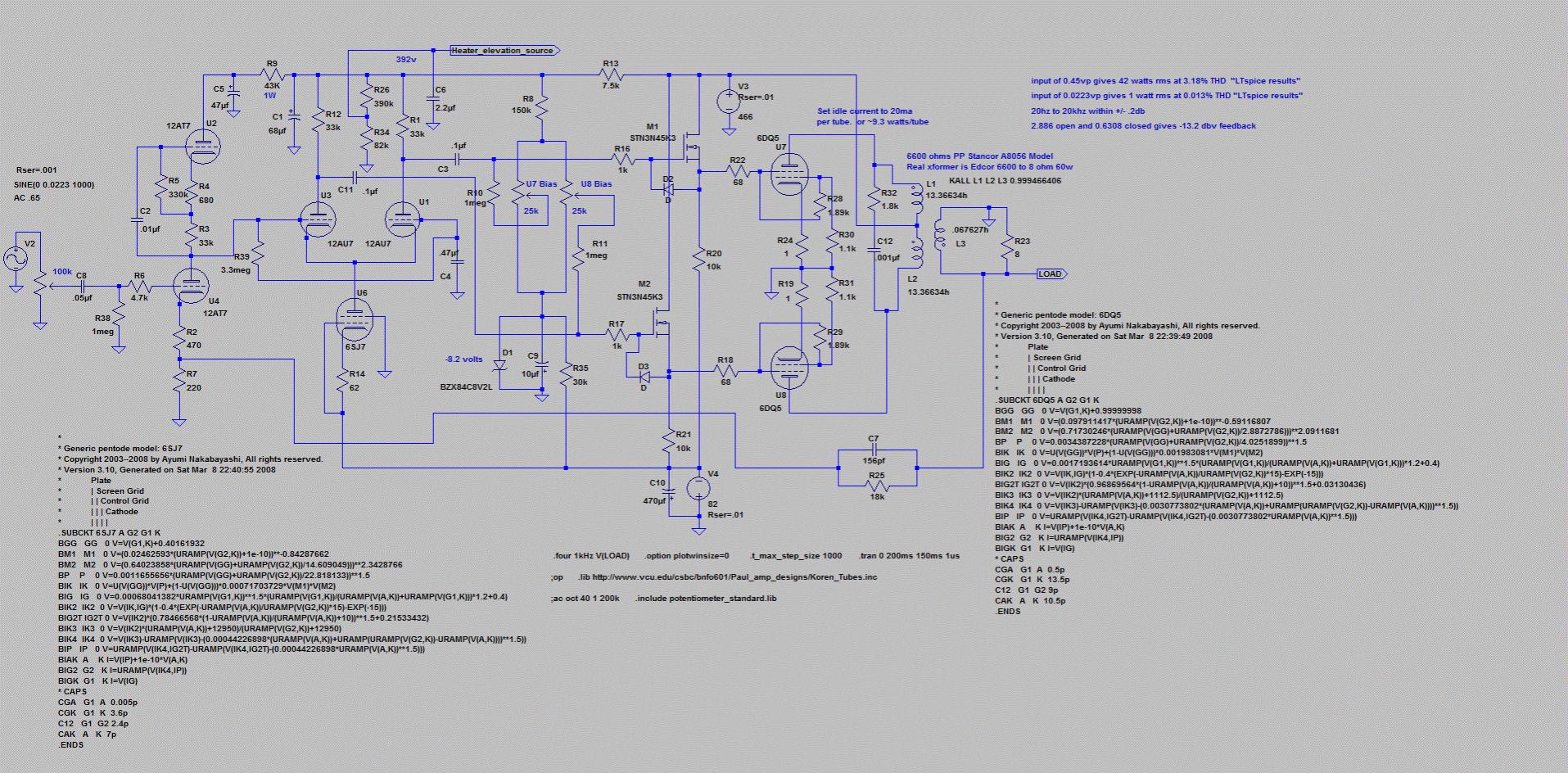

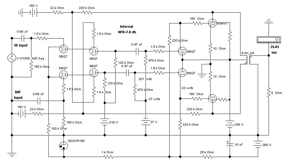

It's an LTSpice file. Thanks Mickeystan.
Here is a link to the earlier schematic in .jpg form:
http://www.diyaudio.com/forums/tube...nificent-television-tubes-67.html#post4675905
and attached below is the new schematic in .jpg form:
With the higher idle current now, I wonder if this is a characteristic of the 6DQ5 or of Crazy/Twin Drive.
It would be interesting to remove the Rg2g1 resistors and see where the g2 only drive is optimally biased.
(Or just put clip leads across the Rg1k resistors. No de-soldering needed then.)

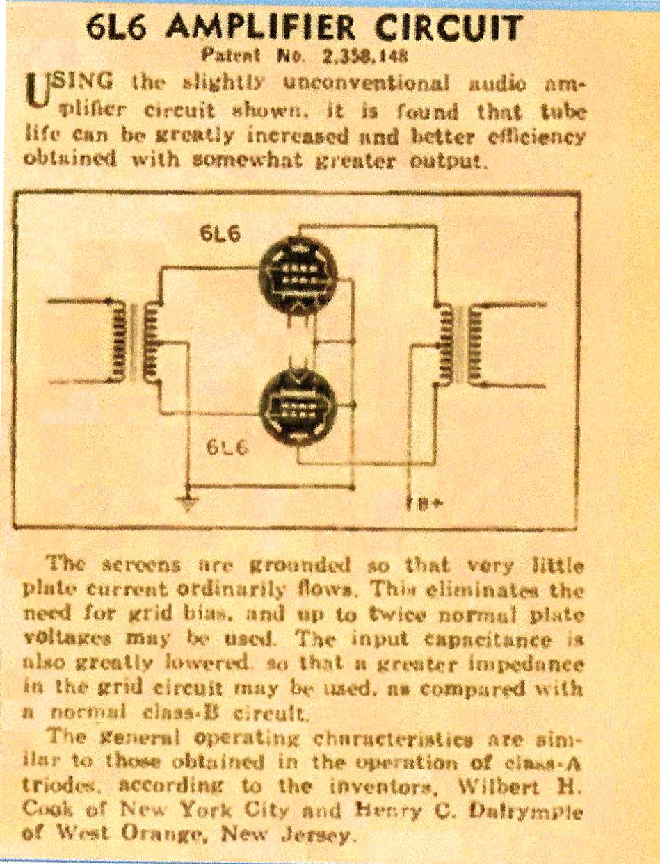

THX for the cct schema. For the curious & others here is the original patent on the screen drive pentode copied from an old copy of one of the magazines popular in the day. Would be around 1955 I think. A bit fuzzy, but readable.

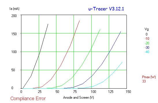

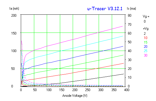

All pics are 20 mA/div Vert., 50V/div Horiz. (yeah, these are all well over the max. plate dissipation for these little sweeps, but they can take it.) (the -g1 drive comparison pics might be 50 mA/div Vert., I don't have the data from these older pics.)
1) 12BQ6GA (old style) g2 drive, 95V max g2, 7V steps
2) 12BQ6GA (old style) special drive, 50V max g2, 3.5V steps
3) 12BQ6GA (new style) g2 drive, 82V max g2, 7V steps
4) 12BQ6GA (new style) special drive, 45V max g2, 3.5V steps
5) 12BQ6GA (old or new style? was an old pic) conventional -g1 drive (for comparison)
6) 12GE5 g2 drive, 84V max g2, 7V steps
7) 12GE5 special drive, 35V max g2, 3.5V steps
8) 12GE5 conventional -g1 drive (for comparison)

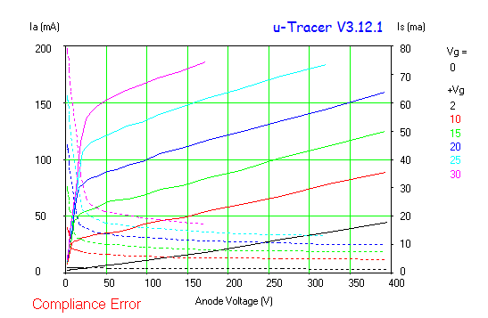

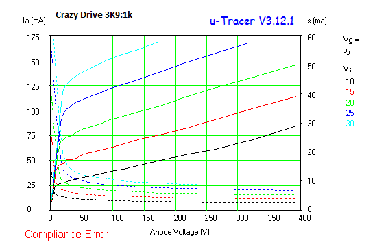

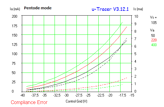

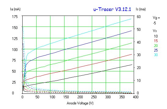

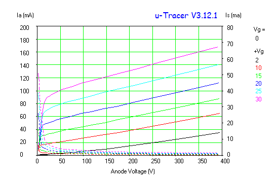

Some tracer results...

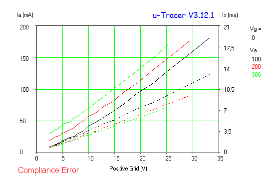

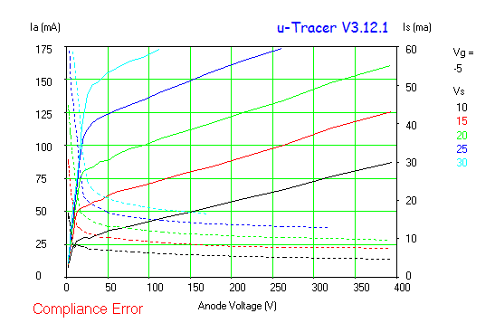

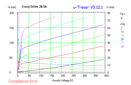

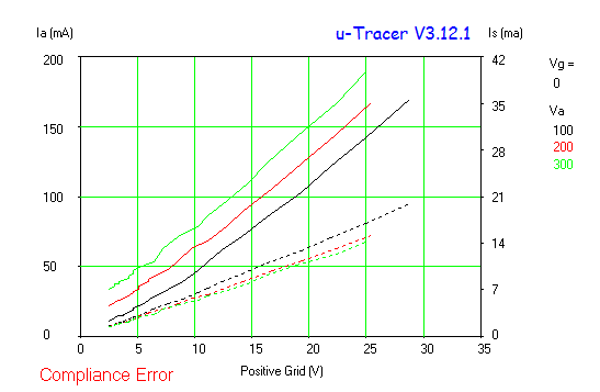

Here is some testings I made, using G2 only, Crazy Drive with 3k9:1k resistors, Crazy Drive with 2k:1k resistors and triode mode
OOPS.: I forget to include infos; the attachments don't show the archive name (the explanation of connections are in archive's names)
Soon I publish with the additional infos

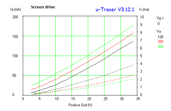

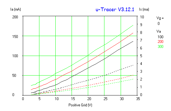

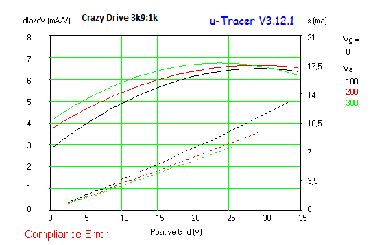

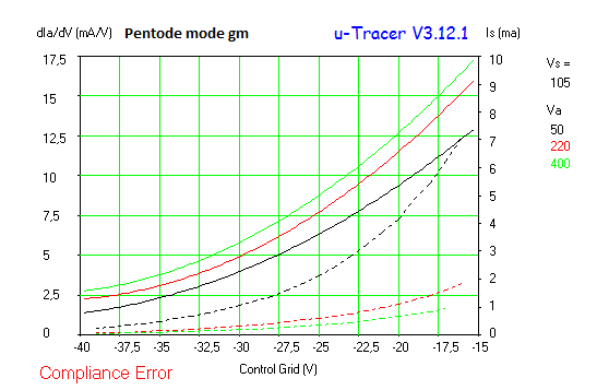

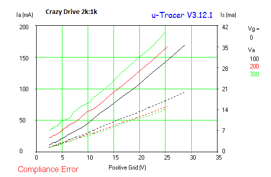

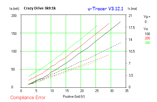

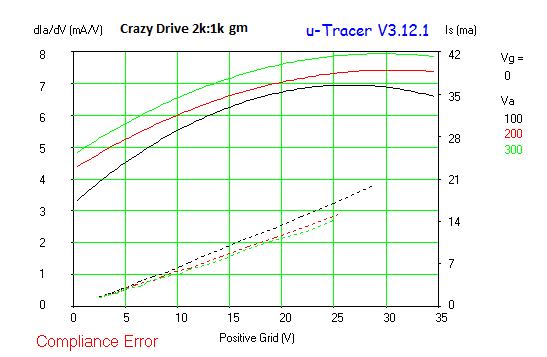

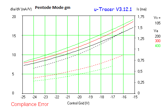

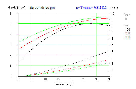

Now with explanations ...
...and better organized
Some conclusions from this...
Yes, a considerable less voltage drive for Crazy Drive, but this also confirm the necessity to use a negative supply, unless one can copy the JVC and Super-A idea (a biasing scheme to "lock" the minimum current in bipolar output transistors, to avoid the resulting minority carrier delay provoked by cut-off). Of course, the "residual" current in PL509 G2-derived drive is too high at Vg2=0V and Vg1=0V with elevated anode voltage (aka the place where the tube must be at cut-off) and will be deleterious to distortion, I presume.
Other thing, is notable the low rp from tubes like PL509. I don't calculated it yet but the "quick test" from µTracer revealed something like 6k. In triode mode this tube eat 6AS7 for breakfast in rp region.
PS.: the measured G2 current is higher for Crazy drive than from G2 only, due to additional resistive current divider. At low anode currents, the G2 sinking current is higher than the resistors drained current
Interesting. The configuration I use on the tracer here is a floating power supply in series with the stepped grid voltage from the tracer. I don't have any easy way to tell when I am hitting exactly zero volt sum for the two in series, since there is a continuously variable offset knob on the tracer. So I may be driving the screen grid slightly negative to get the 0 current plate trace (or point below).

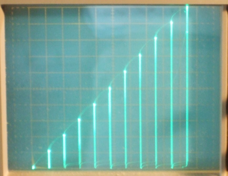

6HJ5 has a 5K nominal (datasheet) Rp at 80 mA, and 26LX6 has a 6K nominal Rp at 125 mA. Both working good in Twin drive.
We may not have the divider resistors sufficiently optimised yet to straighten out the plate current or (flatten the) gm curve(s) for the PL509. I think I will order a 40KG6 to try out here. You might try some pots for the divider there to see if it improves further.

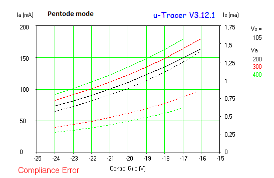

I ran a plate current versus input grid2 voltage step scan (in Twin mode) for 26LX6, shown below. It looks darn close to a straight ramp if you put a ruler up against it. 50 mA/div Vert. and close to 5.4 V steps horiz. I don't have a gm test unfortunately. I tried a 6HJ5 in the same setup and got a nice straight current ramp too. (the ramp shrinks down and curves over if I turn the heater power off to the tube. )
