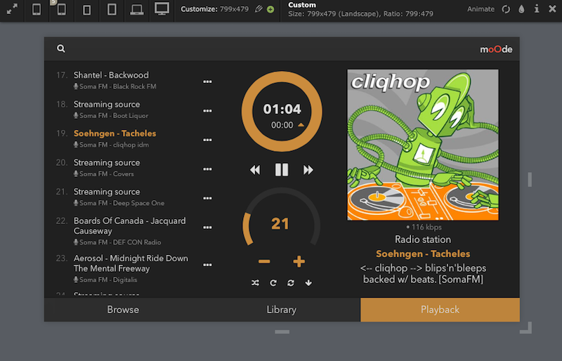

maybe you could have a look at another issue with the localui ?
Sometimes when playing Radio the right scrollbar appears.
Then the ui resizes little smaller and the the scrollbar dissappears.
The ui resizes to litte larger and the scrollbar reappears...
and so on.
Michael
Hi Michael,
Enable overlay scrollbars.
The config is in the Build Recipe. See step 4, component 8 Local UI display
-Tim

and this doesn't happen everytime, but often when i swap between radioparadise and the jazz groove.
And sometimes after some minutes it's gone.
I think it is the 'overflow: auto' property being set unnecessarily on some divs.
I’m just guessing because I’ve never seen this but it sounds like what is happening is that as the artist, song, etc. changes the available area to show the track info is occasionally exceeded and it shows a scrollbar so the user can scroll to see the additional content. The smaller the screen the more likely it would be to happen. Even if we made the font much smaller there’s no guarantee it wouldn’t happen under the right circumstances and the fonts are already smaller than previous versions so that’d just create another set of posts.
I don’t think boxing the track info into a separate div you had to scroll if the bounds was exceeded is preferable.
So it comes down to 1) hide overflow so some of the track info would be lost, 2) keep letting the user scroll to see the content, or possibly 3) hide scrollbars (which we tested before because they’re ugly and not everyone runs a platform that auto-hides them, but there was some problem on the Pi version of Chromium so that might not be an option). It might be possible to hide just that specific one which iirc wasn’t where the Chromium bug was problematic, but it was a few months ago so I’d have to see how we did it.

I think its OK as-is at least on the 4.1 de-zoomed Pi Touch UI but overlay scrollbars need to be manually enabled in Chrome.
I just tested switching between Jazz Groove and Radio Paradise and the small, dark overlay slider appeared for a sec or two than disappeared. It appears long enough to grab it tho which is a necessity since momentum scrolling is not working on Pi Touch + Chrome :-(

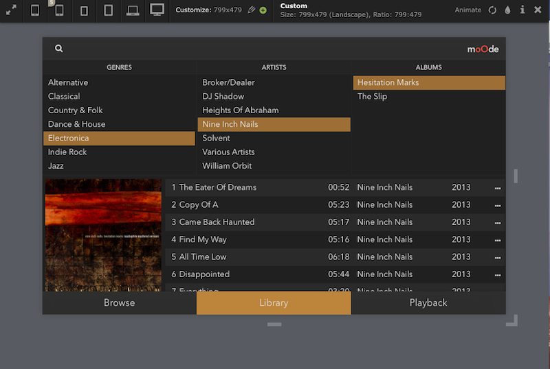

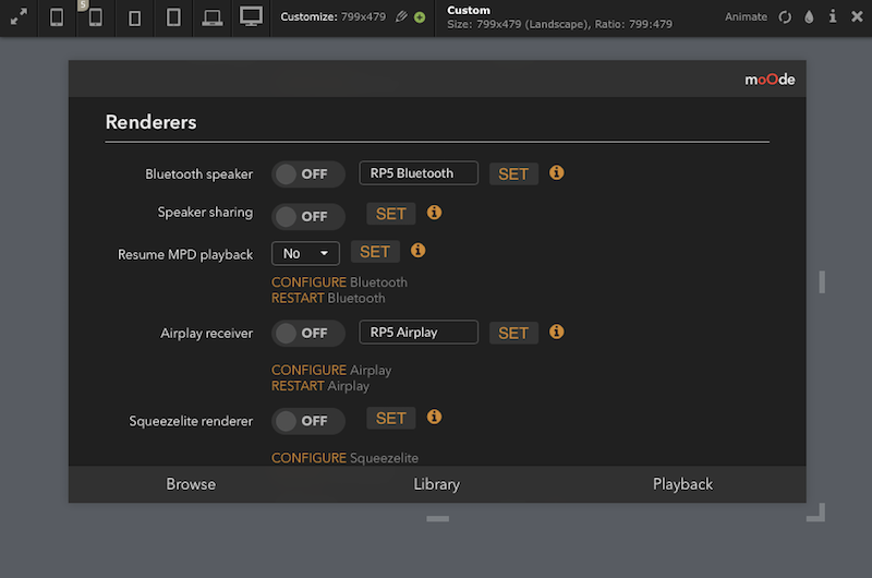

Here's some screen shots of the new 4.1 UI on Pi Touch :)
Audio config shows one of the nice new Bluetooth settings , "Resume MPD playback". Its part of a major enhancement to the Bluetooth feature including automatic display of the "Bluetooth" indicator in the time knob when client connects/disconnects.
Another nice enhancement is automatic Browser refresh after Customization settings are updated. No need for manual refresh!
Also, since the Raspberry Pi foundation just popped out the nice new Pi 3B+ and Stretch Linux I'm going to hold off releasing moOde 4.1 update until I can test out the new release of Stretch for the Builder.
4.0 --> 4.1 will be an in-place update.
New 4.1 Builds will be on top of new Stretch.
-Tim
