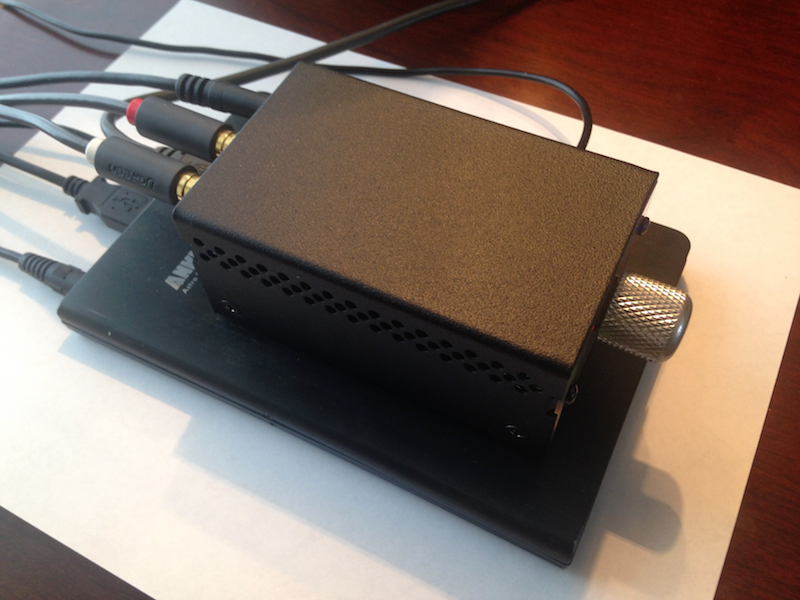

TY. OK so this one for instance. What I dont understand is how the power on/off is done. Assuming Tim has the battery plugged all the time, he needs a power board (or one for RPi and one for DAC). Is that the case? Sounds interesting enough to have a go.
Wow! Could you show me a pic of your rig? So that LiON battery is connected to a wall charger?
Yes, the battery is connected to wall charger and maintains 100% charged status while providing power to devices. The model I have is not being made anymore. It provided 3 x 5V out and 1 x 9/12V out. Anker | Astro Pro 20000mAh Portable Charger
I'd suggest carefully researching these battery packs and make sure that a particular model can be continuously charged while at the same time providing power to devices. I think this is called "pass-thru charging". Also I read that some packs automatically shut down their power ports when they "sense" that the device is fully charged.
The top of the pic shows 5V in at the back for the Reclocker and 5V in at the side for Pi.
-Tim
