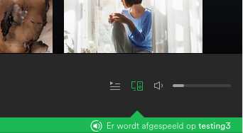

Hi @pinkdot,
Thats cool. Can you try with
--device hw:1,0
--initial-volume 20
-Tim
  • Initial volume works good, see screenshot.
  • hw:1,0 doesn't work for me.
