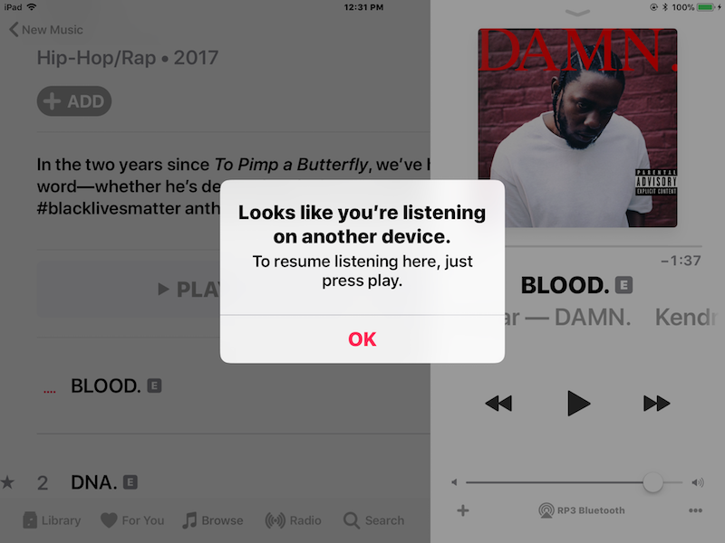

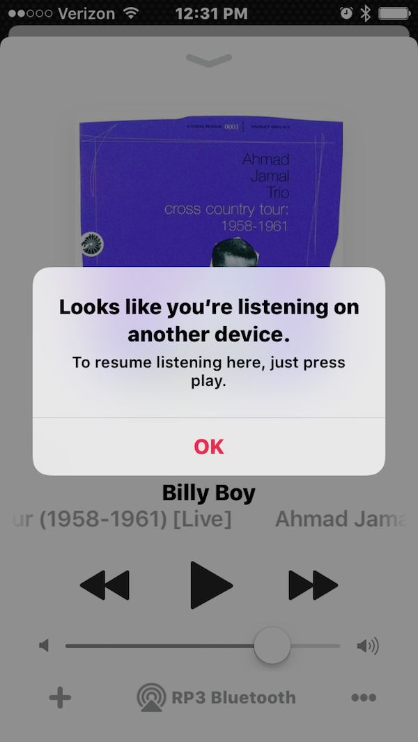

As far as Bluetooth Speaker Sharing goes, I only test this using the IOS devices that I have and it works really well. After connecting both devices to Moode Bluetooth, either device can play a BT stream. The other device pops up a notification indicating that its stream has stopped and can be resumed by simply pressing Play.
I don't know how BT speaker sharing works on non IOS devices or whether they even support this capability.
-Tim
I have only Android devices here, a completely different ecosystem than iOS. Just now two of them are paired and connected with moOde. One is a Nexus 6P phone running Android 8.1.0 on a stock ROM and the other a Nexus 7 tablet running Android 6.0.1 on a third-party ROM.
I can stream to moOde via BT with either device or with both together (which leads to interesting mashups---BBC World Service overlaid with jazz, for example). Based on this experience I'd say most recent Android versions should work fine.
I'm not sure how "[T]he other device pops up a notification indicating that its stream has stopped and can be resumed by simply pressing Play" works in iOS but I haven't found a feature like it in Android. The apps on the devices run independently---playing and pausing/stopping as I command. YMMV.
Kent
Kent
