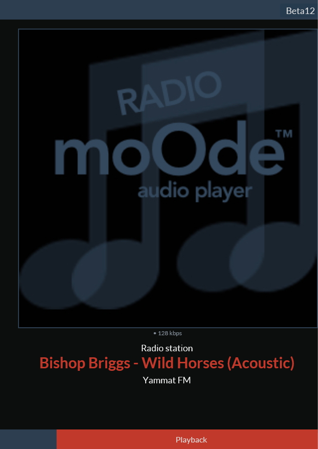

after unsquashing it, I could upload new radio station logos. But for some reason after I switch back to radio station doesn't display it.
For example, I put the logo file Yammat FM.png to /var/www/images/radio-logos/ directory and Yammat FM.pls already presented in /var/lib/mpd/music/RADIO/.

Maybe you must edit a row in the database for this entry ... but this is not so easy if you are not familiar with this.
I guess the field logo in the table cfg_radio must be completed with a string "local" or something like that (but be careful with any change in the database ;))
