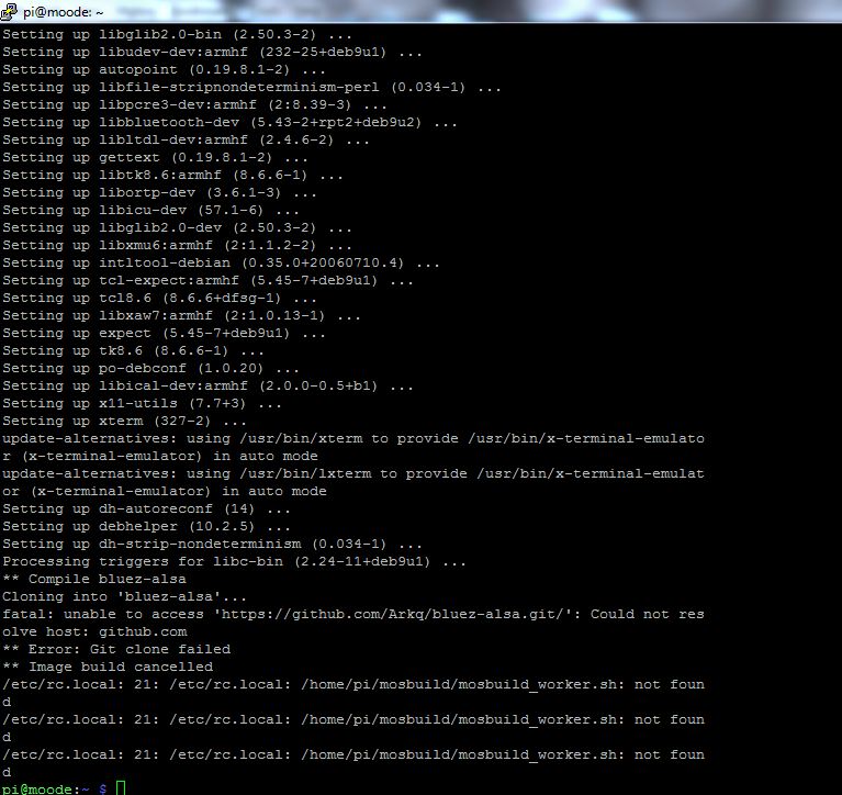

I am also facing exact same problem now.
What I did so far:-
Step 1: downloaded raspbian lite from raspberry pi. and ensured its running on my rpi3.
Step2: connected rpi running raspbian through lan to my router and started.
Step3: connected to rpi using putty (ssh) and entered the command mentioned in moodeaudio.org support page.
Step4: it asked couple of questions with y/n. Answered every thing as per Tim's note. There was one additional question "connect to wifi instead of lan" I answered 'no' to it.
Step 5: in between those questions in step 4 it asked me to insert SD card through USB card reader which I did.
Step 6: it said image build was successful (something like that) and asked me I want to save base os for future images. I answered with 'yes'.
Step7: took out SD card on usb card reader and inserted into SD card slot of rpi( after removing the card which was there earlier).
Step 8: powered up rpi3 (connect to router through lan) and did not touch it for next 35 minutes.
Step 9: turned off and and on rpi and waited for 5 minutes ( my volumio takes 2 to 3 minutes load, hence this waiting)
Step 10: identified ip address of moode through my router's user interface (it was written 'moode' now- earlier it was raspberry pi)
Step 11: tried accessing mood gui through web browser using ip address identified in step 10 and Failed, tried using my android phone browser (Chrome) - failed, tried moode. local- failed.
Step 12: connected to monitor using Hdmi cable after disconnecting it from Lan. I could see raspbian booting and at the end with error message "
Failed to start /etc/rc-local Compatibility.
See ‘systemctl status rc-local.service’ for details.
Any help would be appreciated.
Regards
Goutham
Step 13: connected using ssh and ran cat */Mos build.log(thought of experimenting) - this time connected to internet via lan. It gave error at the end (please see the attached image)
