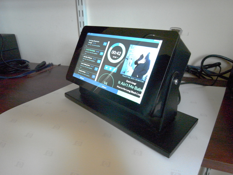

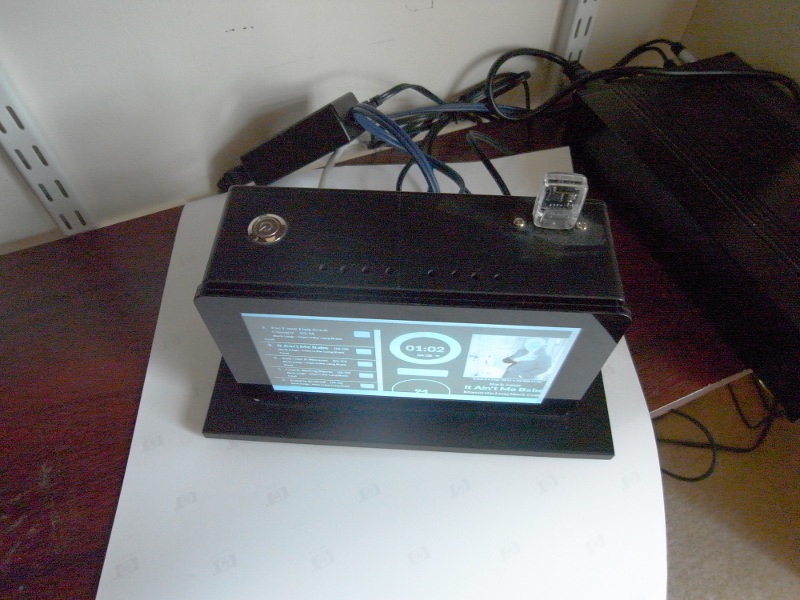

Beta 12 on Pi official display in swivel case.
Some thoughts on using MoodeAUDIO Beta 12 with Pi Official Display. Pictures attached.
I put the SDcard I created using Moode beta 12 into my normal streaming player, which is a LMS server, squeezelite, Jivelite based system. I did the necessary reconfigure and it works OK! The Dac in this system, is a Hifiberry pro Plus, with internal USB storage.
My system uses a Pi official display in a swivel mounted display I built. The Pi display has a cr*p viewing angle and the swivel allows me to view it at 90 degs without stooping or getting down on my knees.
The case is a Hammond one, just the right size! I have a FLIR and an Pi ATX power switch. I have a genuine Squeezebox IR remote, and can control the Squeezelite/Jivelite system with either touch, IR remote or over the web!
My first impression of Moode Audio using the touch screen is that it is not as good as using Jivelite, it is a lot slower, and the web pages do not "fit" the screen as well as the Jivelite system.
I have not yet added the config file for the ATX power control system and for the FLIR IR remote device.
If I can achieve the same user ability with Moode audio I will go for it, however at my advanced years I cannot get much improvement in the SQ using Moode audio over Squeezelite
The usability is very important to me. If I am listening to music and the phone rings or my better half wants to talk, I can pick up the remote and pause play quickly and easily, a lot quicker than any other way!
YMMV
regards
PAtrick

Hi Patrick,
There are a few Chrome Browser configs that enable the UI to fit on the 16:10 A/R screen. I was not able to find a way to automatically make the configs in the Recipe or Builder. See step 4 below from the Build Recipe.
-Tim
