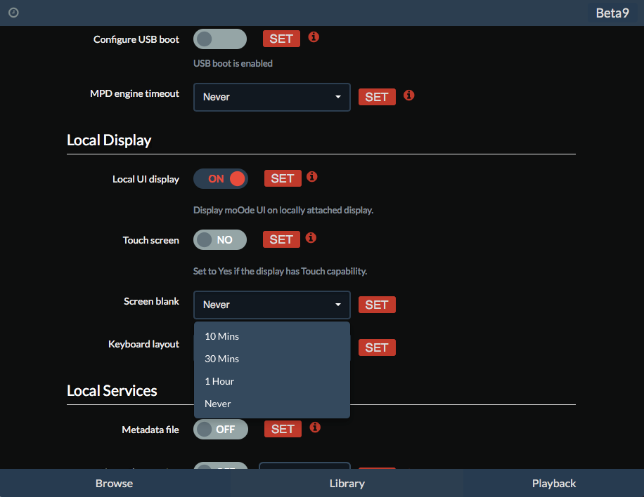

That would be great.
Local touch screen would be great! It would allow Moode to be used in a mobile environment.

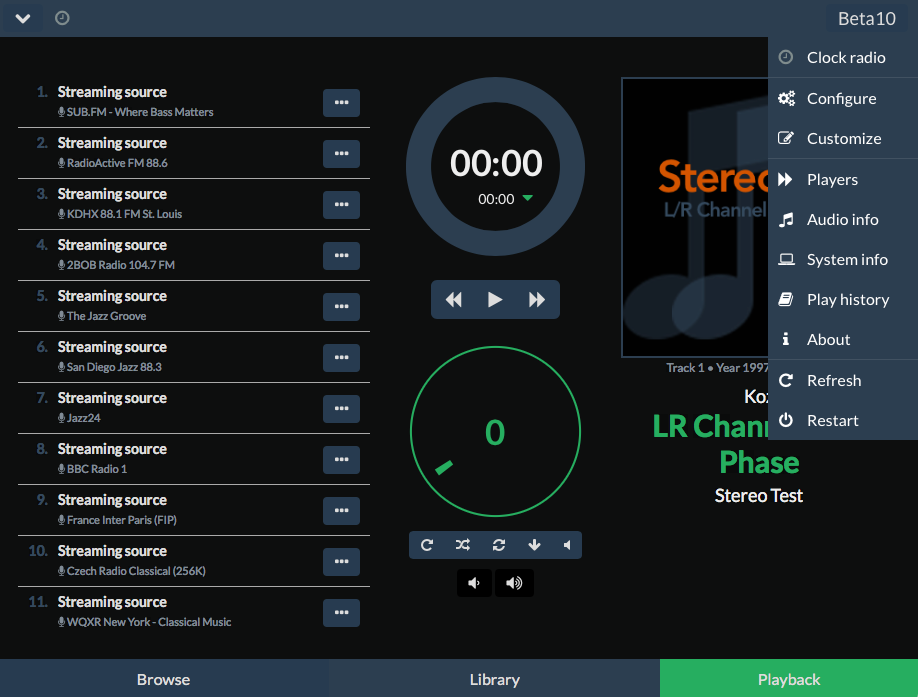

Hi Gary,
Screen shot of the new feature, already implemented
-Tim
Not disagreeing with the addition of screen function, but you can use Moode mobile: just let it create an AP and control it with your mobile phone or tablet.
Thanks for the suggestion! I played around with AP a little bit. It seems the screen on my phone is a little small and hard to navigate for mobile use. My thought was the 7" Pi touch screen would be a little easier.

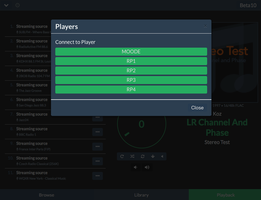

Some screen shots of the new "Players" feature
I'm using avahi to discover other moOde players on the network and then getting each players ip address to form the connecting url.
This should make it easy to connect to other moOde players when using Smartphone, Tablet and locally attached screen.
-Tim
