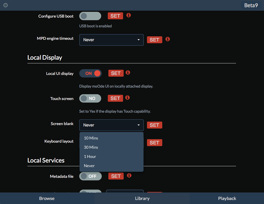

moOde 4 has a nice new feature that enables its UI to be displayed on a locally attached display :)
BIG thanks to @Morias !
-Tim
-Tim
Excellent ! Thanks Tim.
Liking the ui experimental screens on the MoOde twitter feed too.
Tim, another tweak to the new local display would be to add a turn off display option on the screen where you can choose to reboot or turn off the display. That way a person could leave their display on all the time but manually turn it off if required.
I think this is more a feature for a touchscreen where the display would come back on again if touched.
